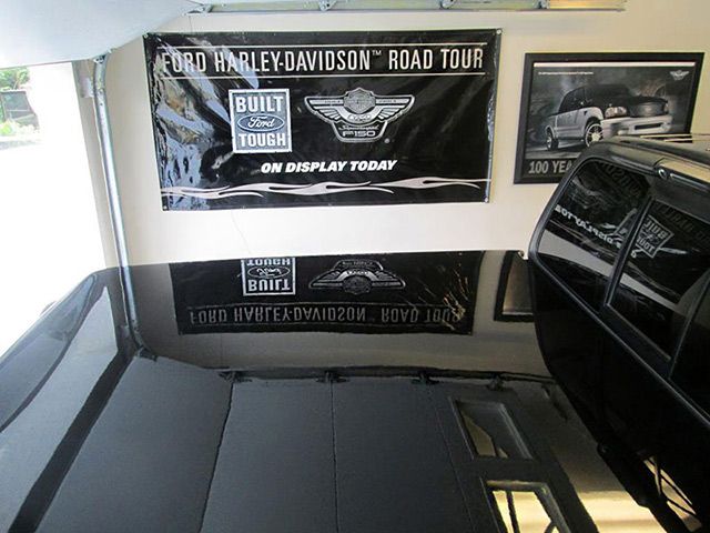

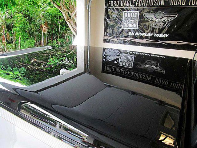

Minimal correction & gloss enhancement. Coated with CQuartz Finest.
2003 F150 Two-Tone H-D with minimal correction & gloss enhancement.
Minimal correction with minor swirls and fine scratches OCD corrected.
This beautiful truck is on Grand Cayman and it was a pleasure to detail.
Wash: Two-Bucket method wash with grit guards and a wool mitt.
Decon: Nanoskin AUTOSCRUB Speedy Prep Sponge Fine w/ONR lube.
Paint correction: Rupes 21 w/Megs M101 & Megs 5" microfiber discs,
Gloss Enhancement: Griots 6" DA with M205 w/LC white 5" flat pads,
followed with GG 6" & Menzerna PO85RD on Lake Country black 5" flat.
Engine: Cleaned w/Mothers billet Polish & Megs Plastic & Vinyl Coating.
Coating Prep: CarPro Eraser wipe-down on all polished paint surfaces.
Coating: CQuartz Finest applied on all paint with 24-48 hour cure time.
Post-CQuartz Finest: Reload spray sealant supplied to clean & revitalize.

I was surprised to find that even good quality microfiber towels were causing fine scratches in this paint.
It was necessary to use a very high quality borderless microfiber towels to remove the polish for inspection.
