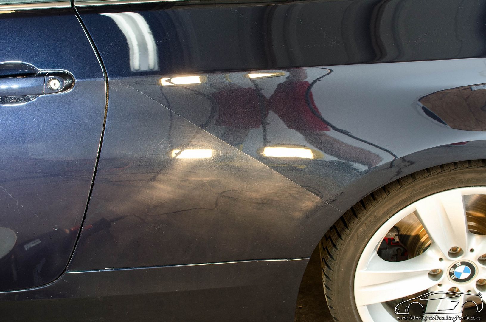

50/50 on rear quarter with halogens.
50/50 on rear quarter with LEDs. You can easily see the holograms on this panel with these LED lights. This is damage from a previous detailer who was incapable of using a machine properly (which is obvious by the overall condition of the vehicle
