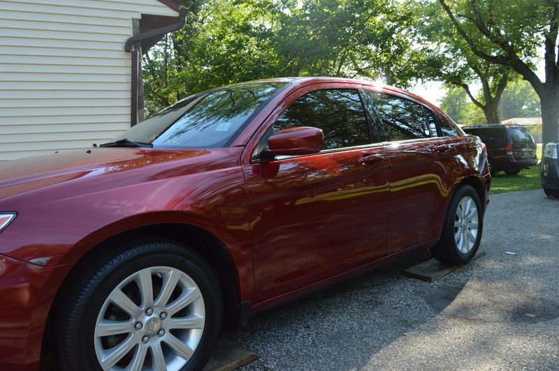

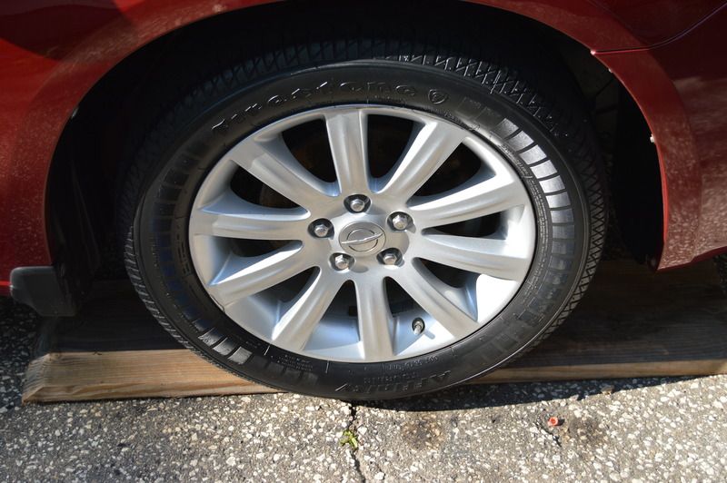

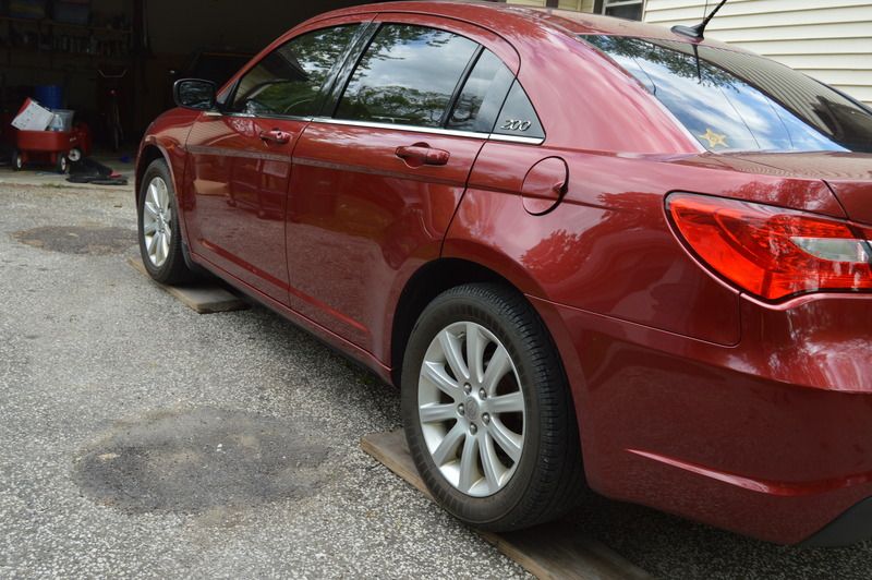

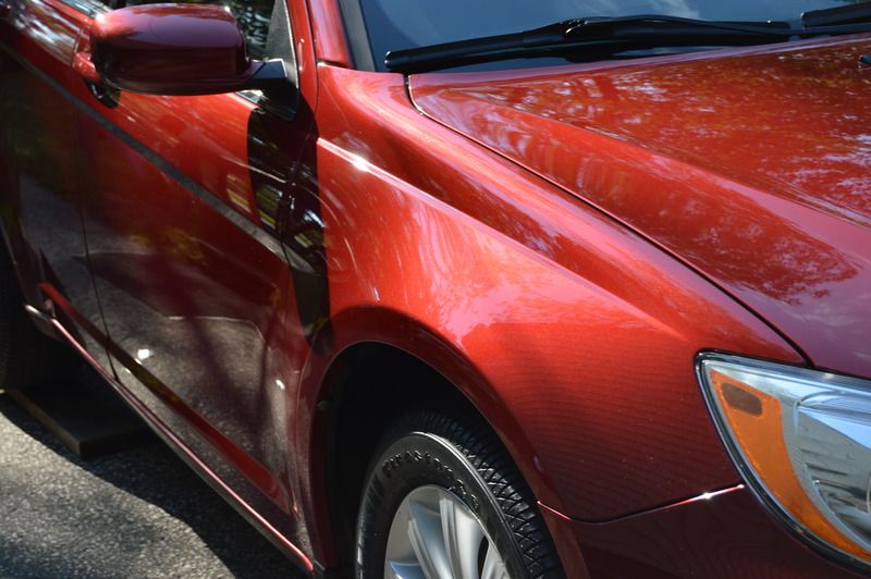

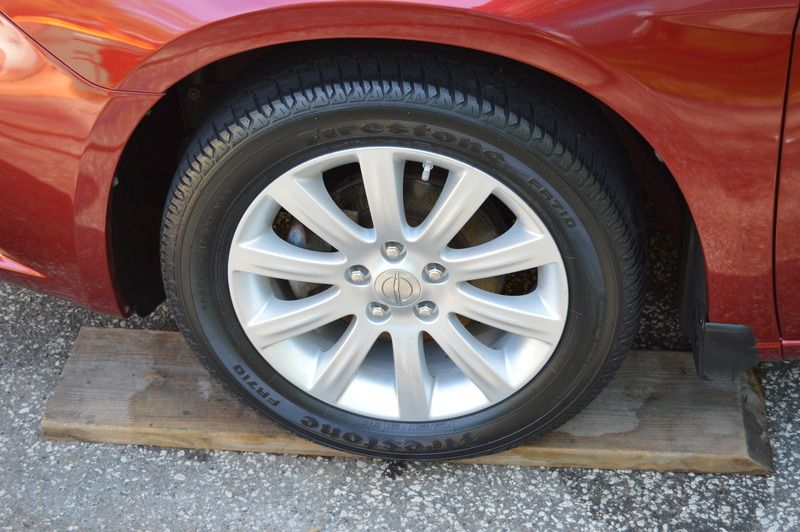

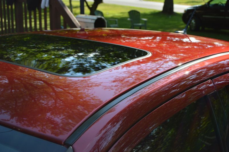

Chrysler 200 in for Americoat and a one step polish. Car was in pretty good shape for 100k on the odo and being a 2011. I had previously performed the same work on their Expedition and scheduled this after their SUV was done. It was a full interior and exterior job. Grabbed a few before pictures, but they were at 5pm on a Friday in Ohio which means not much sun. My goal was to wash, decon and start with some correciton before the night came to a close. I finished up Saturday morning with the coating and let it bake in the sun during the afternoon. Since I ordered a PTG for OP removal on my 300 I decided to take some measurements before and after the coating was applied, and I must say I was shocked. Before we get to the PTG stuff, here is the before and after and process.
Wash was megs gold class, tires were cleaned with Tuff Shine twice and Zep 505, wells got 505 and wheels were first hit with acid to remove the bronze color, followed by Sonax FE to remove iron deposits. After the wash, ameririd and speedy prep in medium grade. Polish was a single step with Wolfgang TSR on a white hybrid. Tires picked up black pearl and the wells were sprayed with megs HD. Coating was applied after prepall, and coating was Americana Americoat, 2 coats.

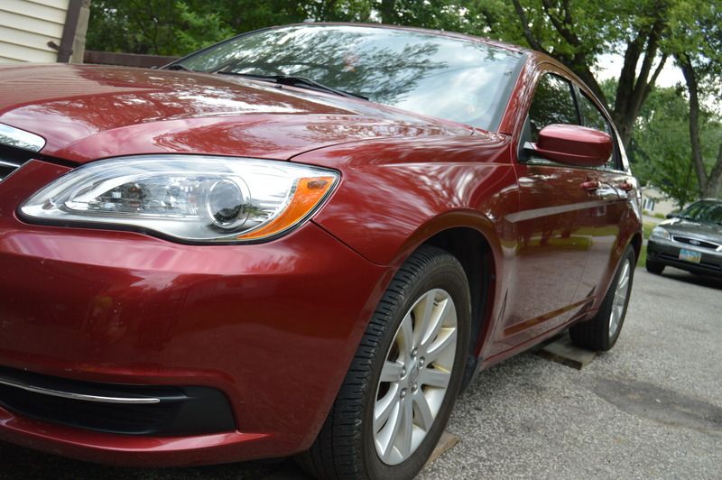

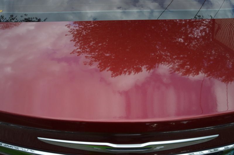

On drop off:

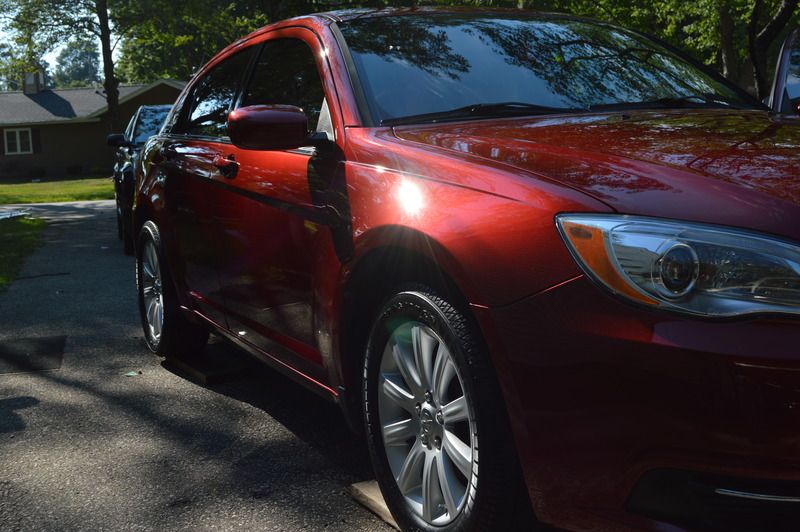

After polishing and coating, job is completed:
