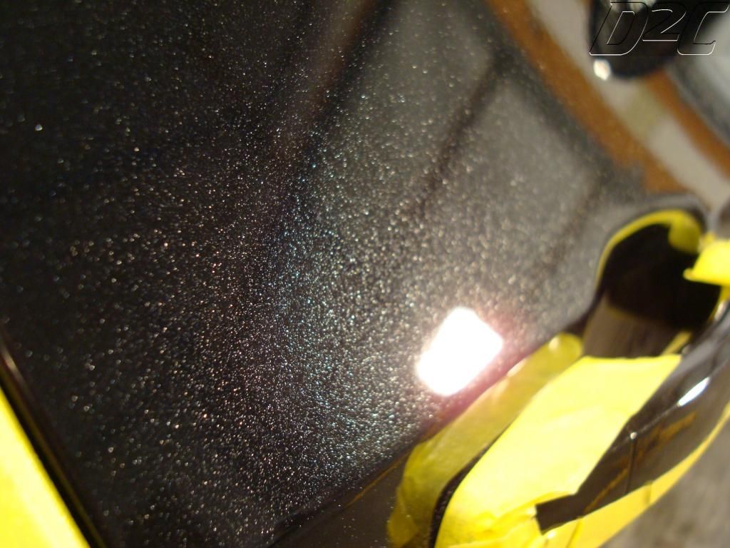

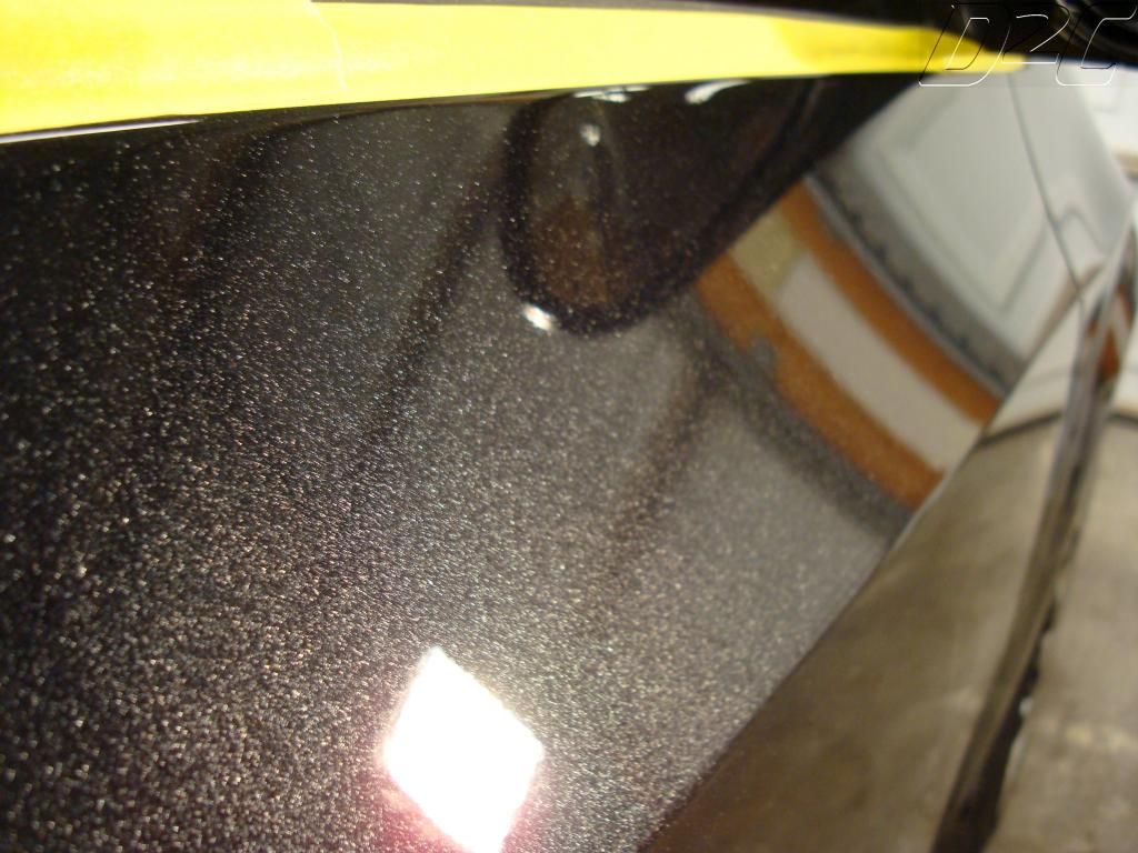

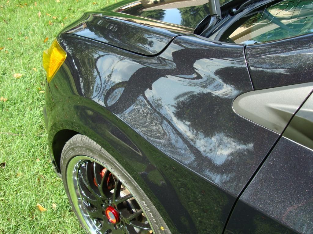

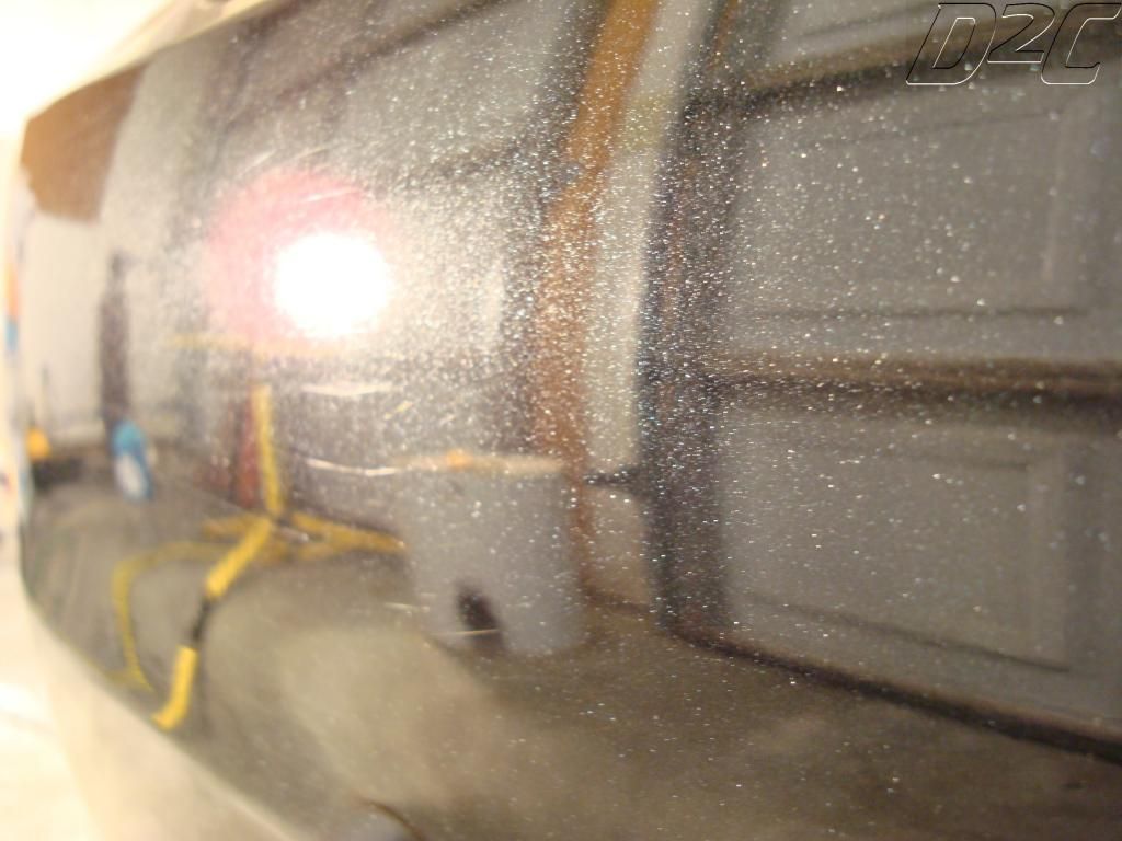

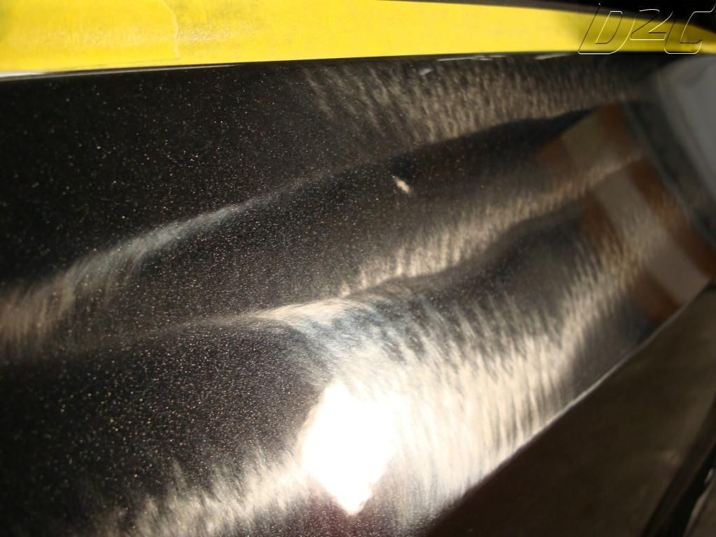

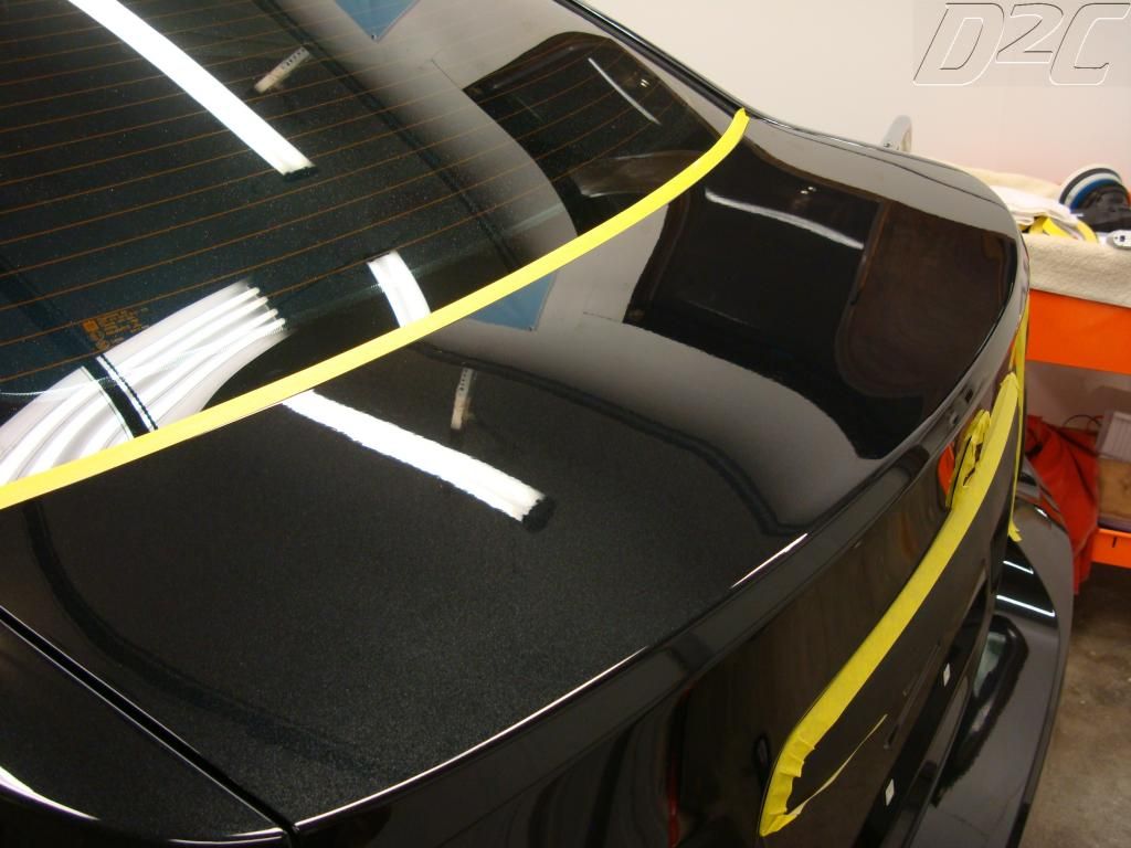

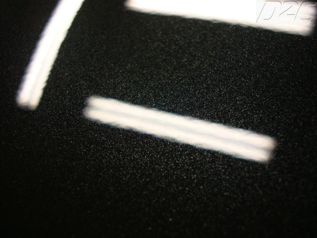

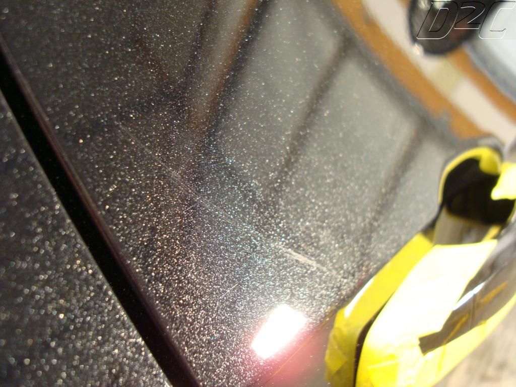

I just finished this up yesterday. Because the paint has so much metallic photographing when few defects it has was about impossible. I've said this before but, this is the HARDEST paint I've ever worked on. I one stepped it with Menz FG400 and a Scholl Concepts white spider pad. Spot correction was done w/ a 3inch CarPro hybrid wool/MF pad and Meg's M101

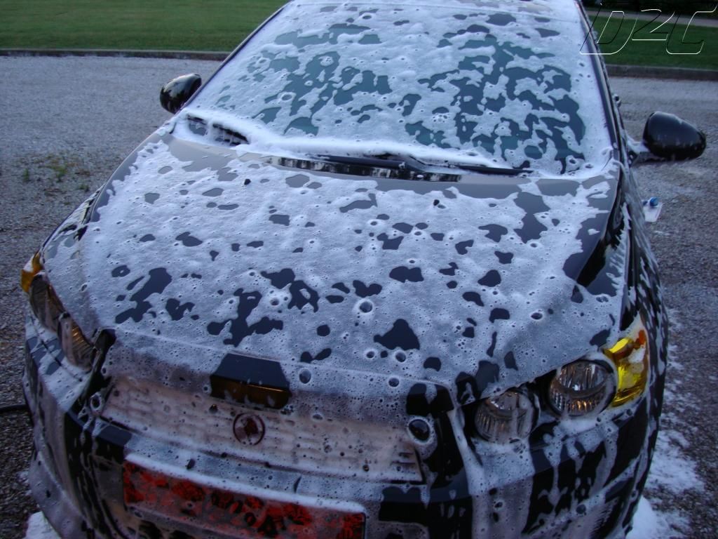

Car was washed w/ IXSS and Dawn to remove any LSP's. Decon'd w/ Iron X, Tar X, PolyShave towel and clay

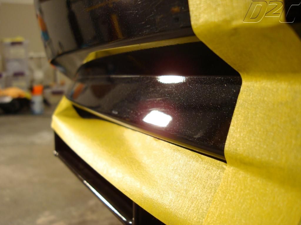

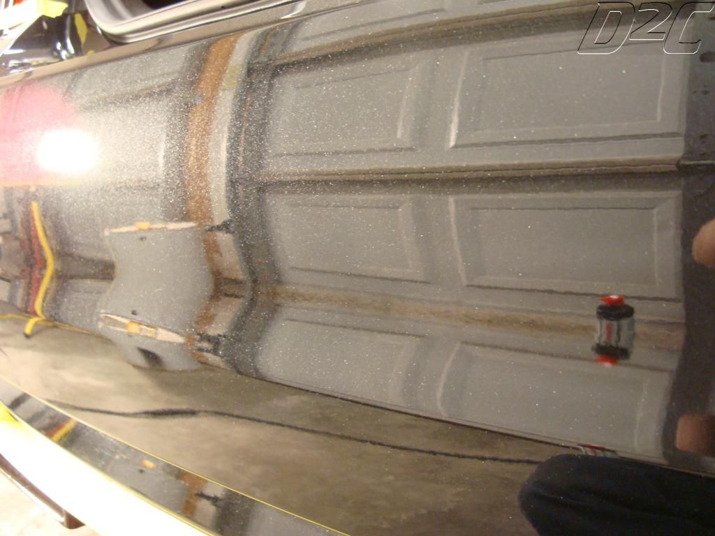

Because of the metallic in the paint photographing the defects was about impossible. The car had light swirls and quite a few RIDS.

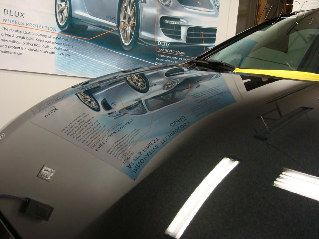

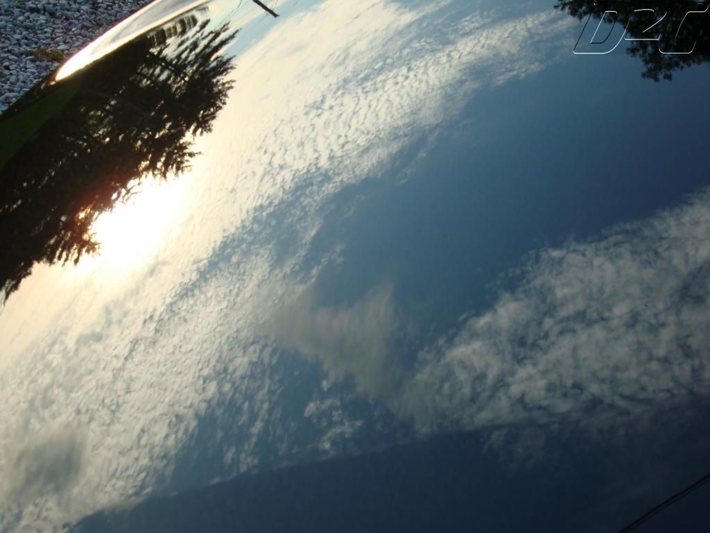

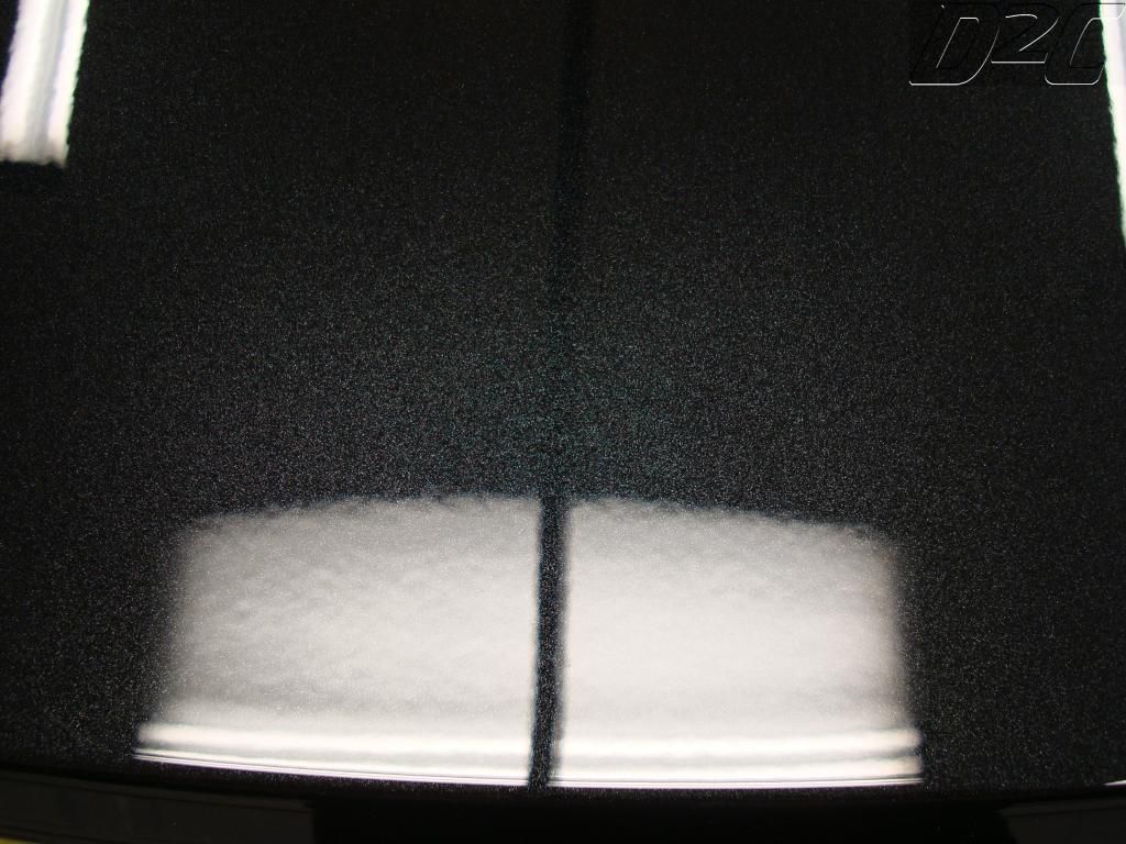

After correction/before Finest

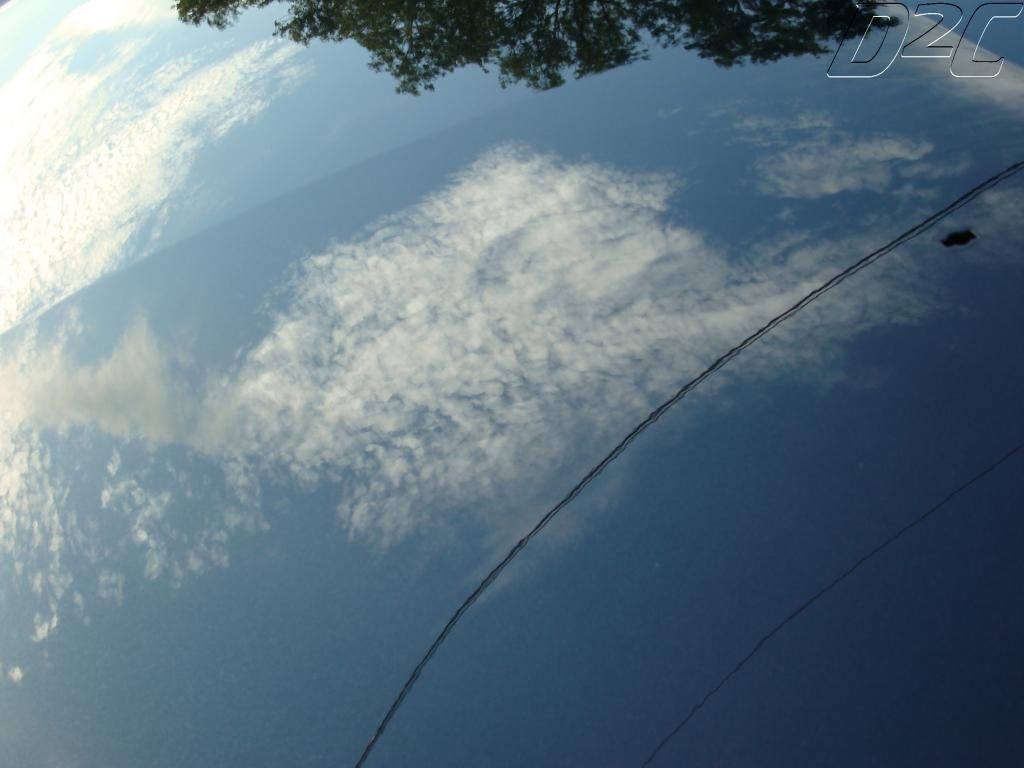

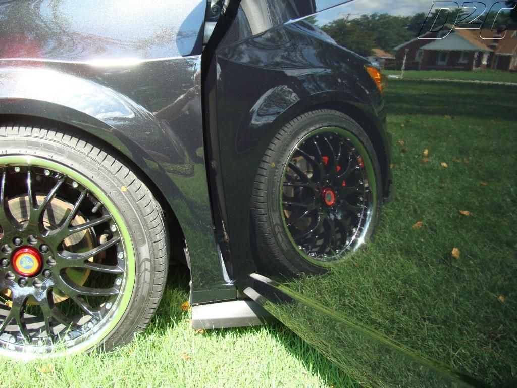

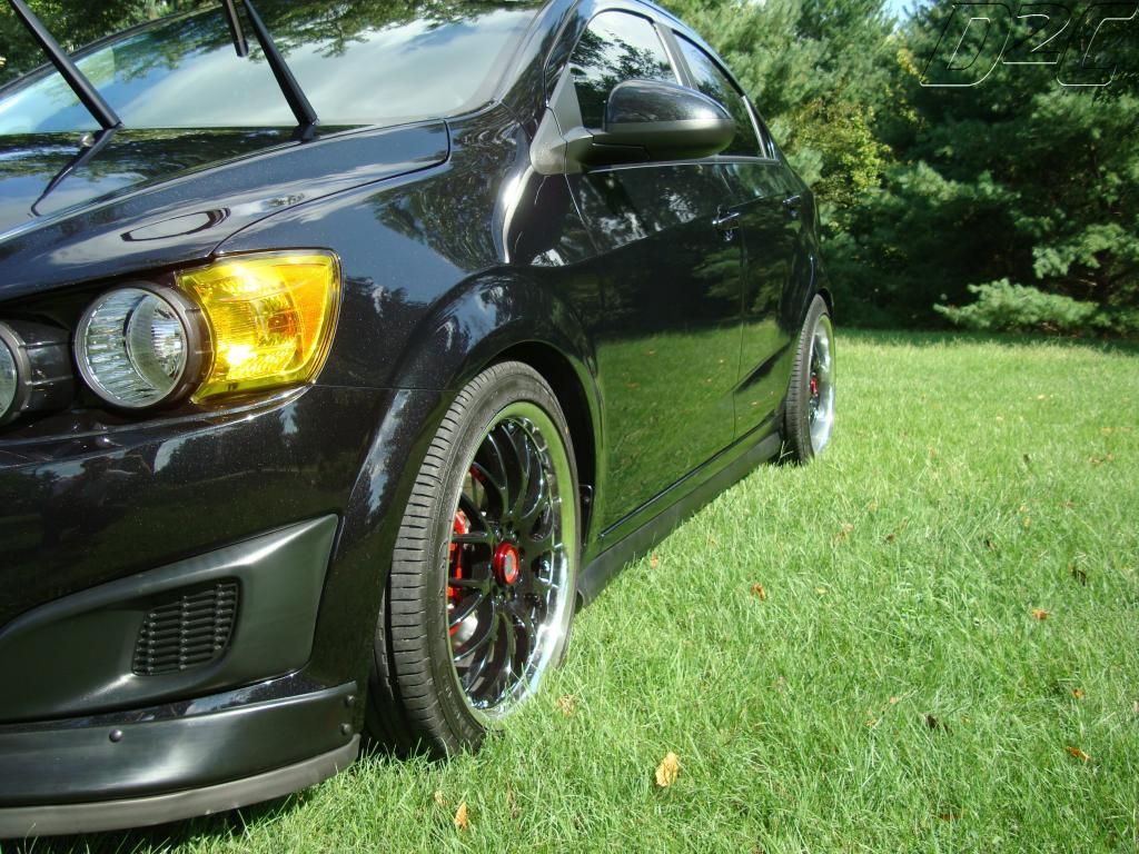

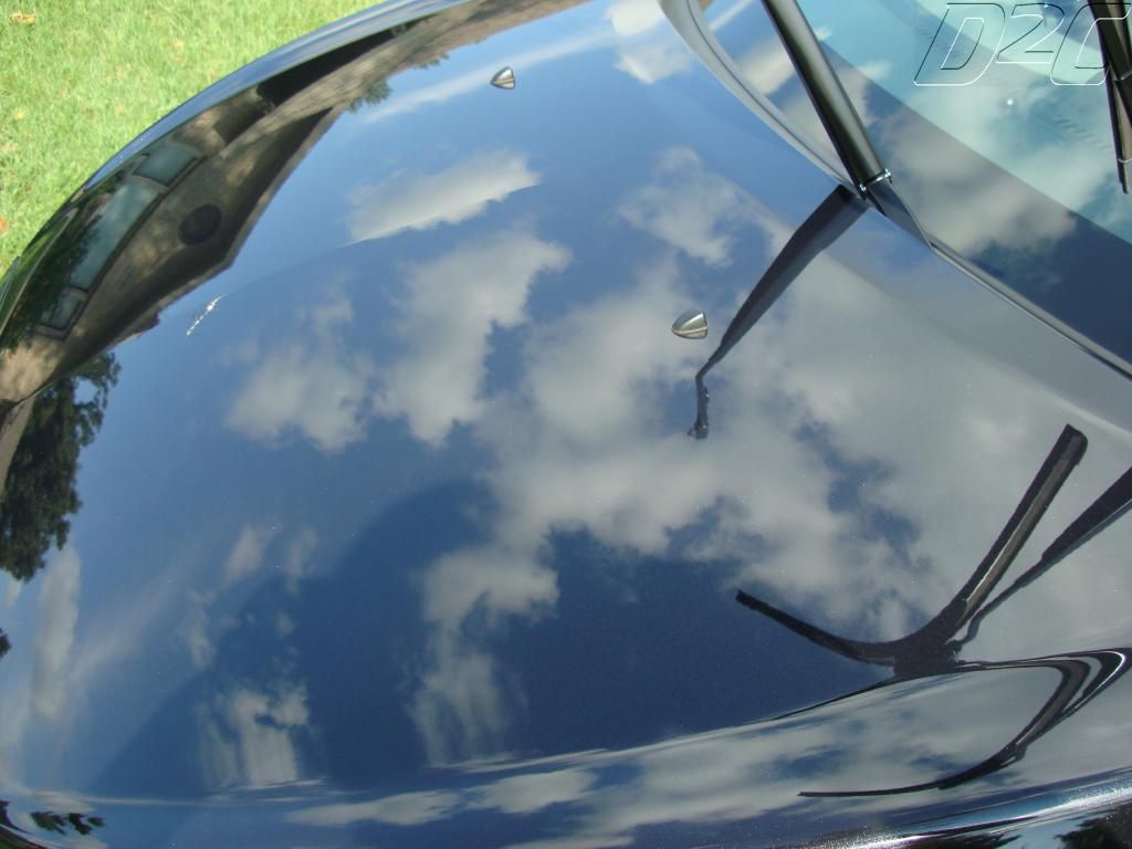

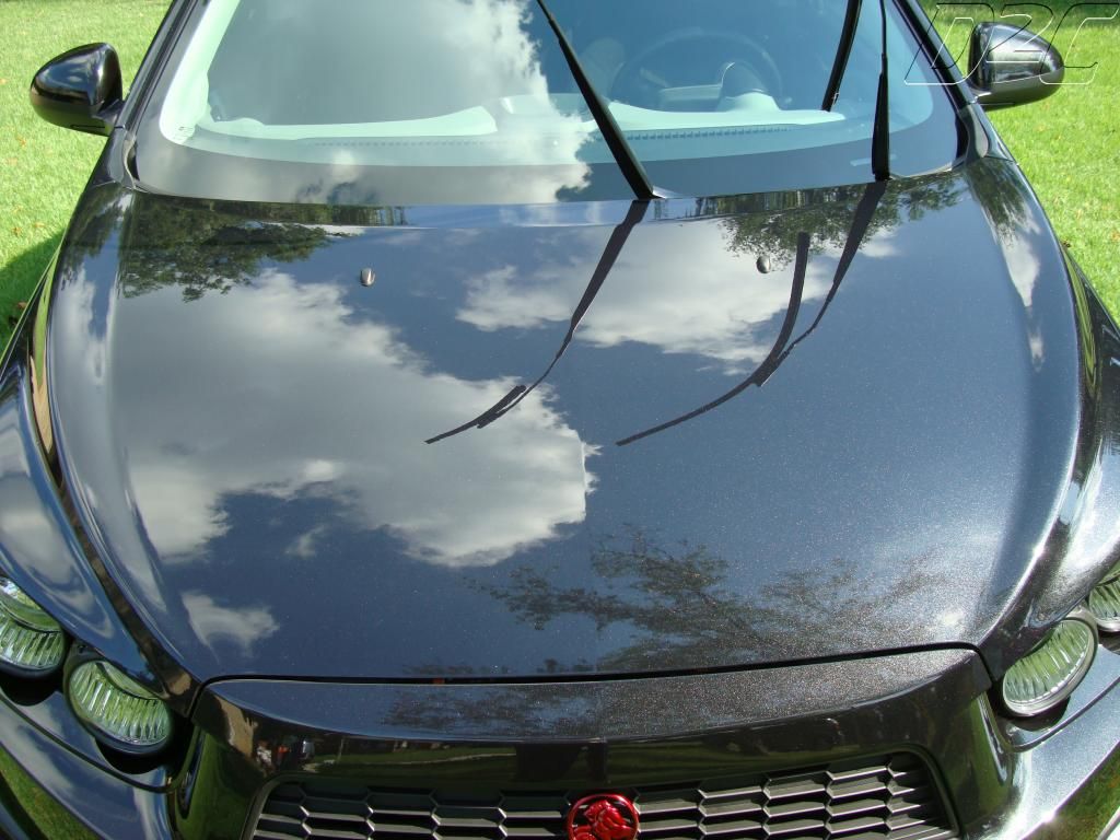

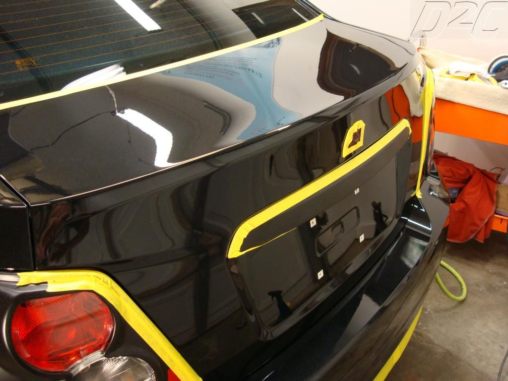

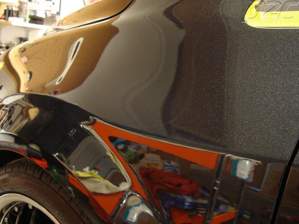

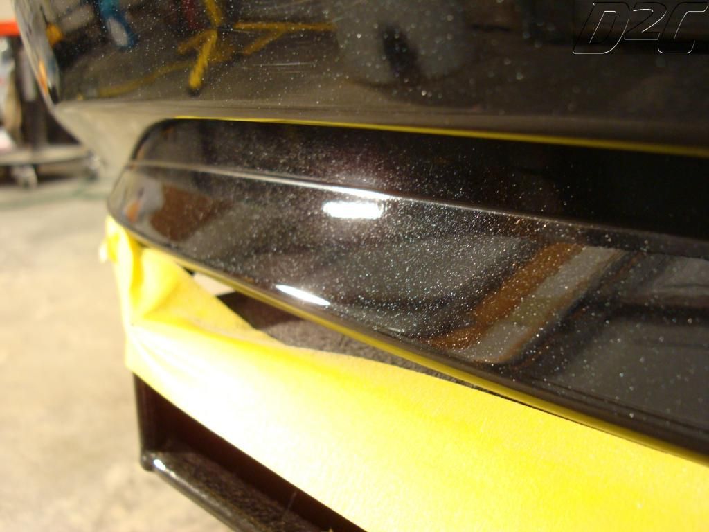

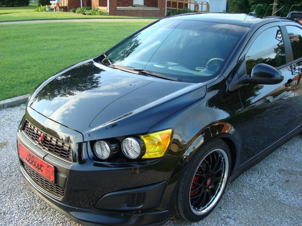

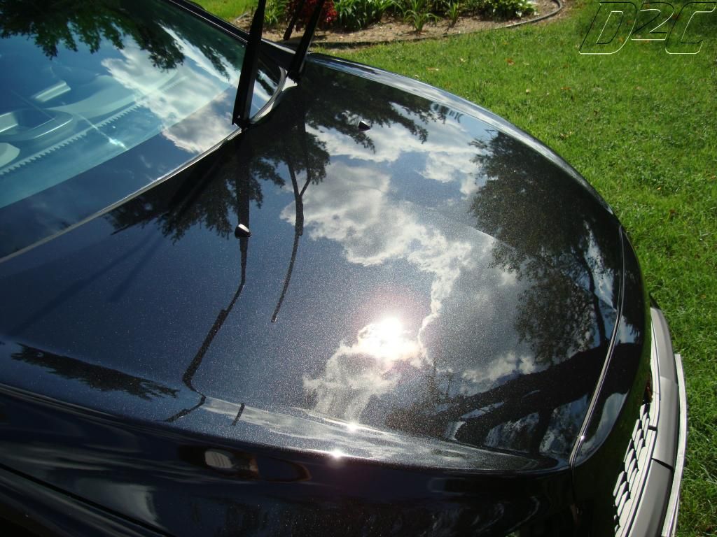

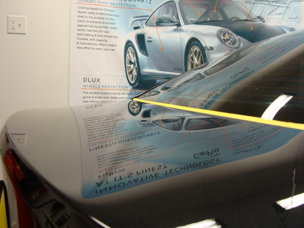

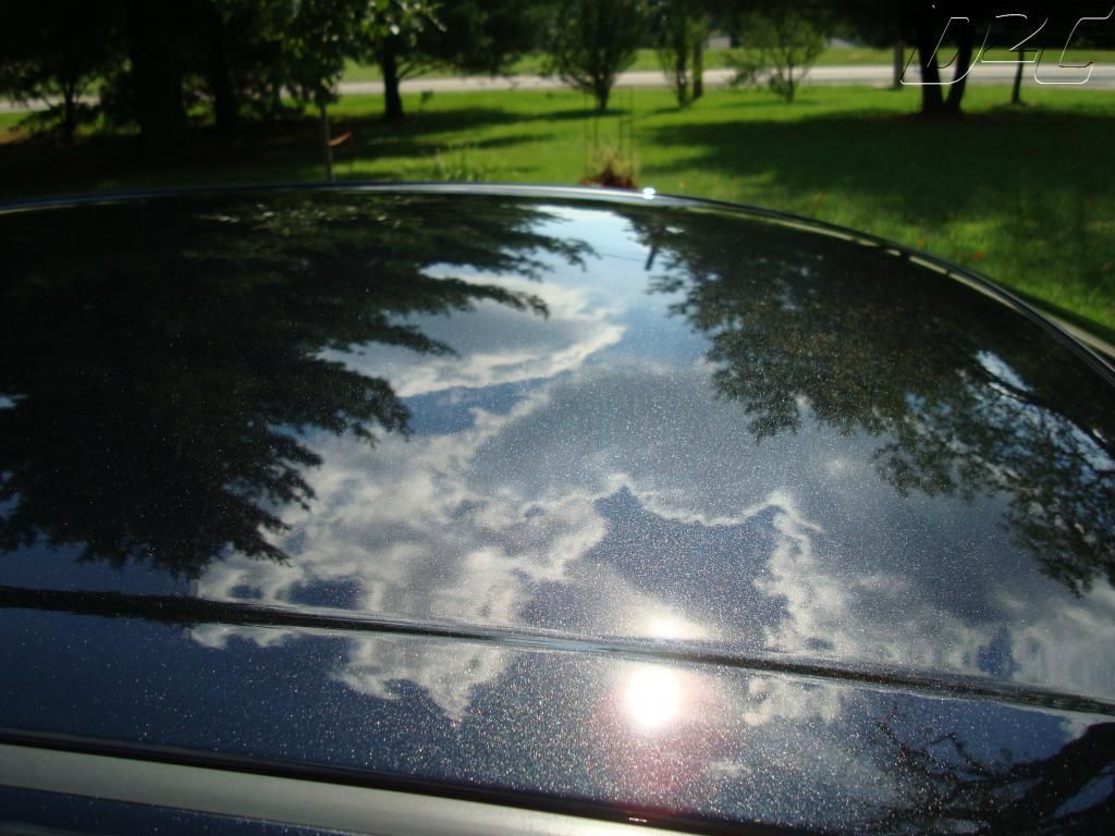

Car was washed again w/ IXSS and Dawn to removed any polishing oils left behind. Dried and wiped down w/ CarPro Eraser. Then the Boom Sauce was applied. 2 coats on the entire car, four coats on the front bumper and mirrors. Headlights protected w/ DLUX. Flyby30 on the glass.

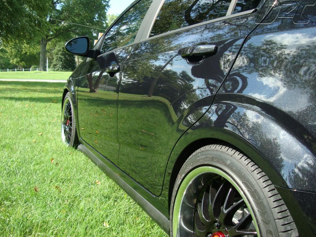

Afters
Afters
