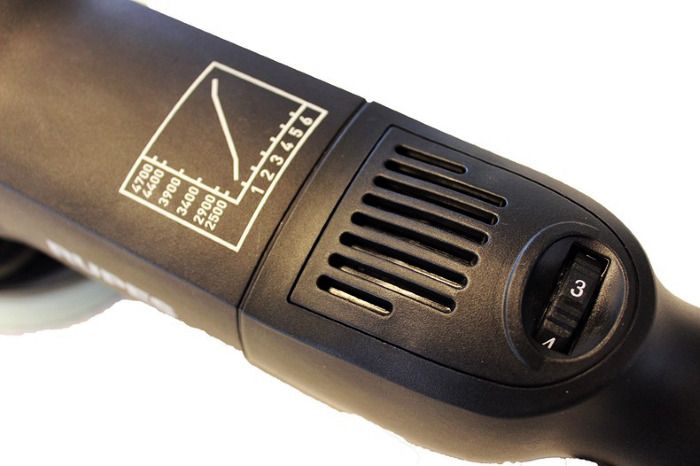

Could you share what you did, technique and speeds, between the Meg's pads and Car Pro's to achieve your results?
As always Merlin...:cool:
One of the many things I like about the NEW RUPES BigFoot Mark II is the OPM chart on the back of the handle.
Meguiars recommends that their microfiber discs be run at a speed of 3800 OPM for best results.
I've found that when the OPM settings are correct I have no disc issues caused by running too fast.
For the Carpro Flash pads I kept the machine at the same OPM speeds and I was happy with the end result.
For the Carpro Gloss pads I kept the machine at the same OPM speeds and I was happy with the end result.

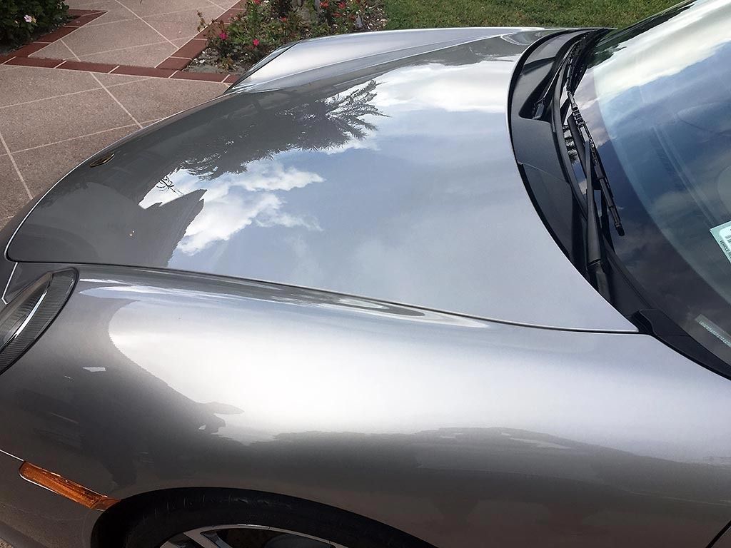

Hey Merlin, what shape was the car in when you got her? Also I would be very interested in seeing your polishing technique. Any chance on a video so we can see a master at work?
1) Hey Merlin, what shape was the car in when you got her?
2) Also I would be very interested in seeing your polishing technique.
3) Any chance on a video so we can see a master at work?
1) Not too bad. there were a couple a places that he had concern.
There was a fairly bad section on the drivers front fender.
He was not sure how it got there. Possibly a ladies purse?
All the scratches were gone and he could not find any of them at all.
