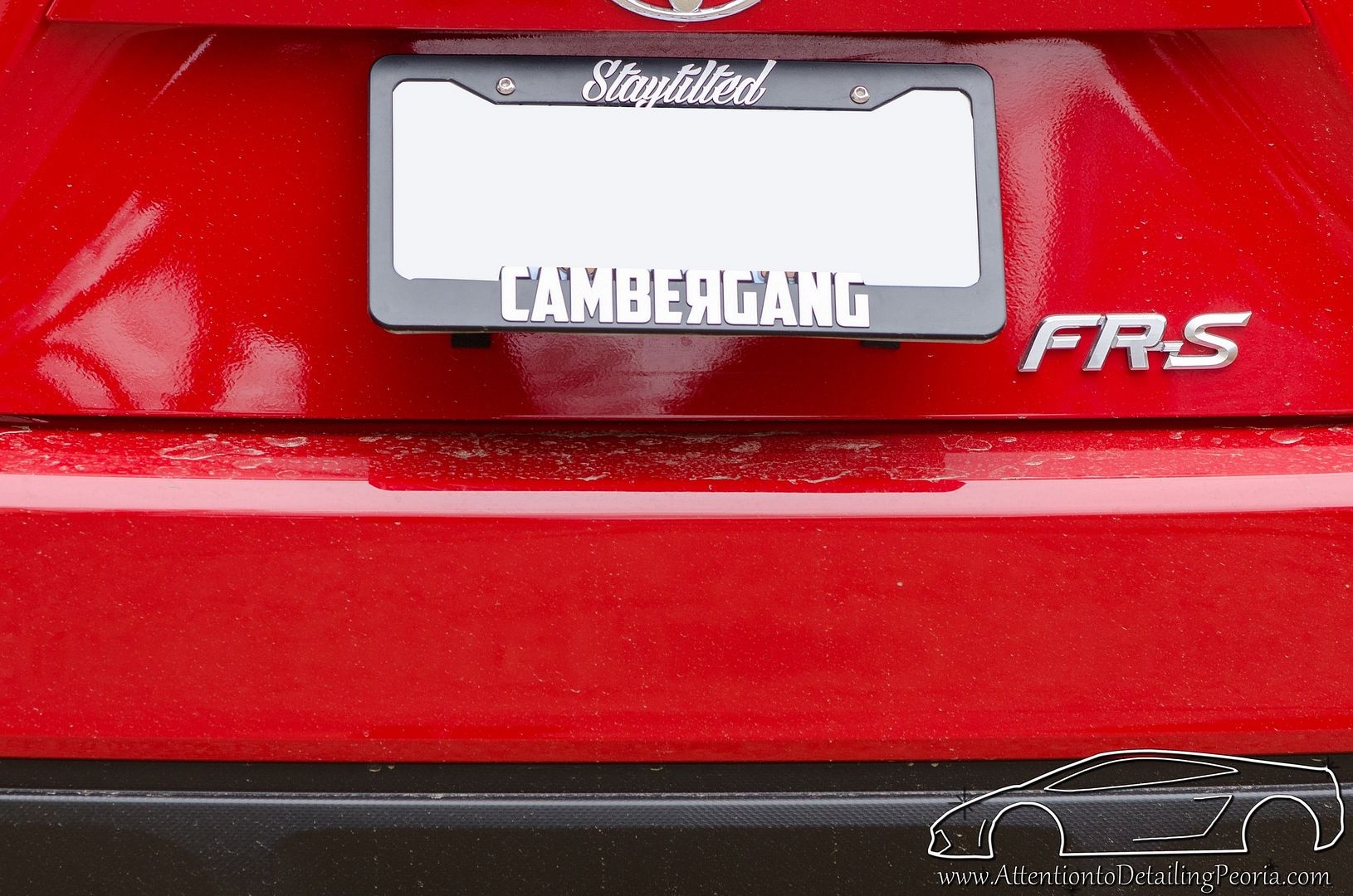

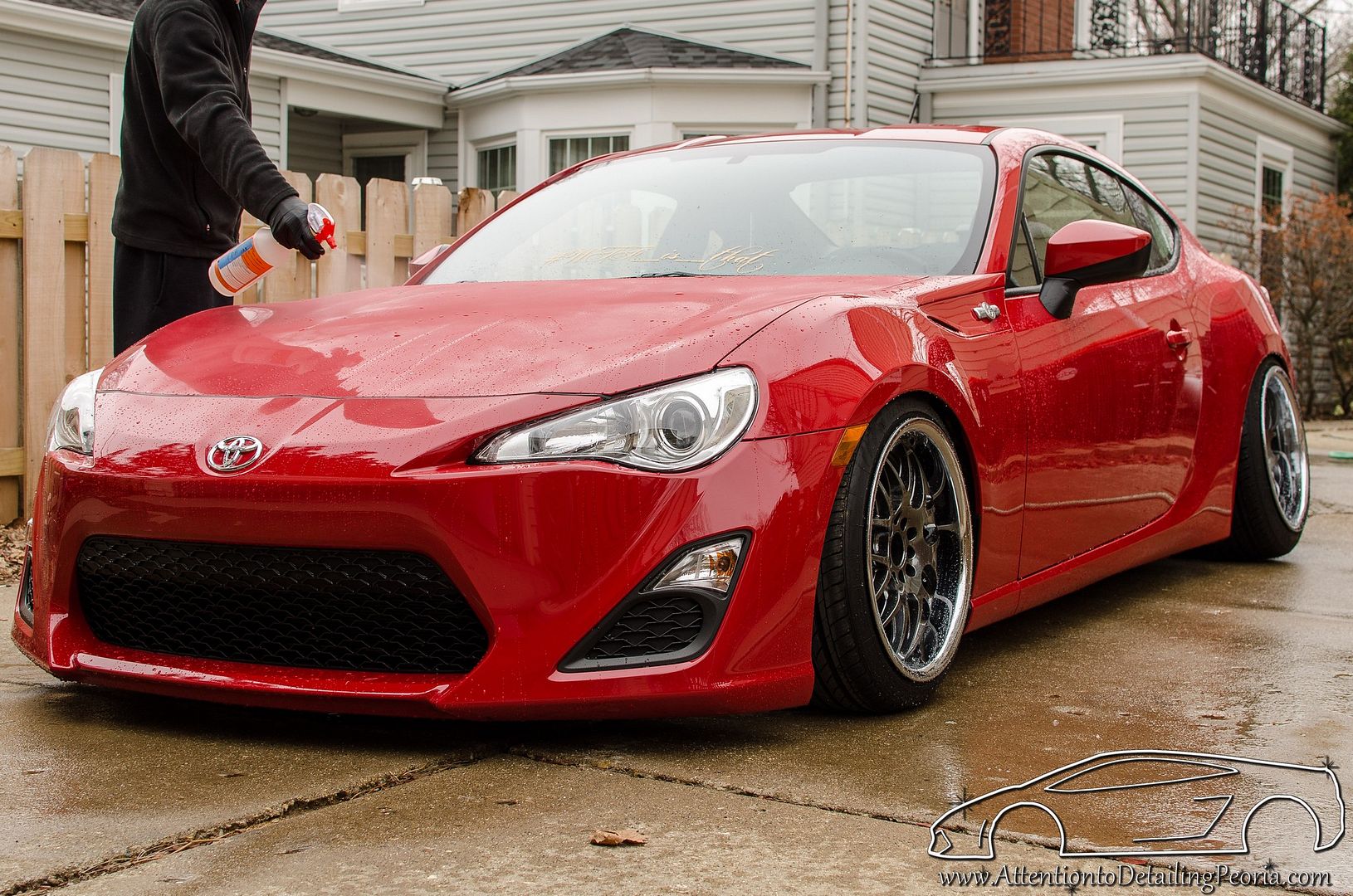

The car arrived fairly clean with just some light dirt and water spots

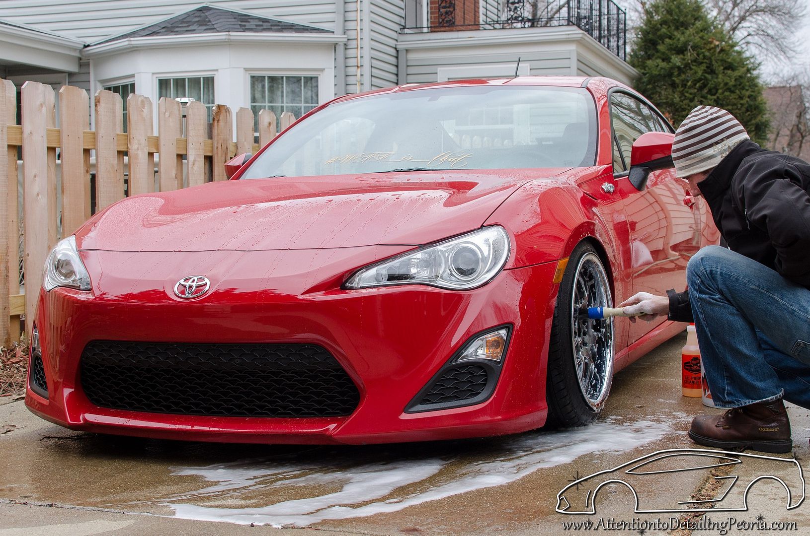

There was literally no ground clearance on this car... time to get started with the wash.
During

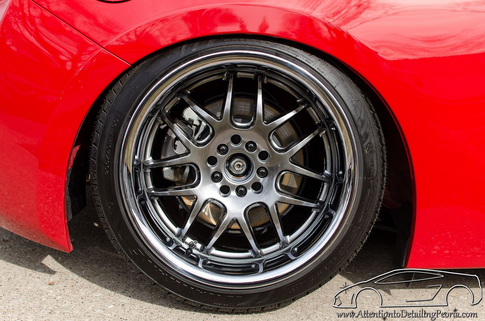

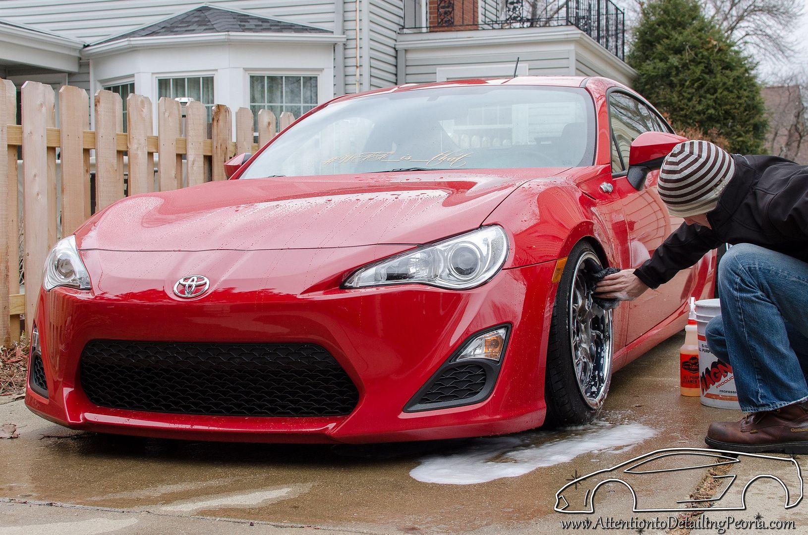

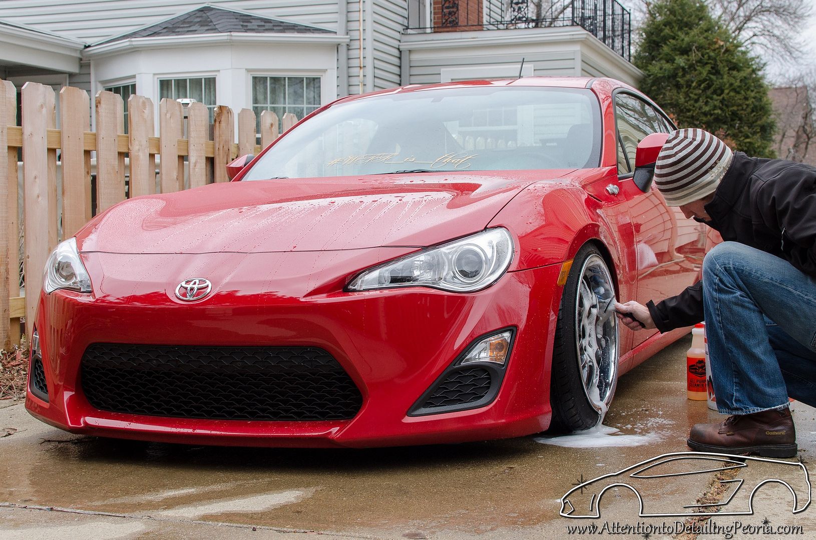

As always, wheels were first. I started by cleaning the barrels of the wheels.
Next I moved onto the faces of the wheels
and finally cleaned up the lug nuts and bore

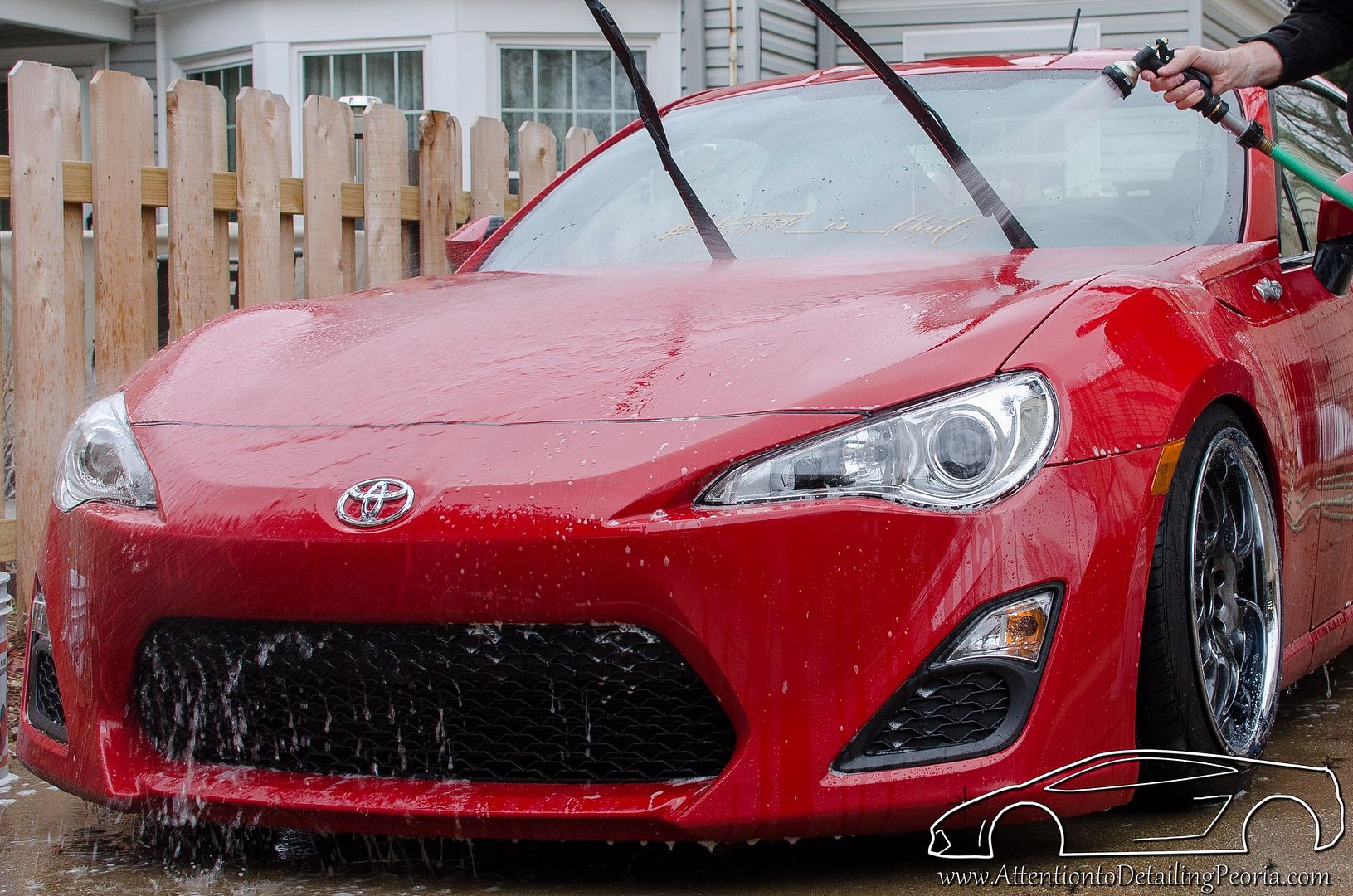

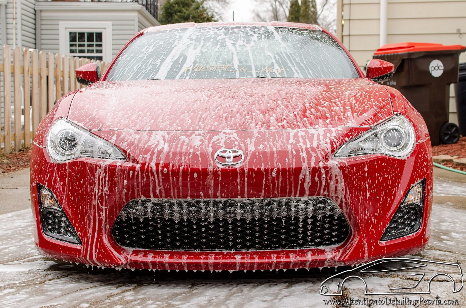

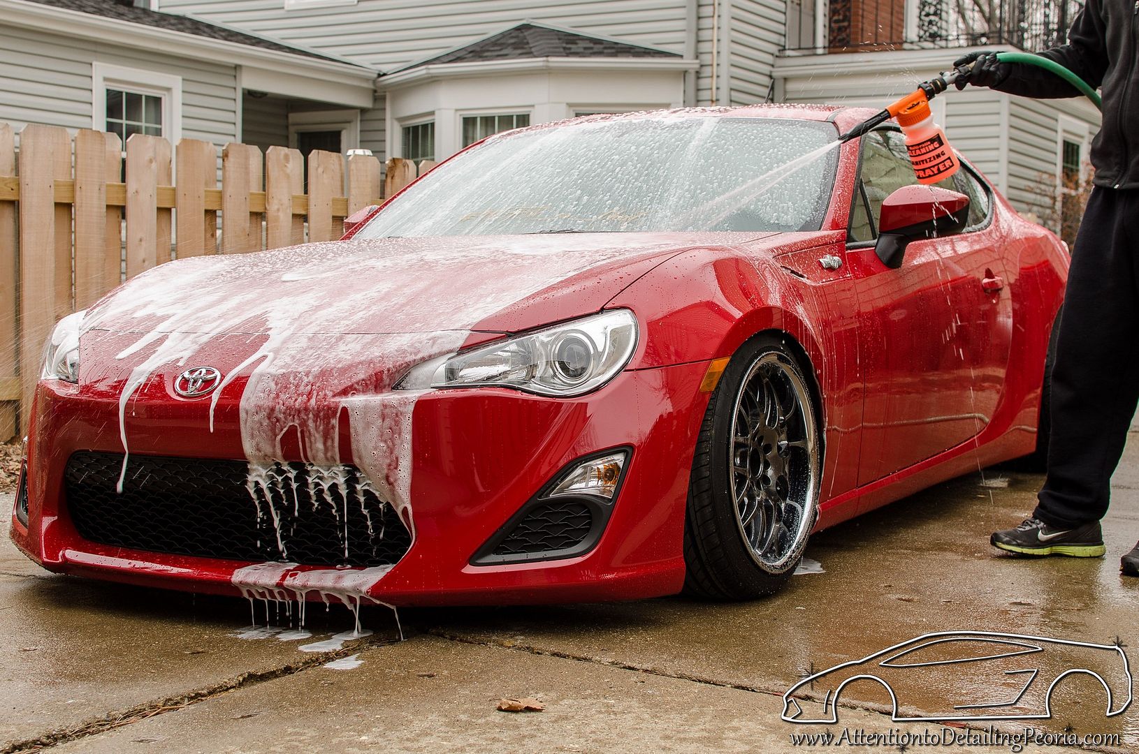

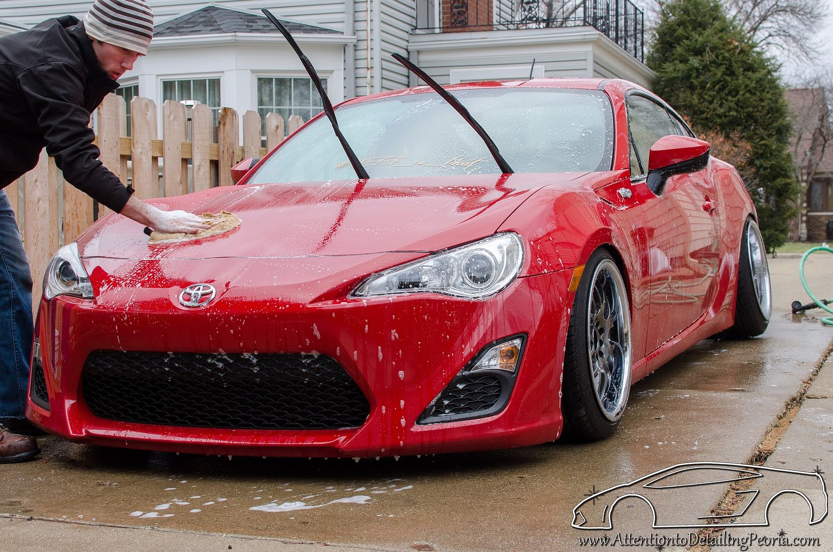

The vehicle was then degreased, carefully washed, and then blown dry with the Master Blaster

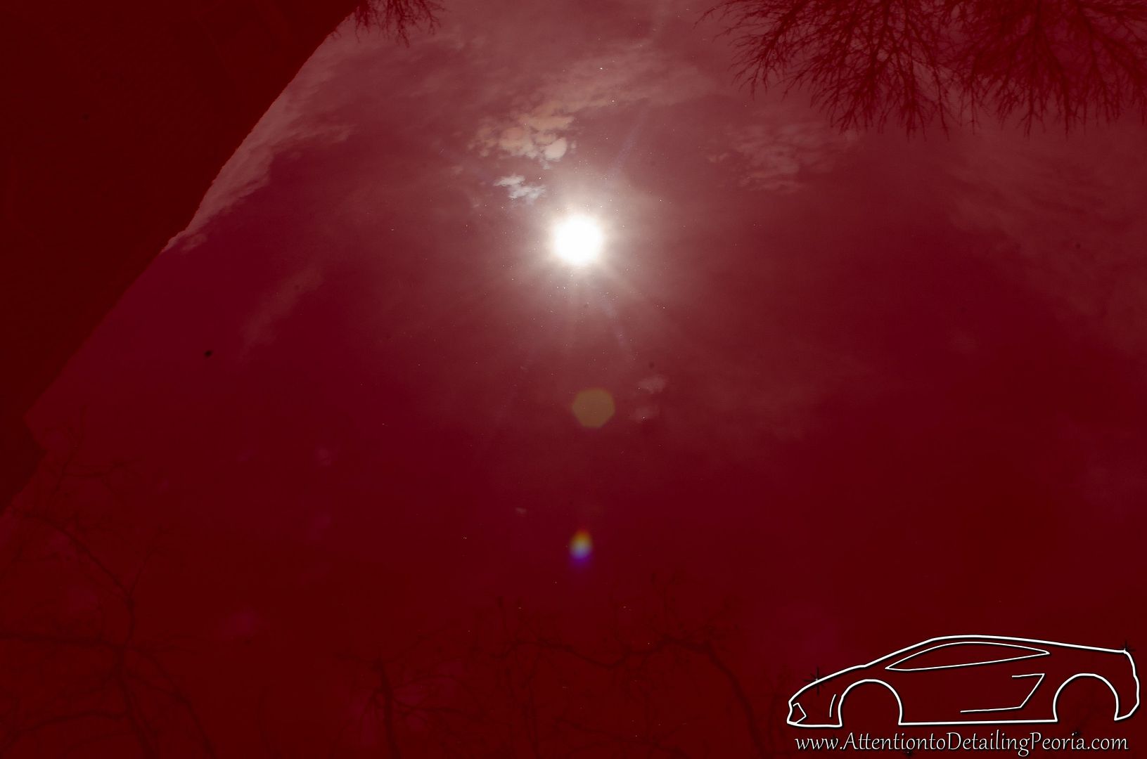

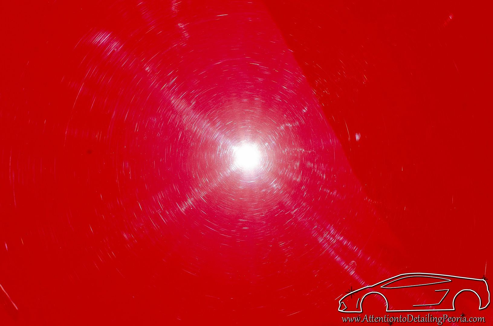

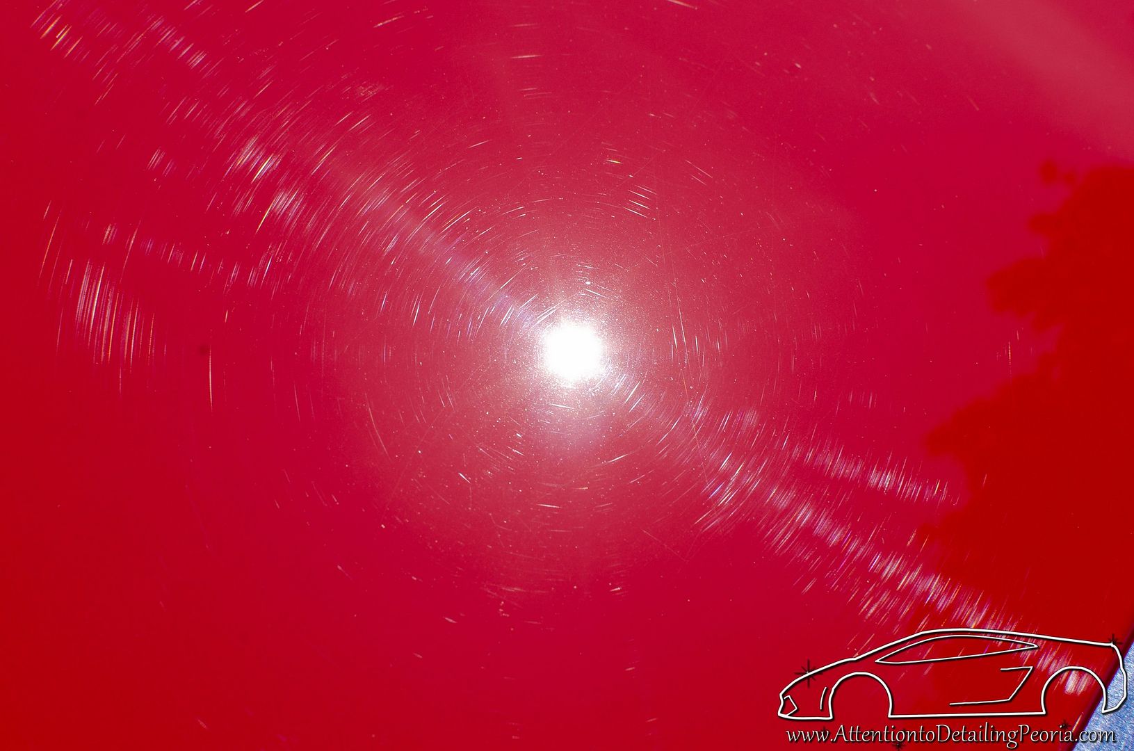

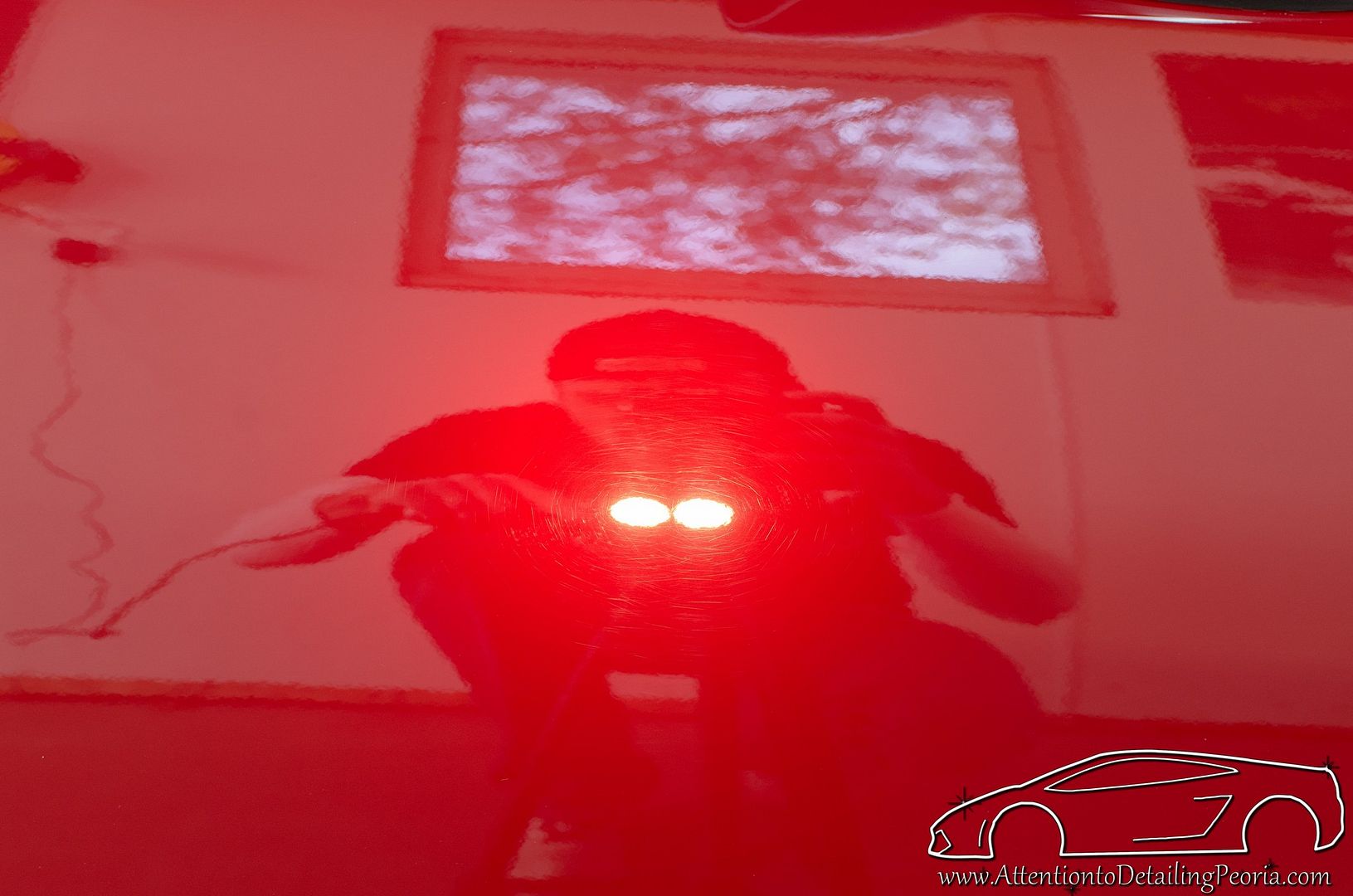

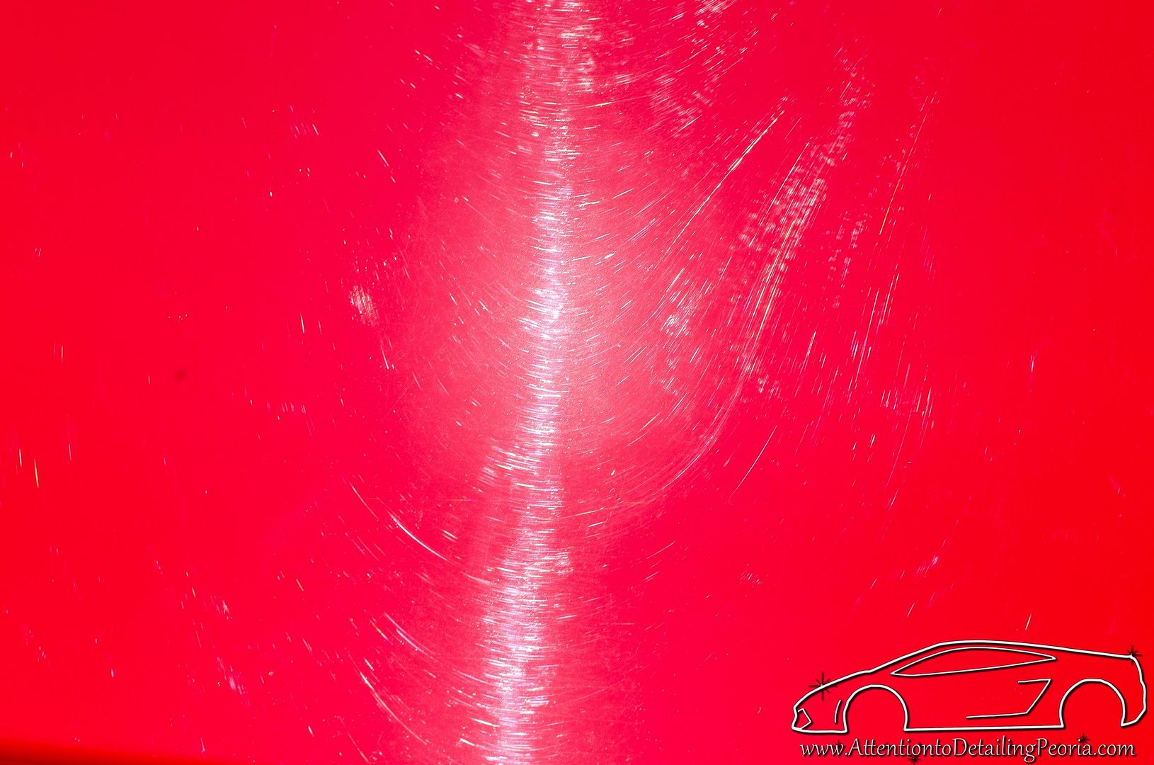

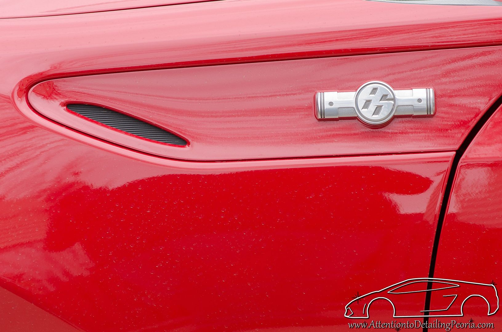

Once the paint was clean, I was able to inspect the condition of the paint. It was definitely in worse shape than you would hope a vehicle with only 3500 miles would be.

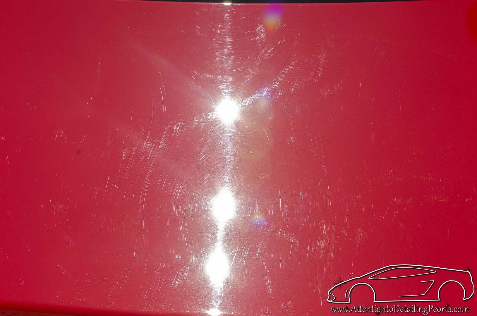

The next morning I was able to pull the car out into the sun to truly reveal the condition of the paint. There were a lot of swirls covering the entire vehicle. Significantly more than you would expect for a relatively new car.... this should have been my first clue that I was going to be dealing with soft paint.
After a lot of testing, I dialed in my process and due to the very soft paint, was able to achieve very good correction.

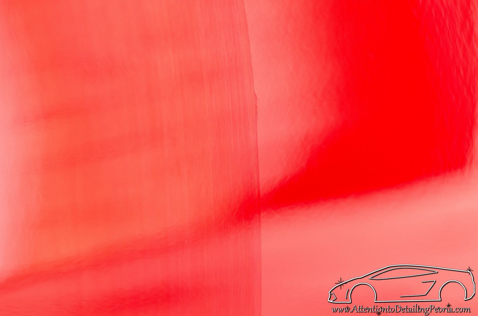

Hood before polishing
Hood after polishing
How about that gloss & depth!

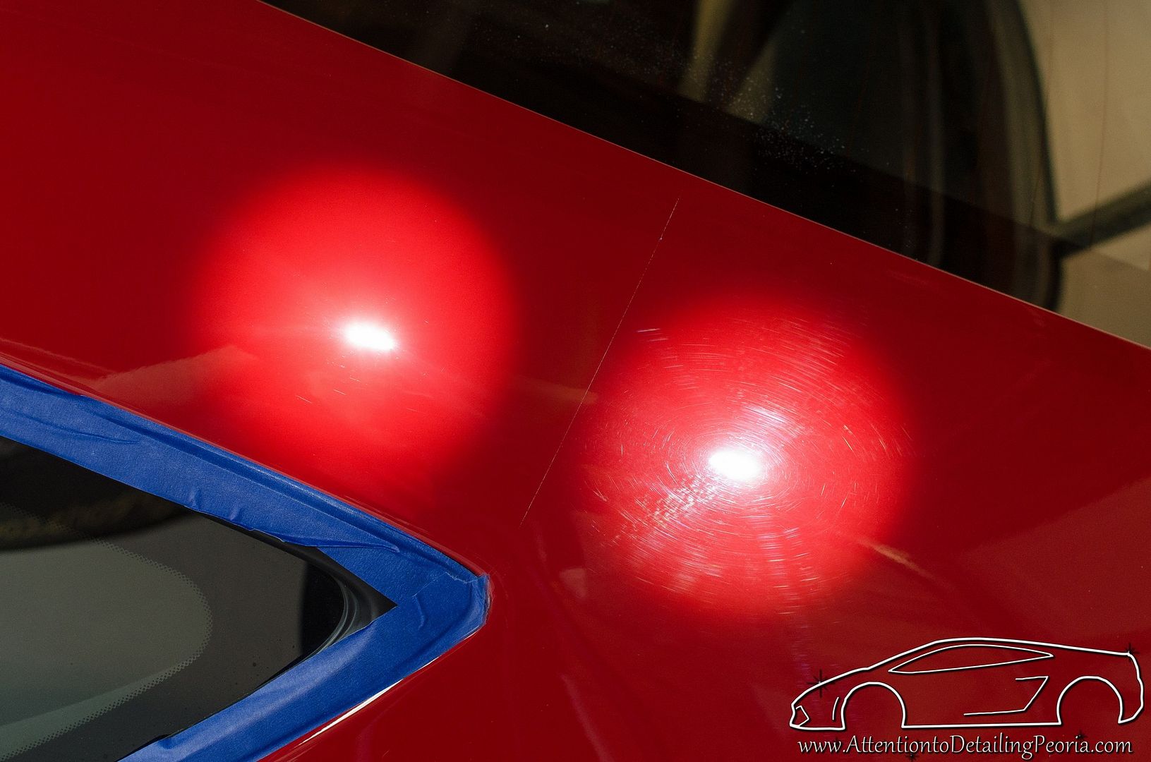

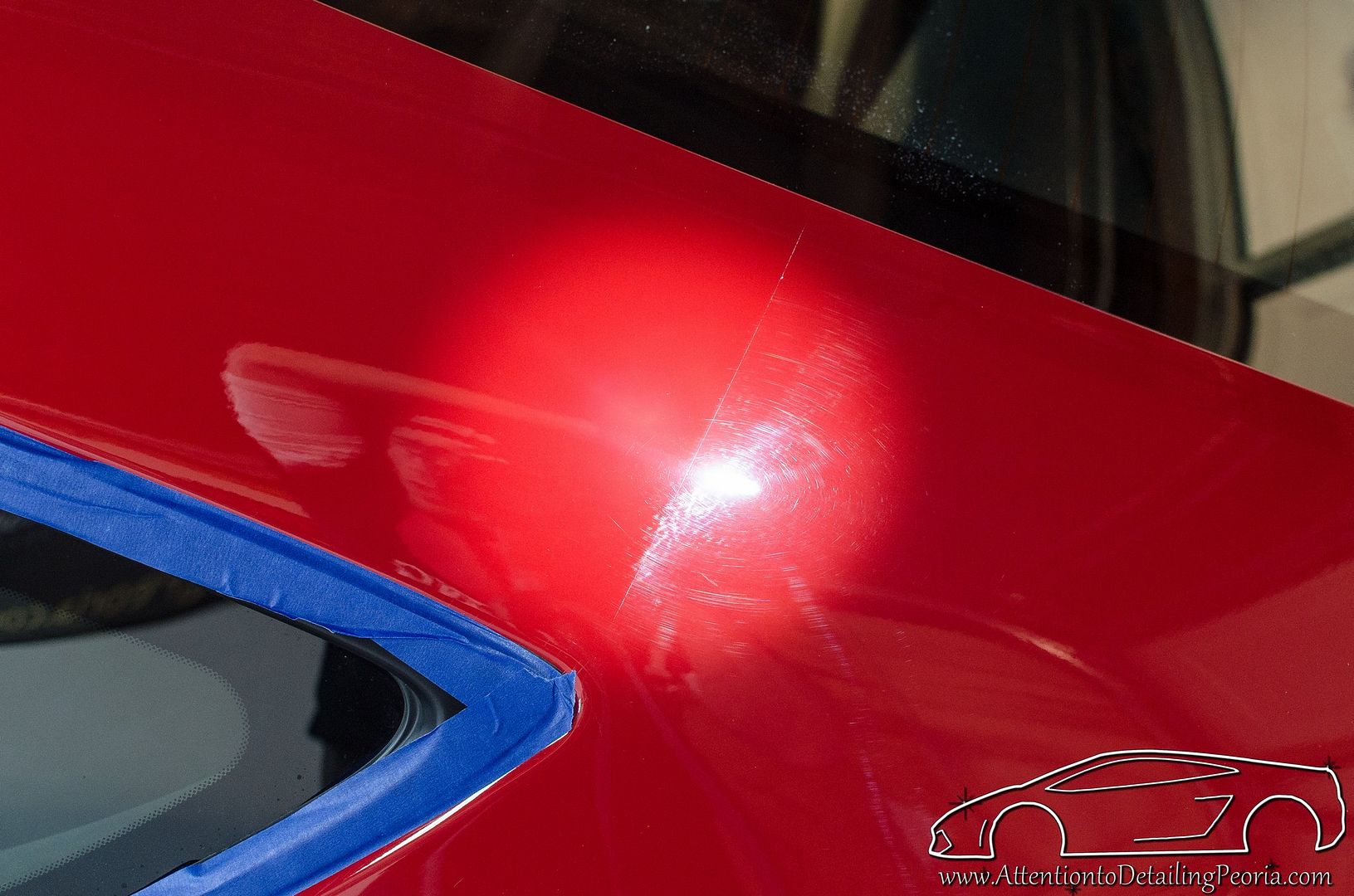

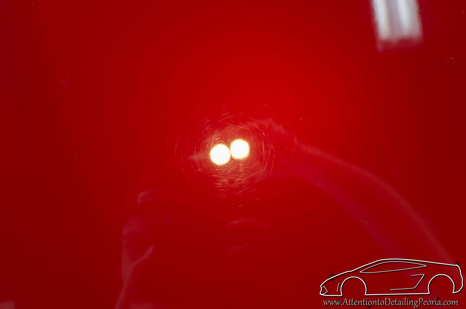

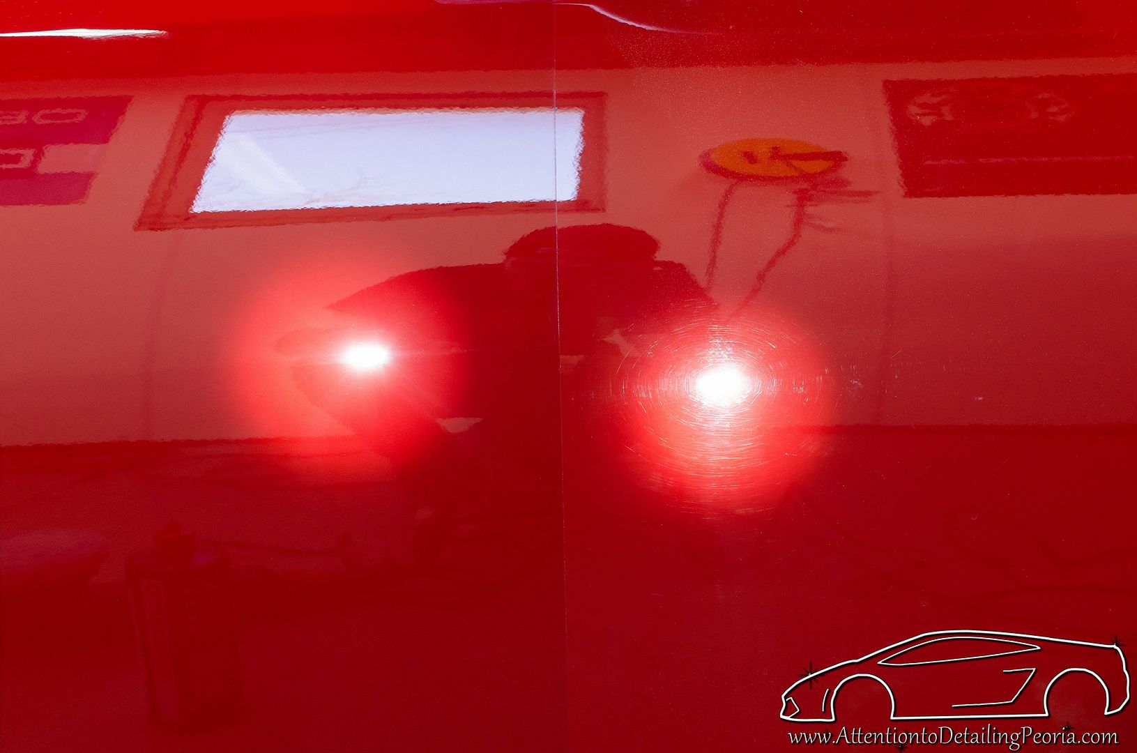

50/50 shot on the pillar
50/50 shot on the door

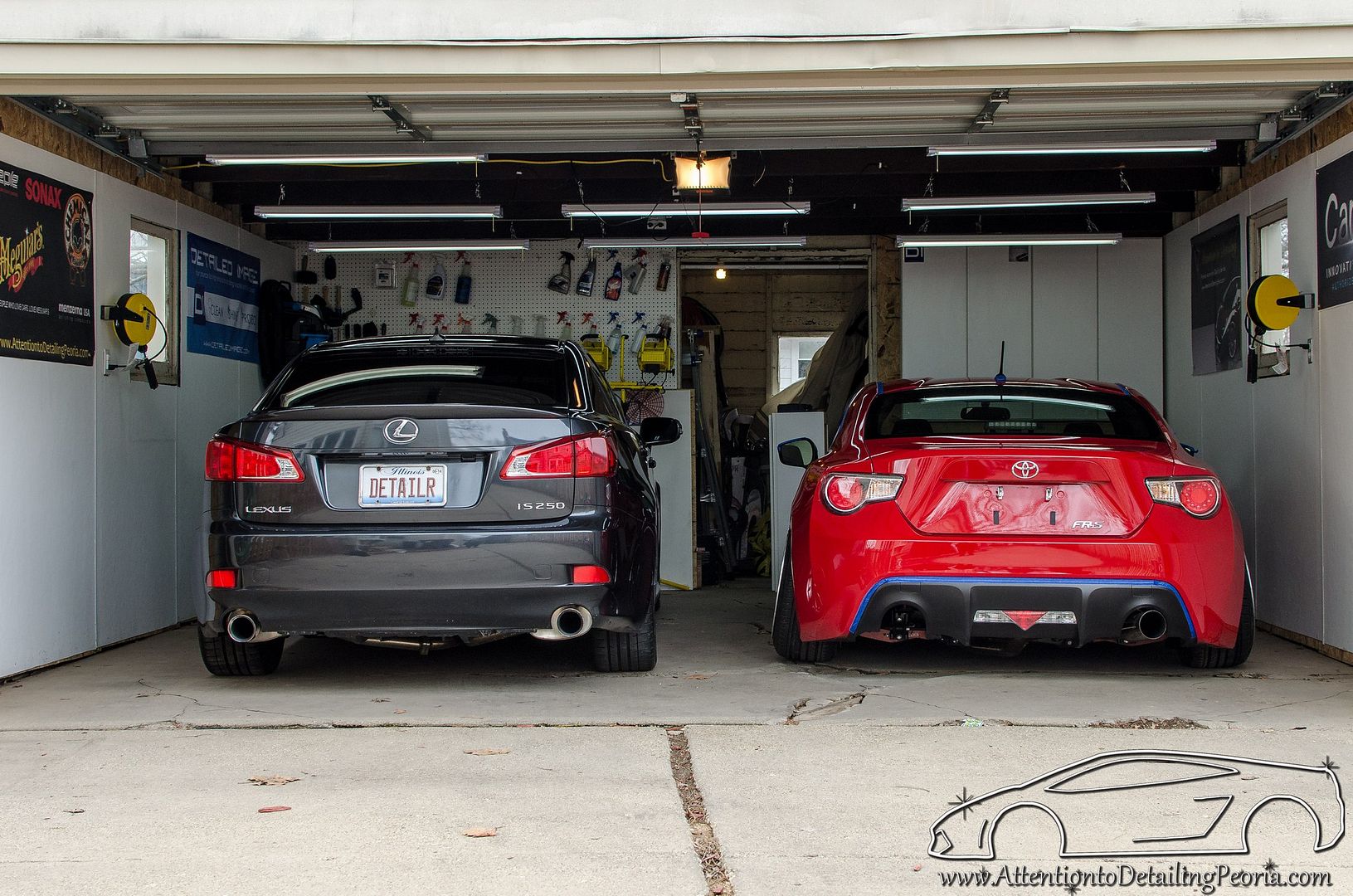

It is not often that I work on a vehicle that makes my own look like a giant, but this one certainly did!

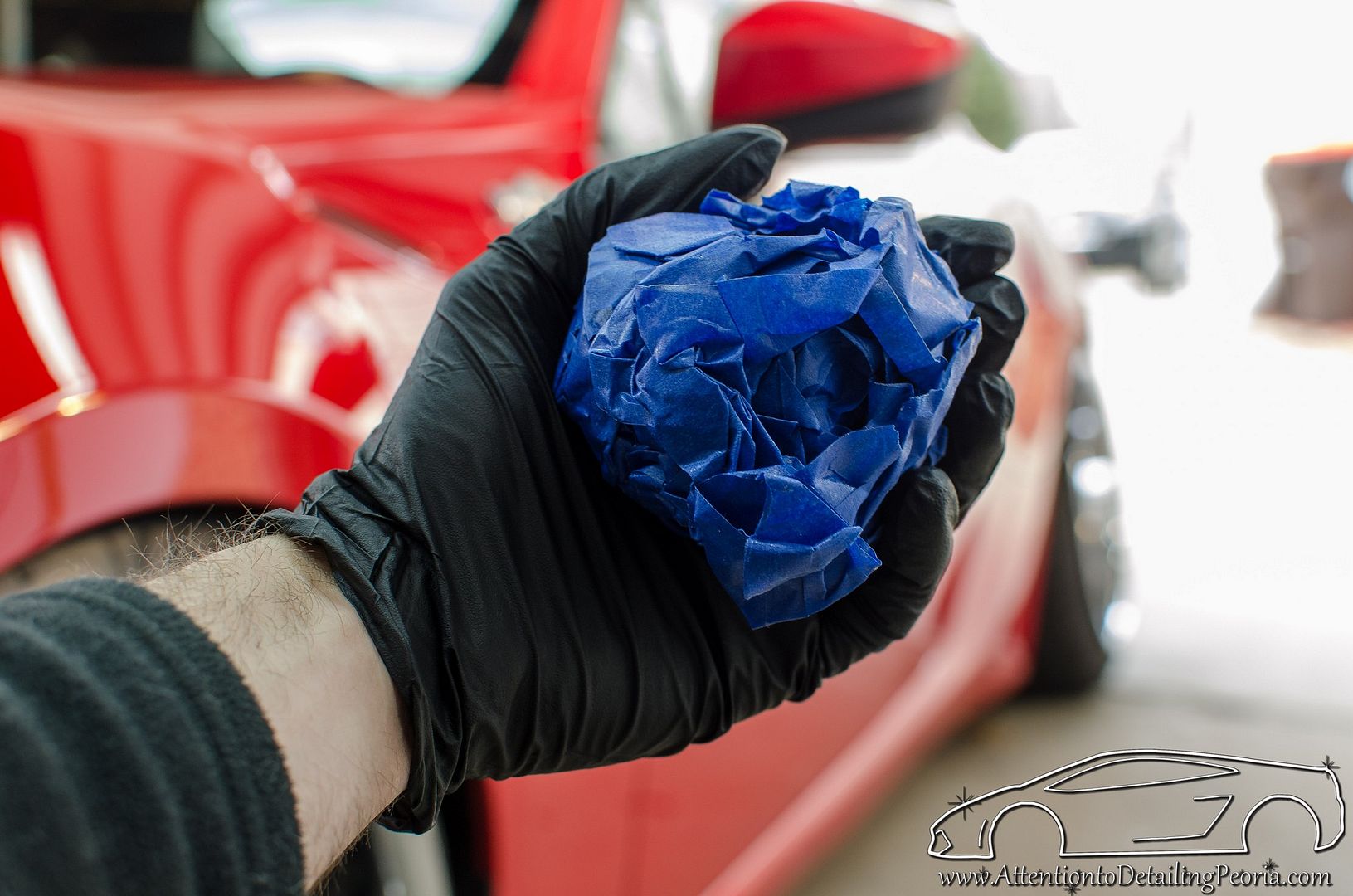

Once polishing was complete, tape was removed before I started prepping the paint for the coating

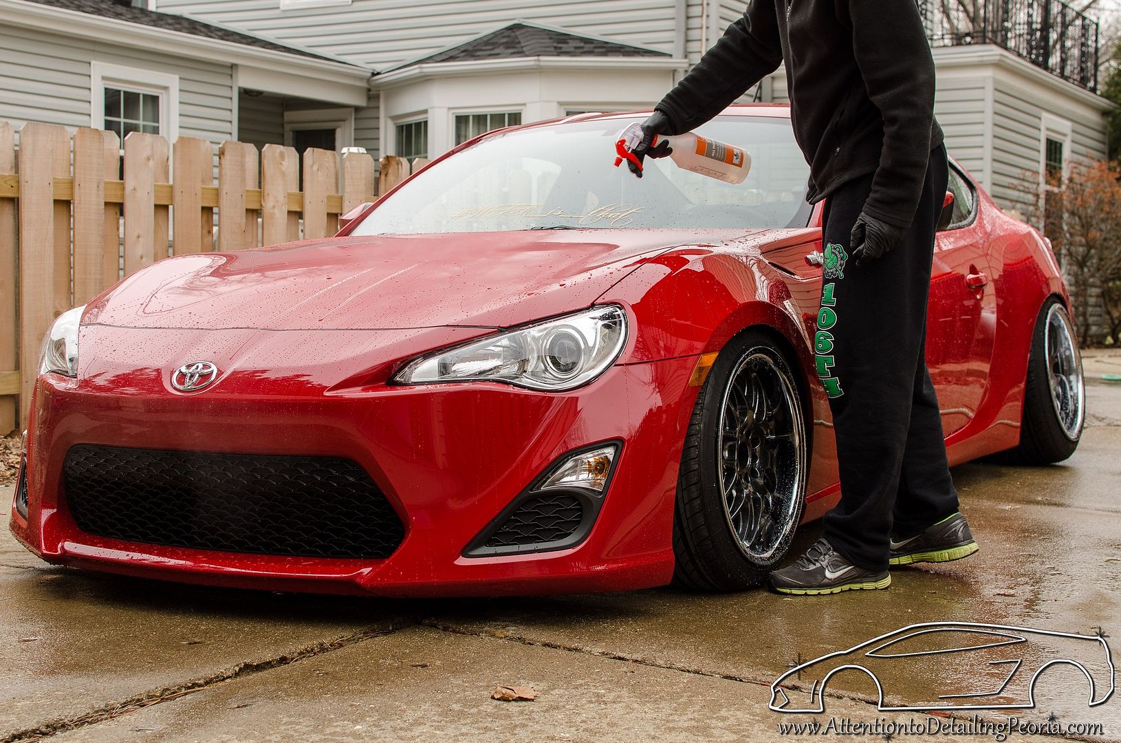

The surface was sprayed with a diluted IPA mixture
Next the car was foamed with a mixture of citrus wash & APC to remove any remaining oils from the surface of the car.

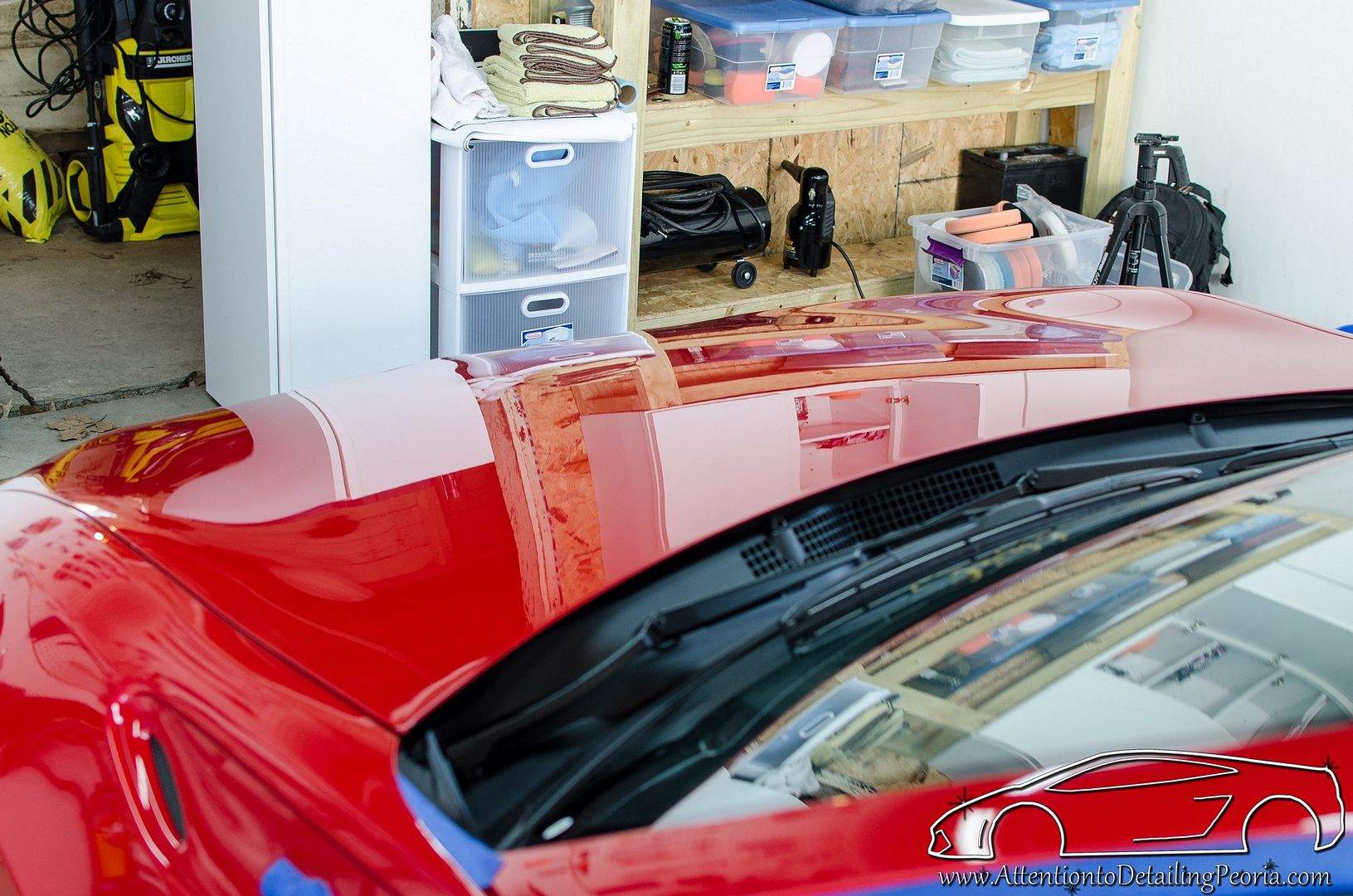

The car was then left to cure in the sunlight for several hours... the paint looked great!!

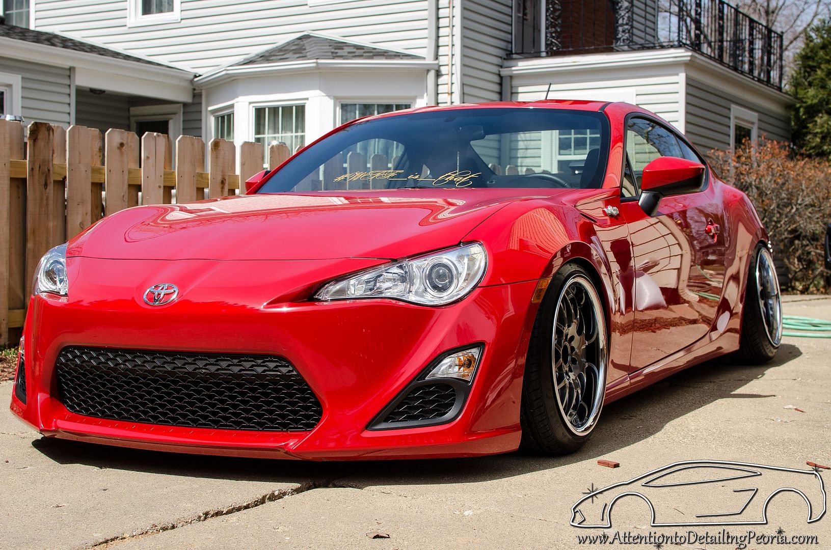

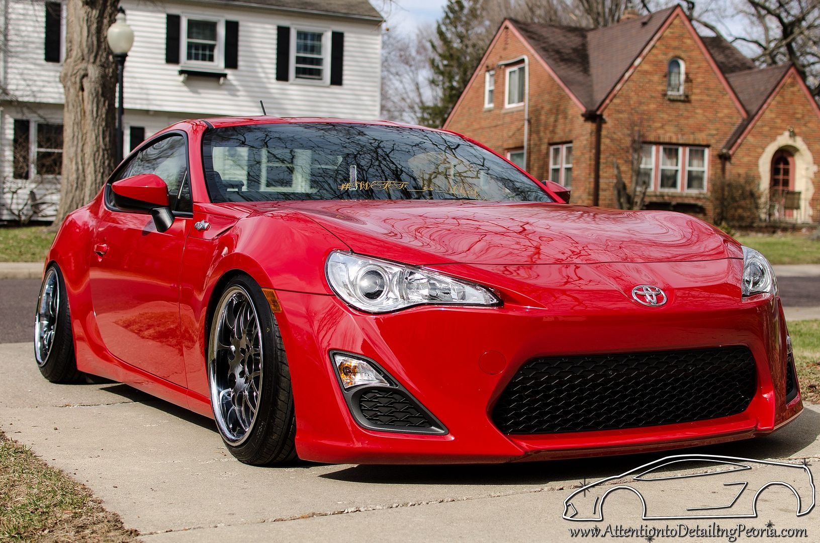

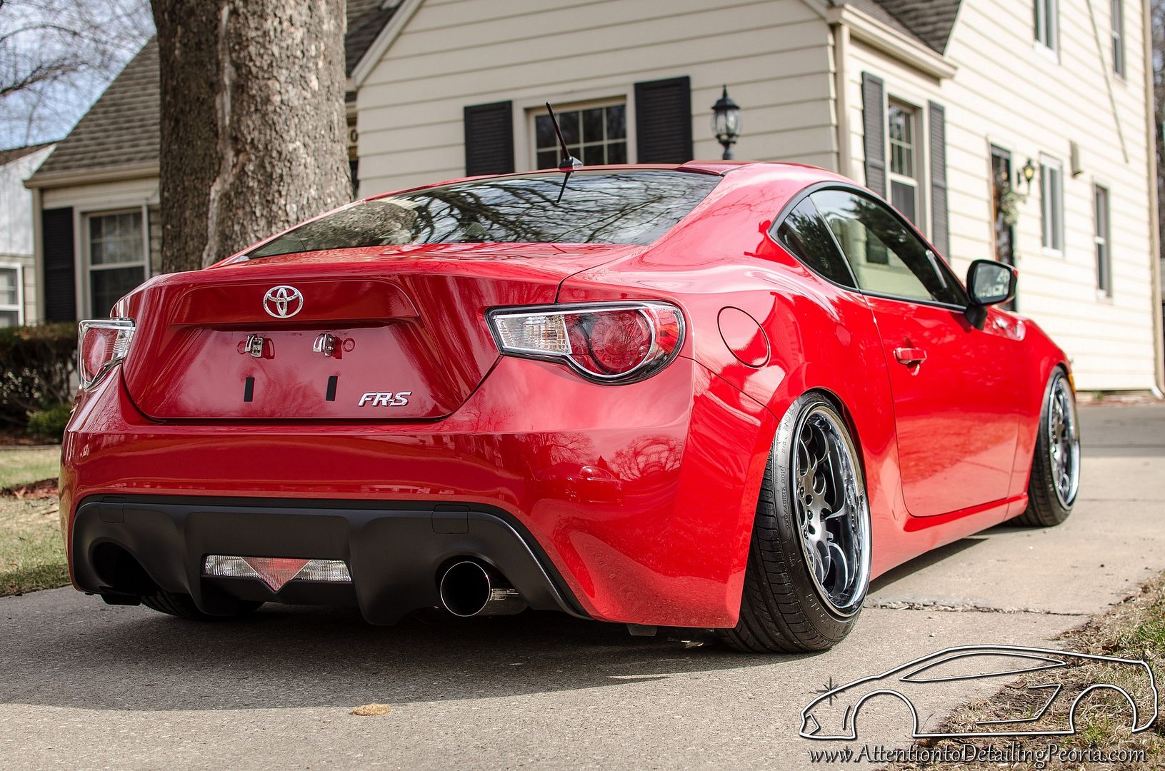

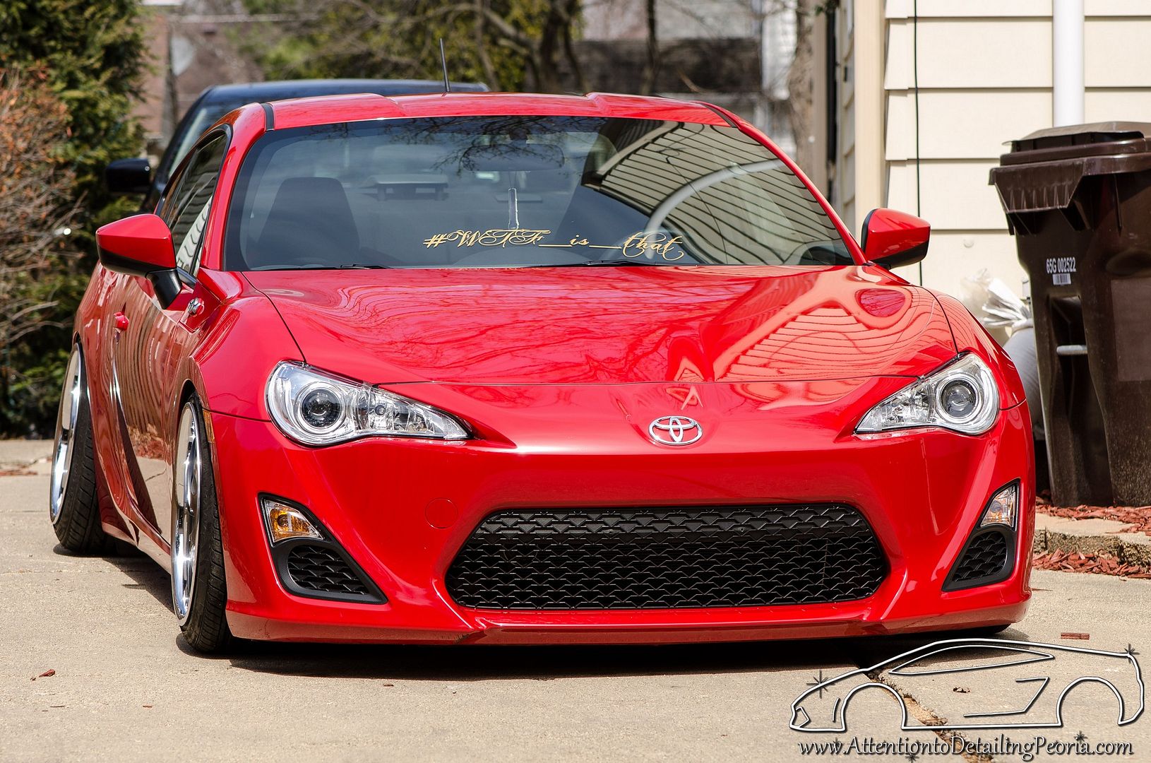

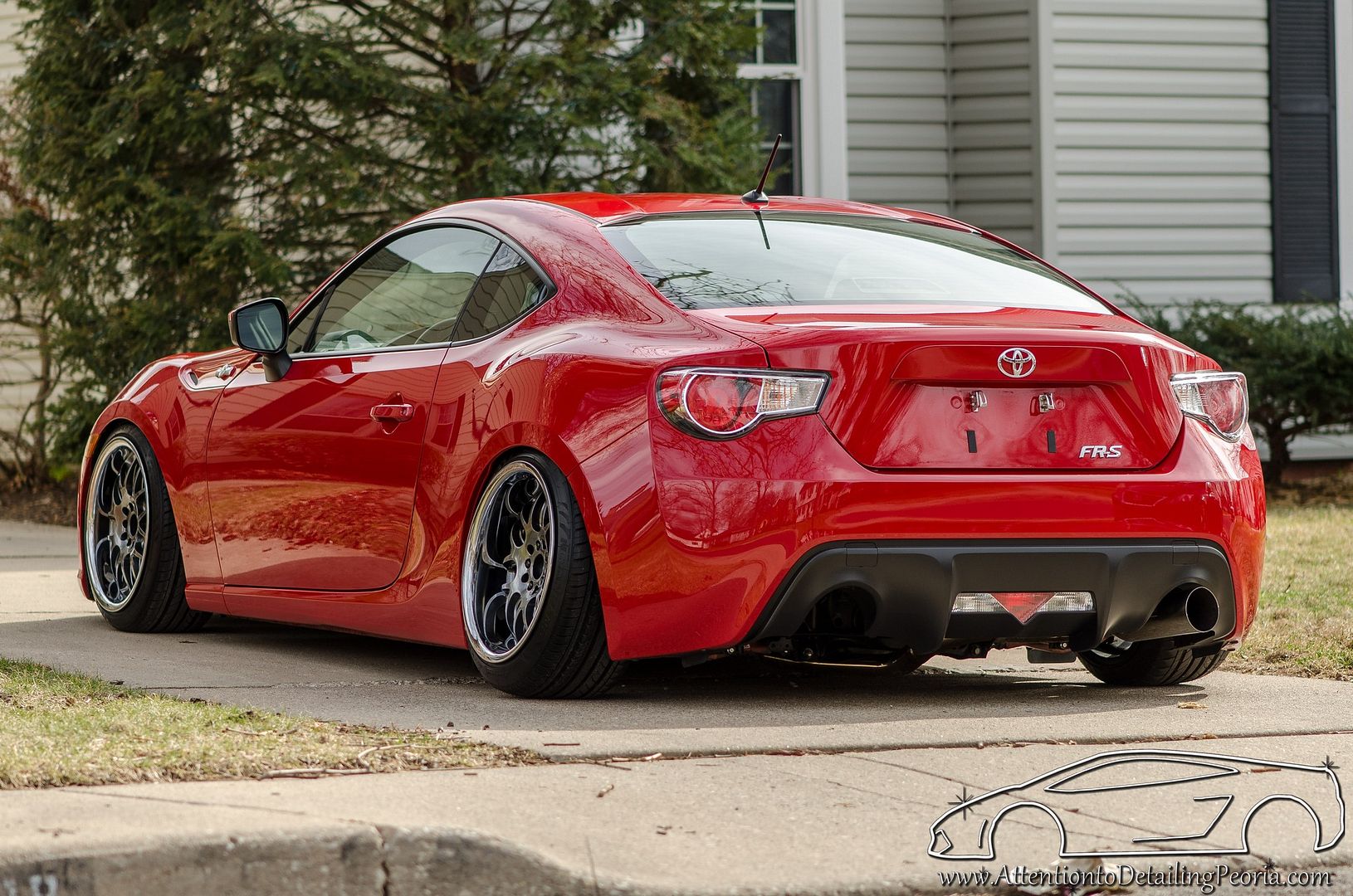

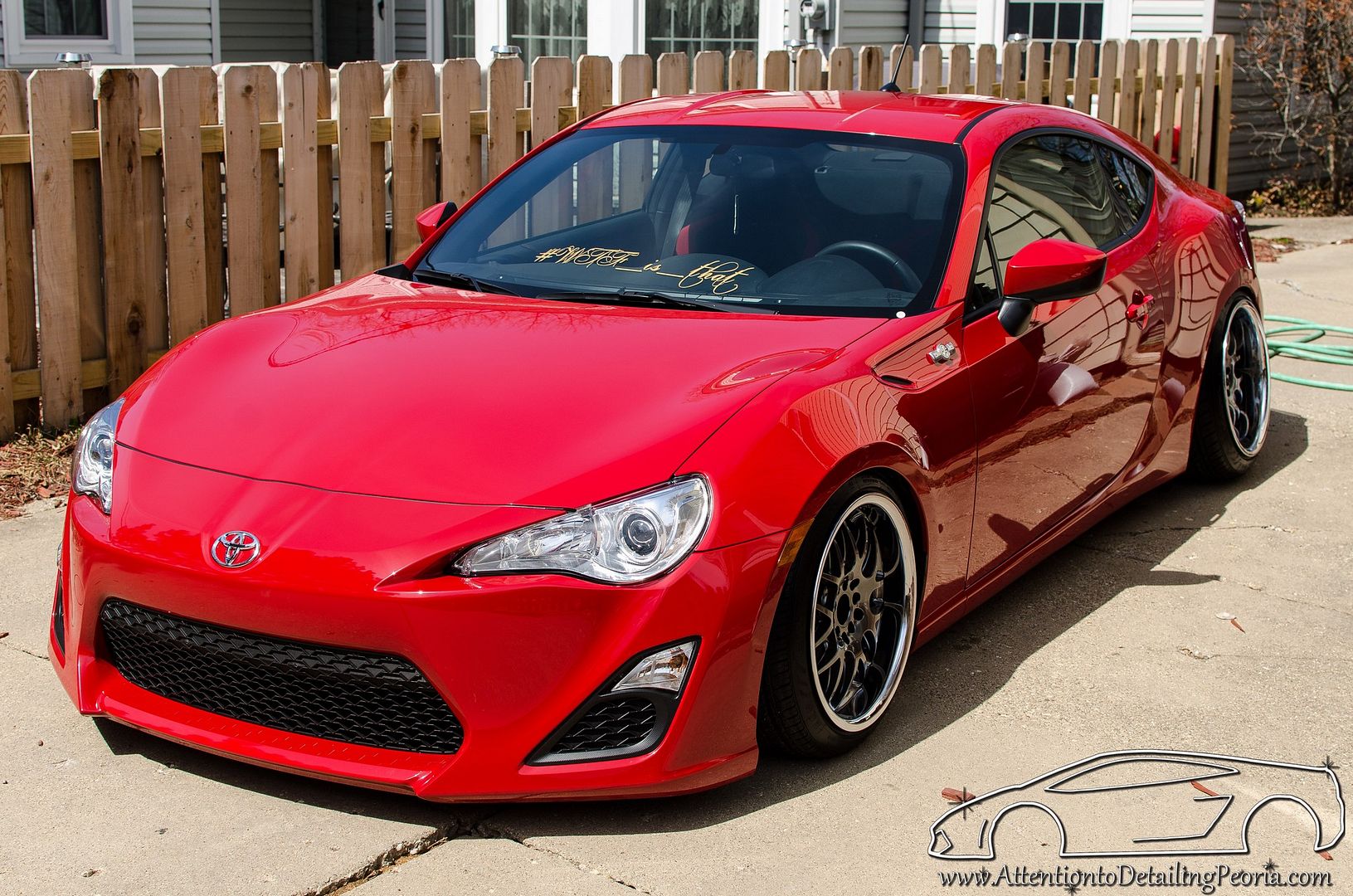

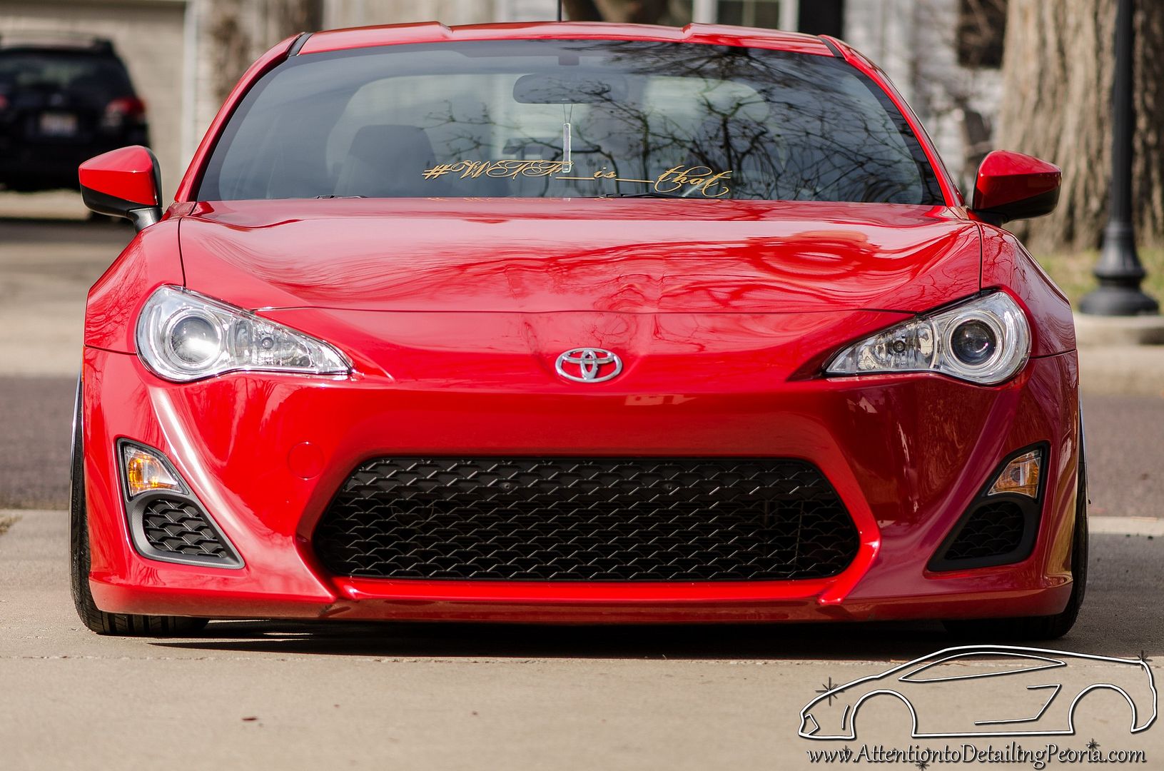

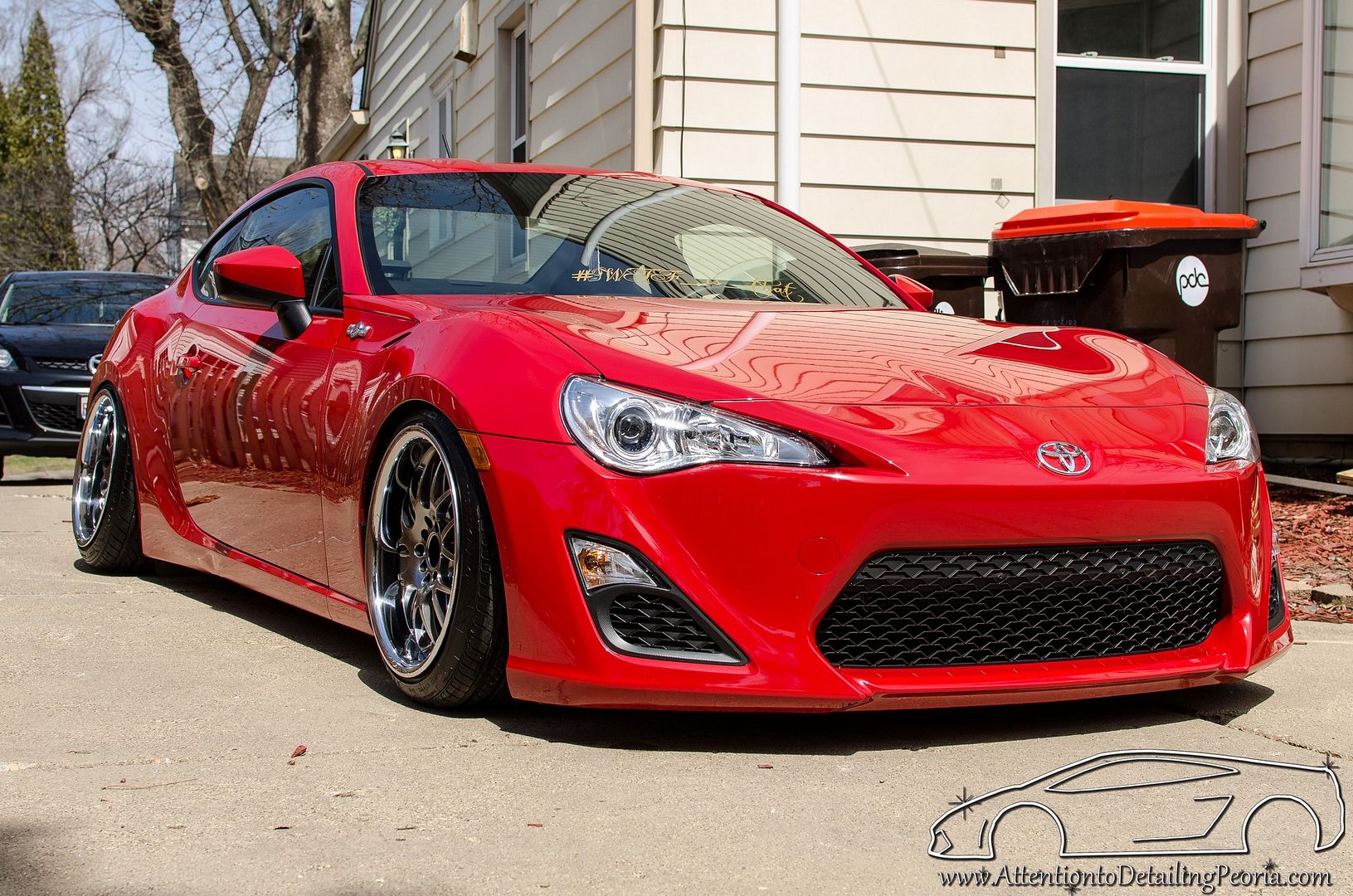

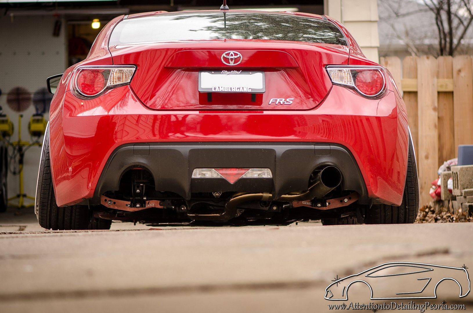

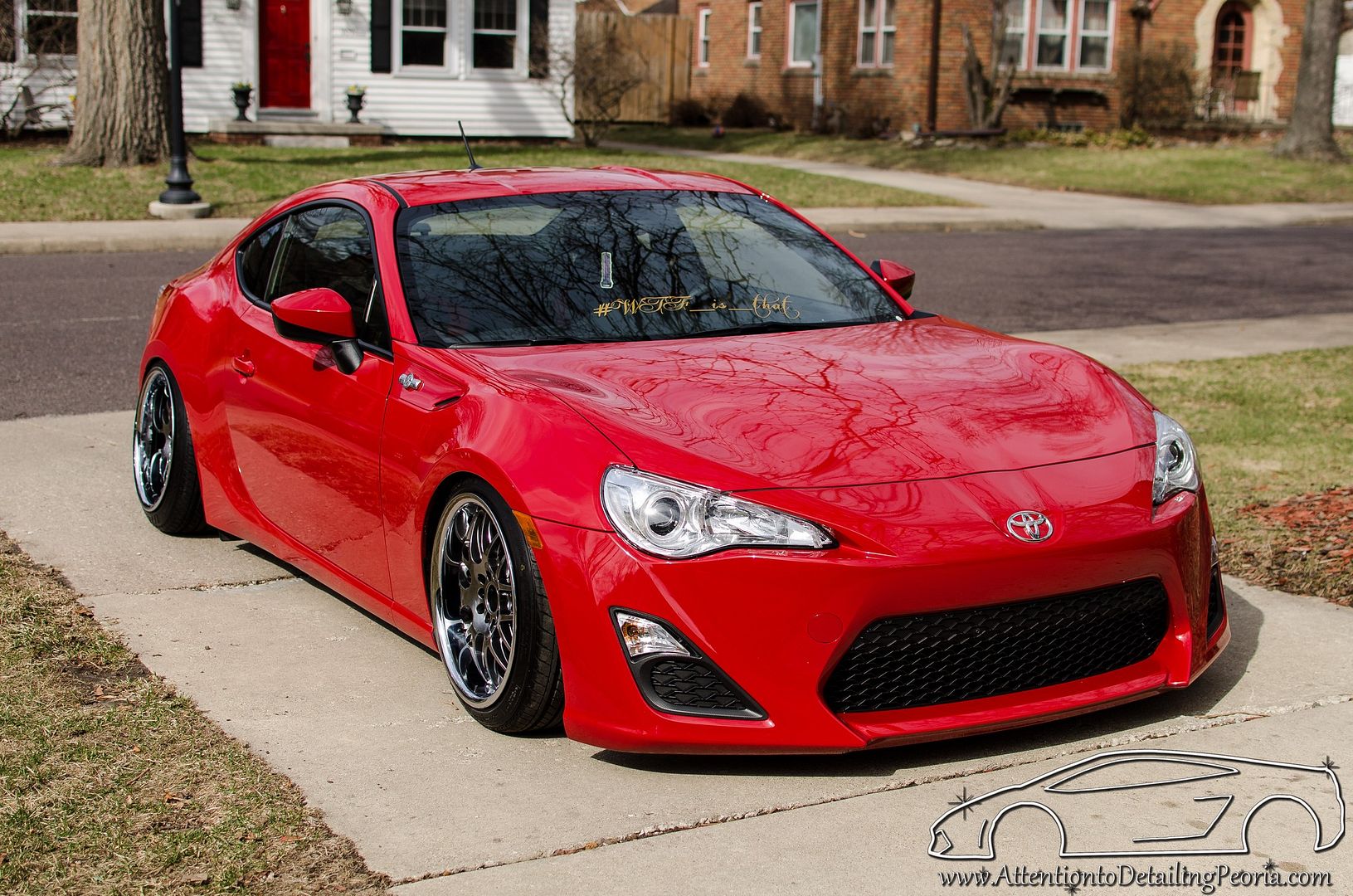

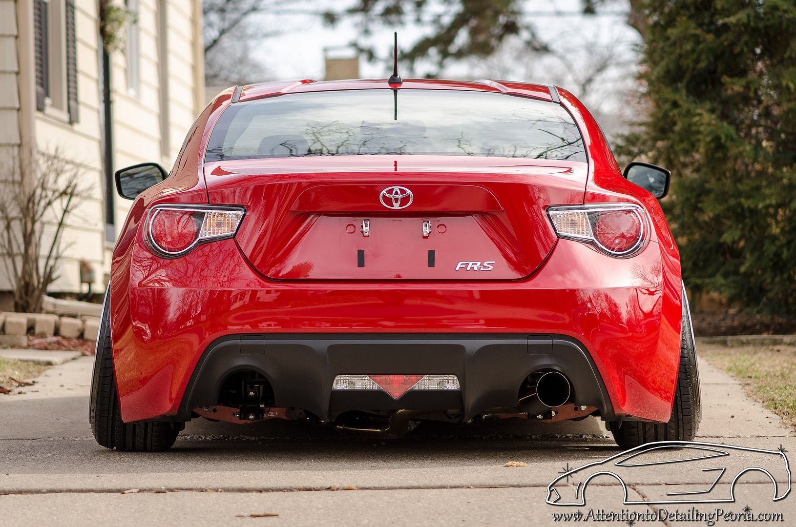

After

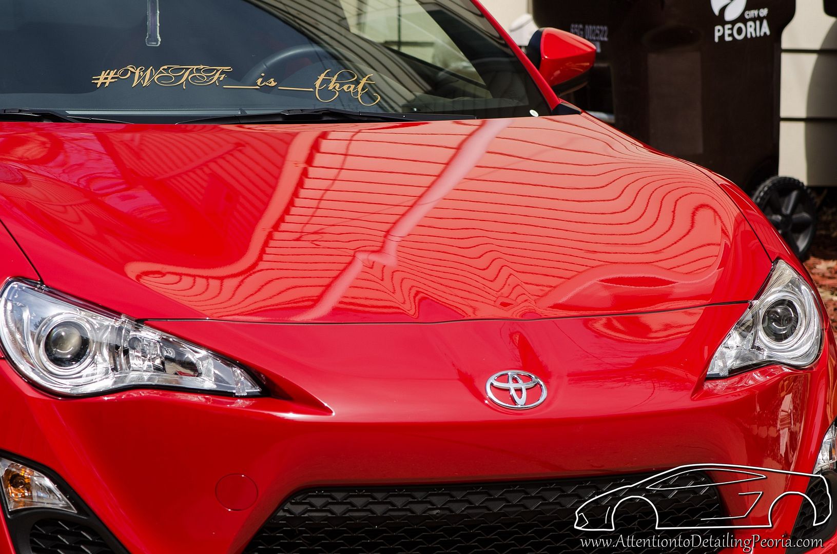

The shine was a mile deep!
The red really popped, and the gloss was incredible
The paint looked dripping wet

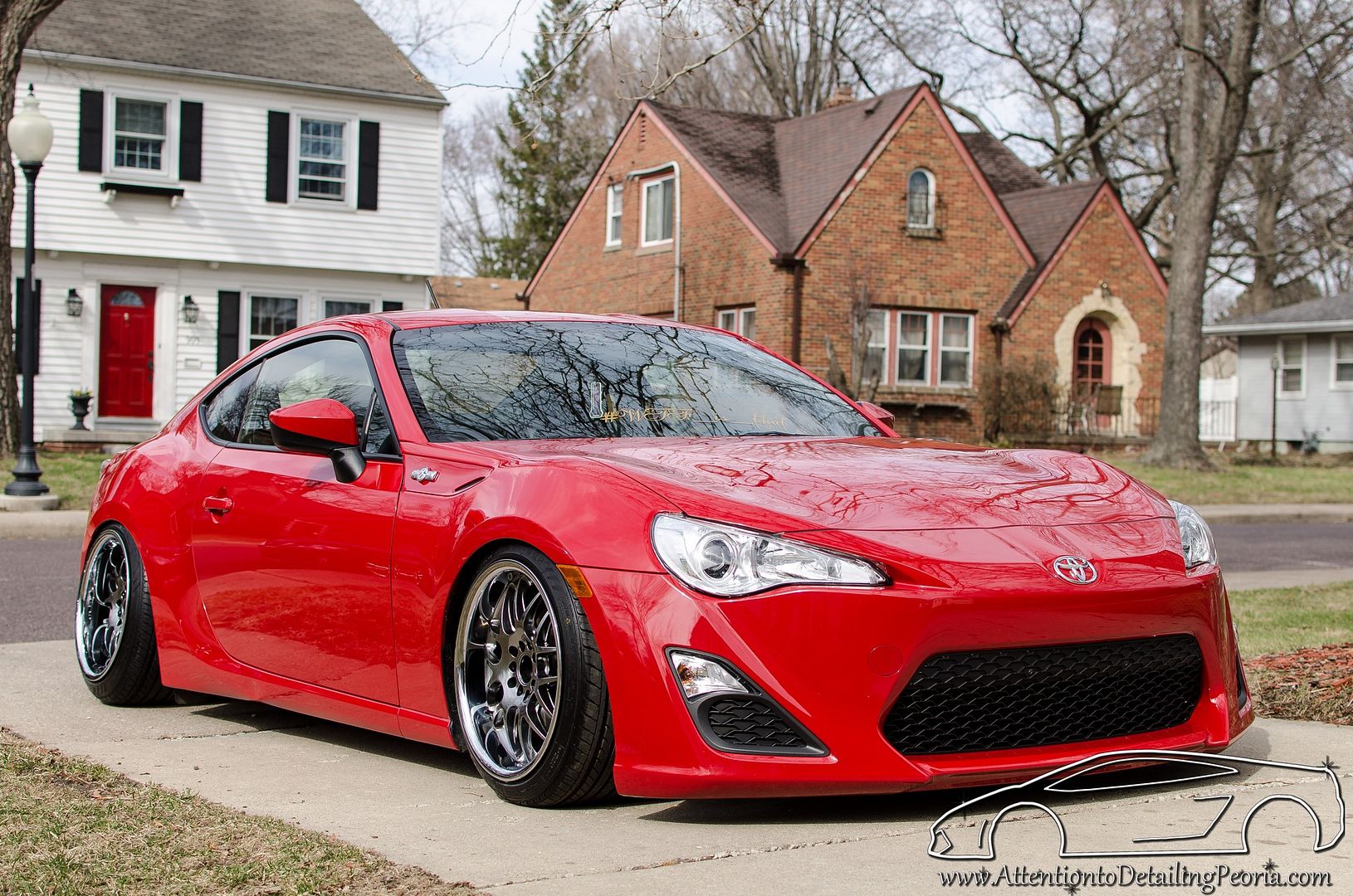

Deep & red!

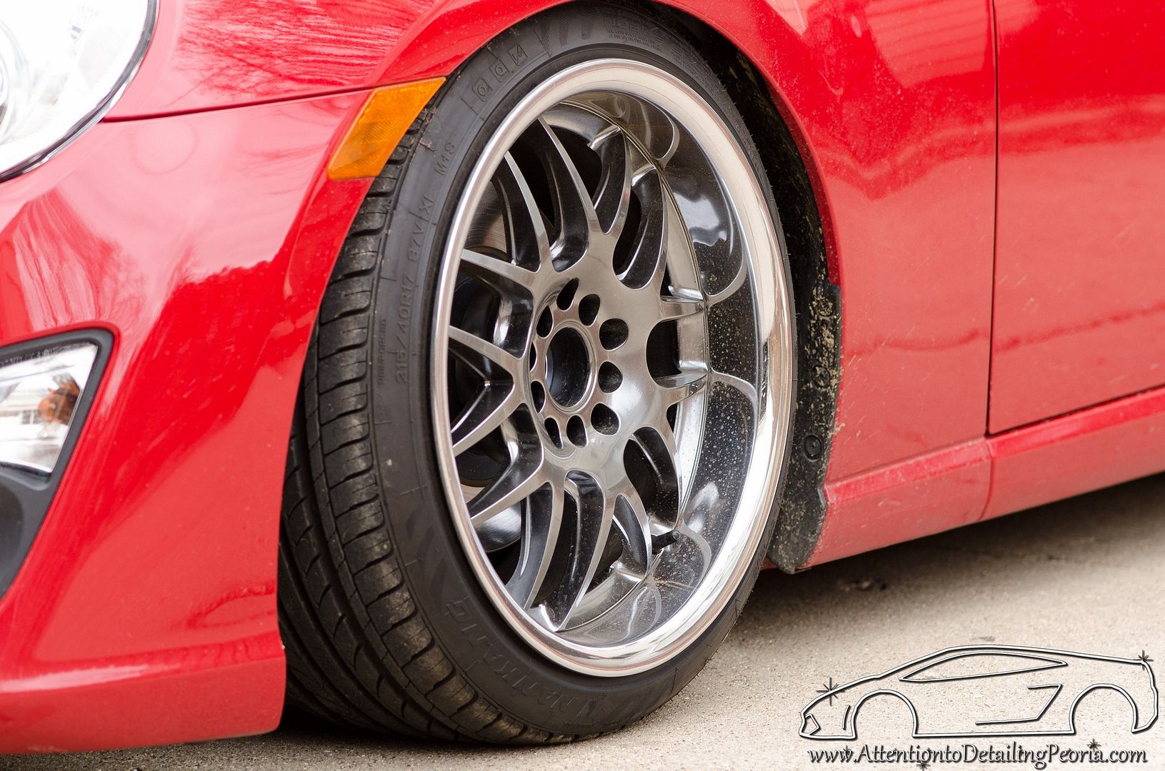

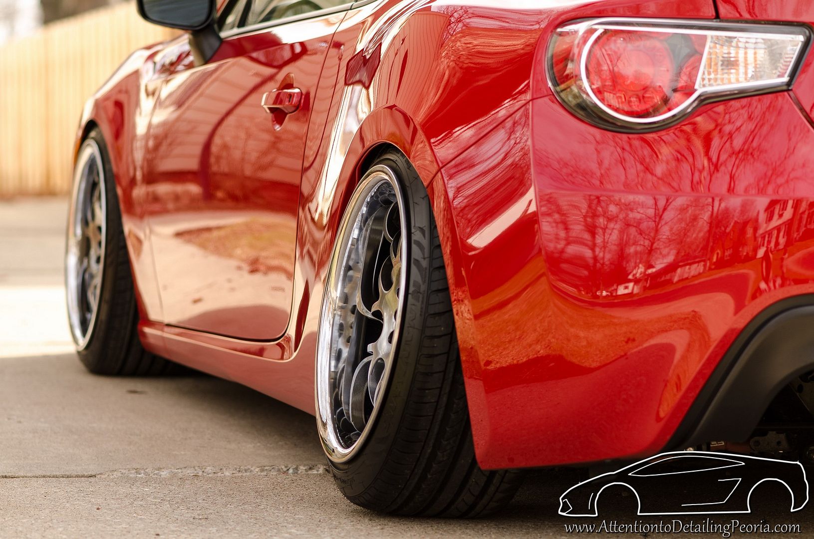

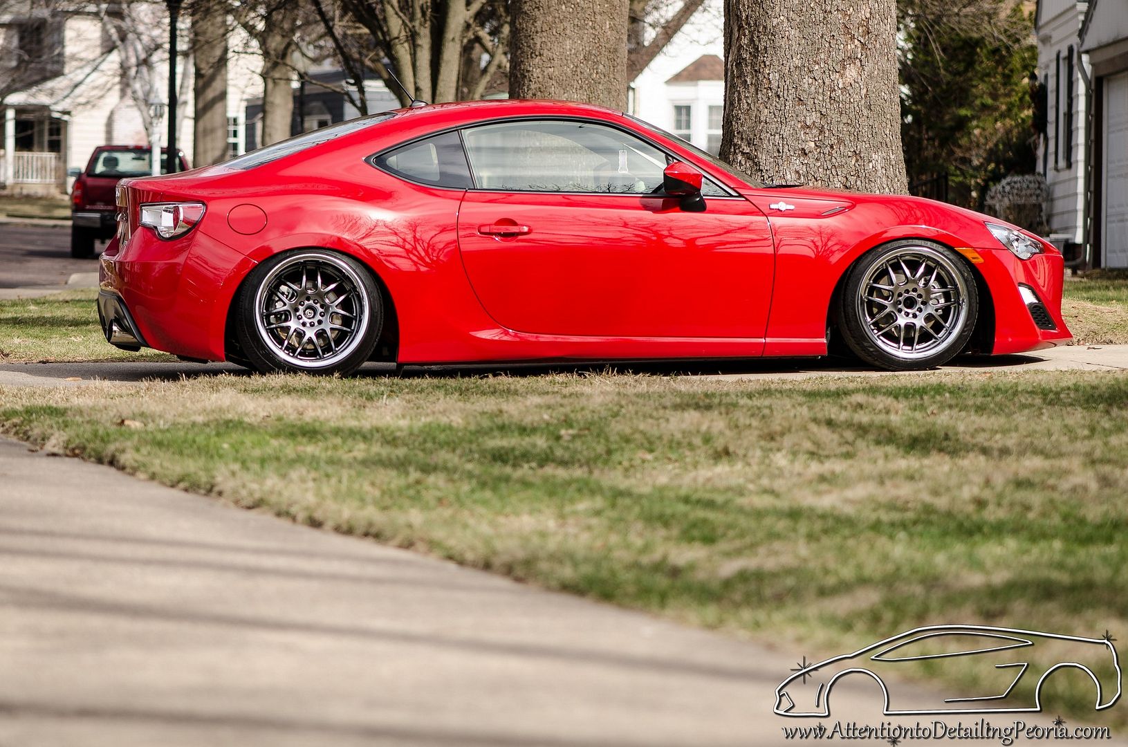

Wheels cleaned up nicely
low enough?
