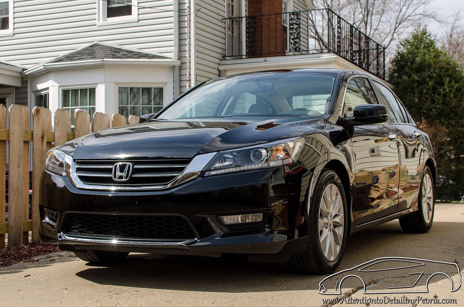

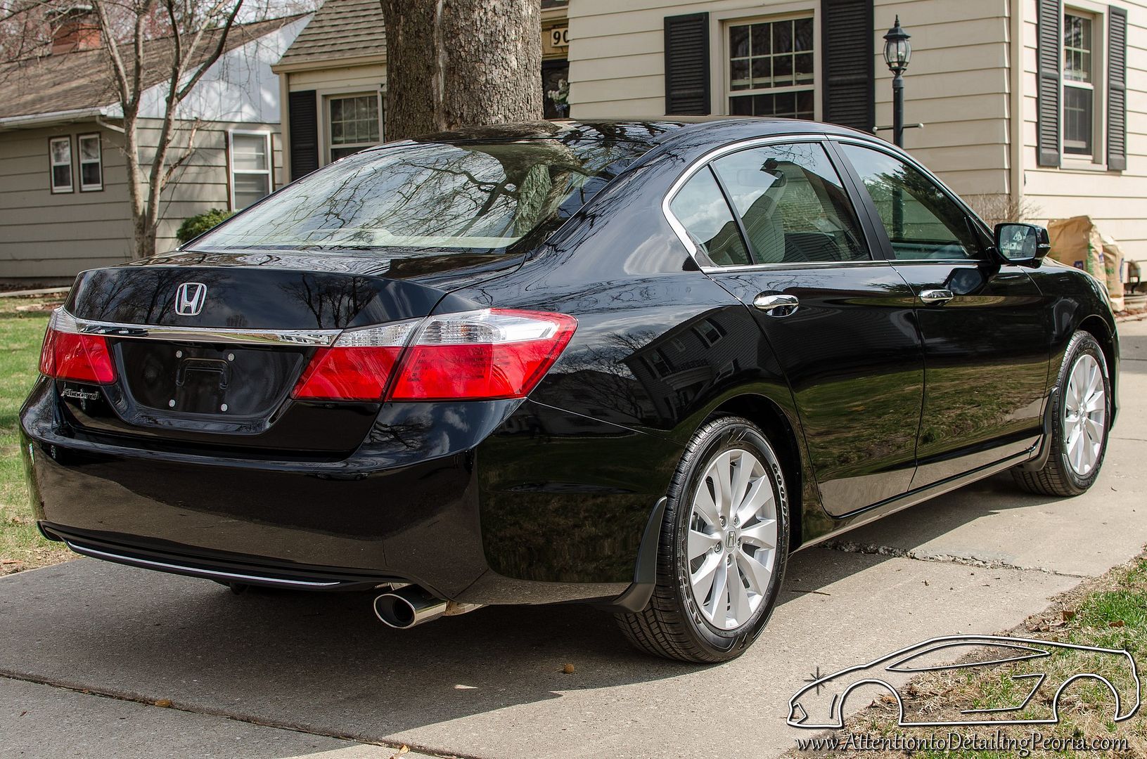

The owner's of this vehicle contacted me last year because they were anticipating purchasing a new vehicle this Spring. We setup an appointment well ahead of time as they planned on purchasing one in mid April. They brought their brand new (picked it up 1 week prior to appointment) 2014 Accord to me for a through new car prep service since I had advised them to politely decline any dealer washing or detailing. The car was carefully cleaned, decontaminated, polished, and protected and looked fantastic afterwards.

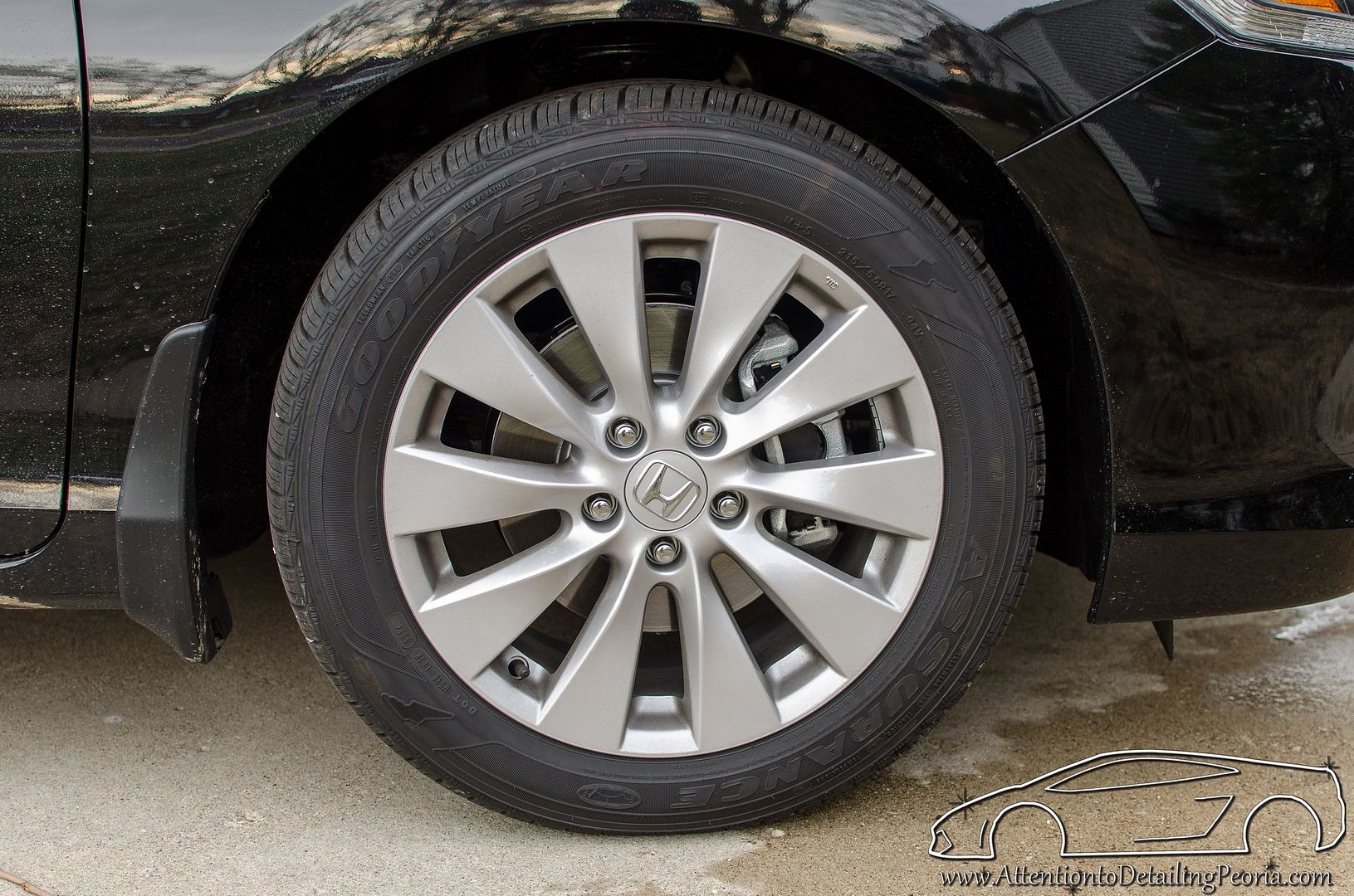

Wheels: Meguiar's D103 (10:1) with various tools

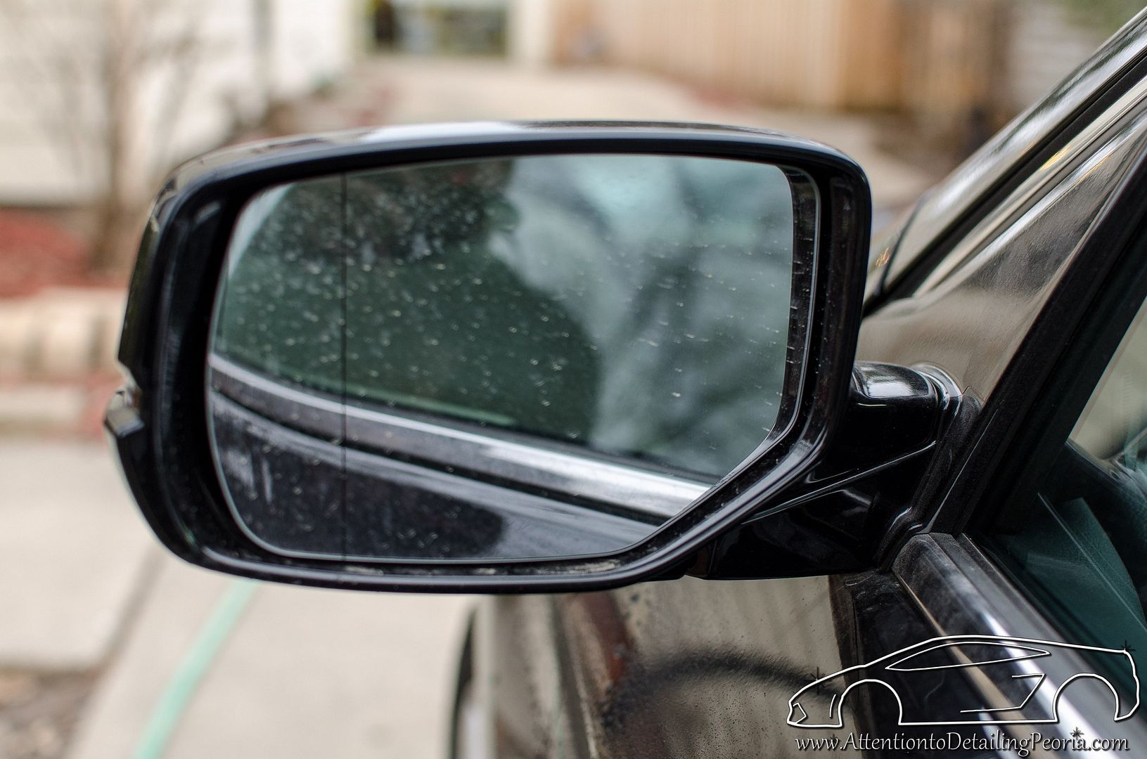

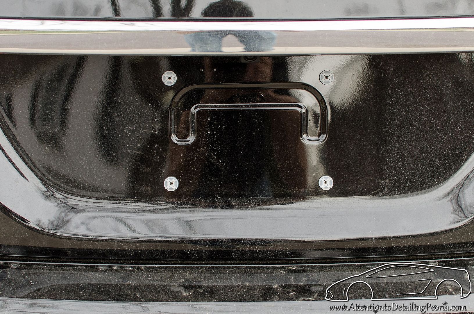

The vehicle arrived with typical dirt and water spots from daily driving.

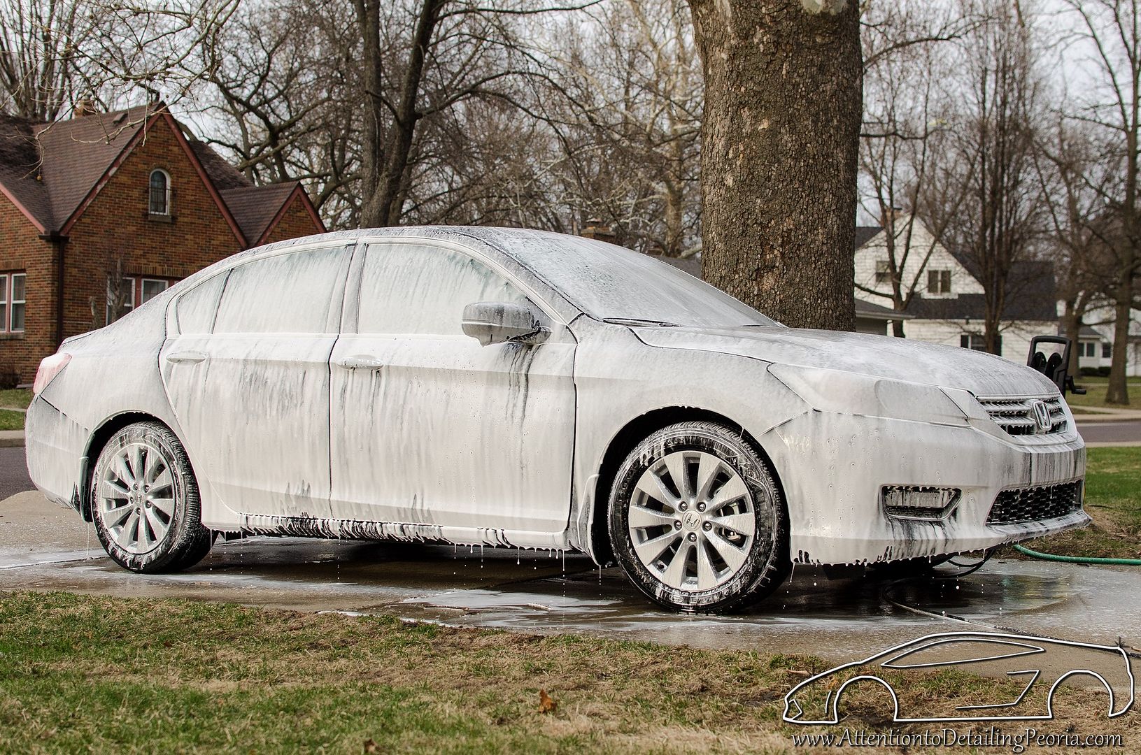

After cleaning the tires & wheels, the vehicle was foamed, carefully washed, treated with IronX, rinsed and then pulled inside to begin claying.

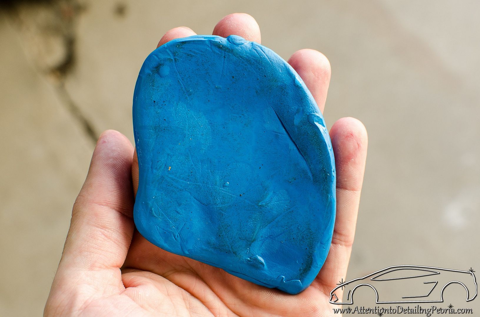

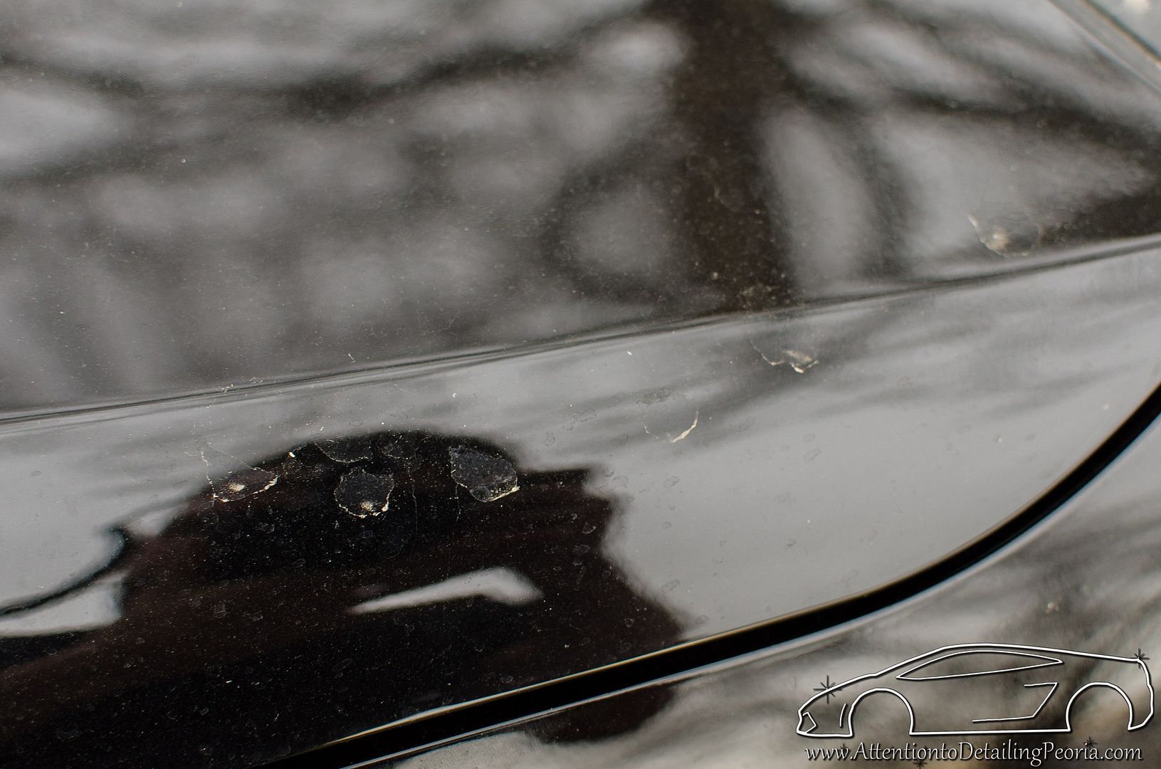

While this clay does not look nearly as bad as most used vehicles, you can easily see the contamination that was being removed. Even brand new cars need a thorough detail to really bring out their best appearance.

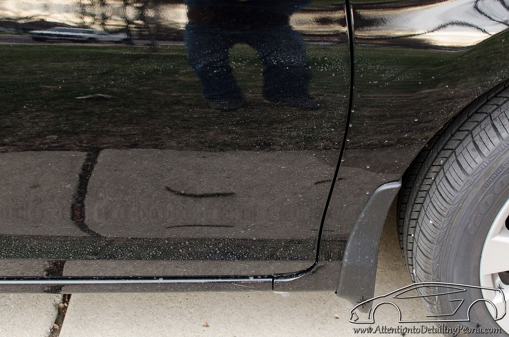

Checking for a perfect finish in the sunlight (don't mind the dust... it is pollen season already ).

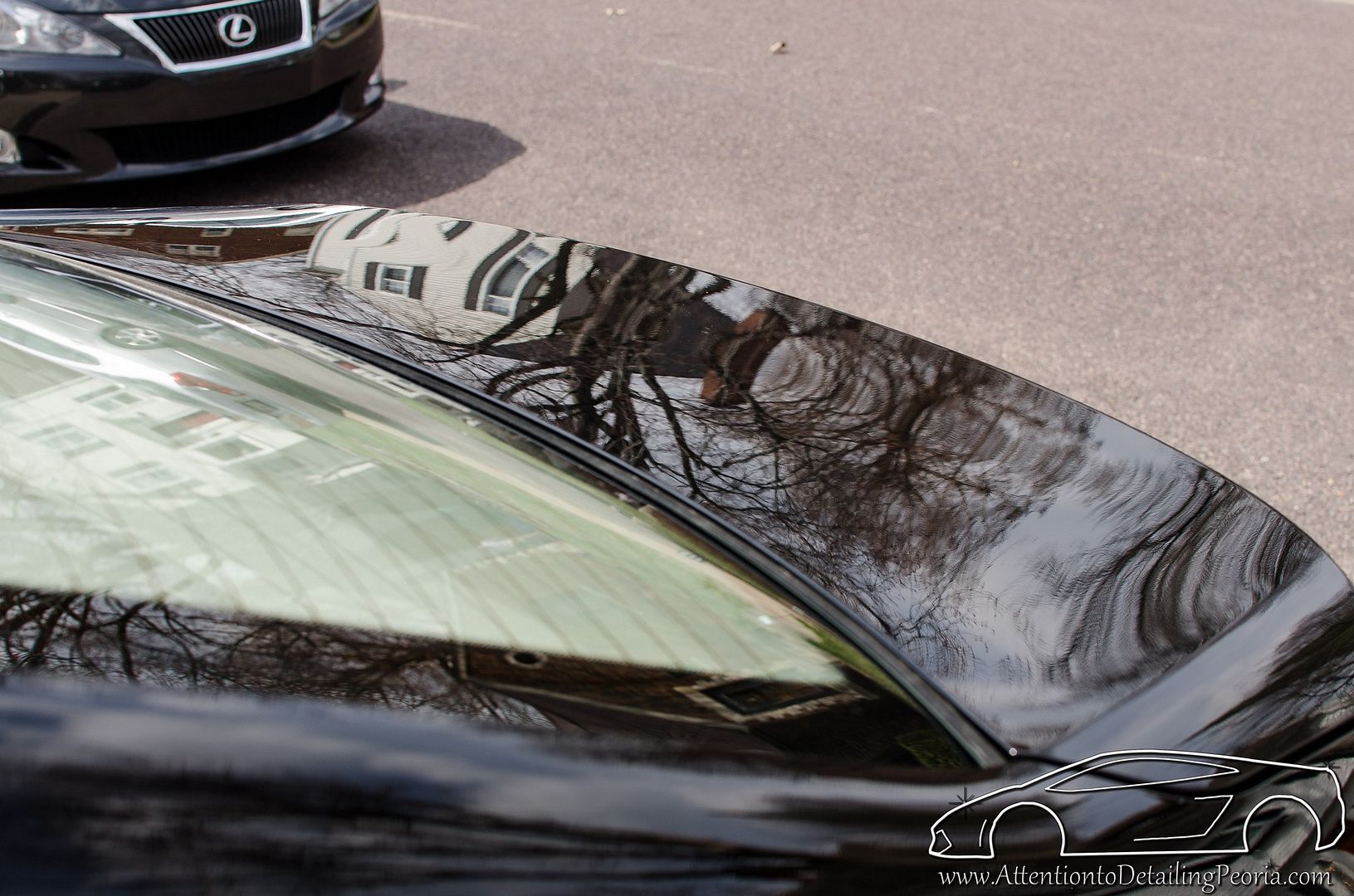

Looking good after polishing.

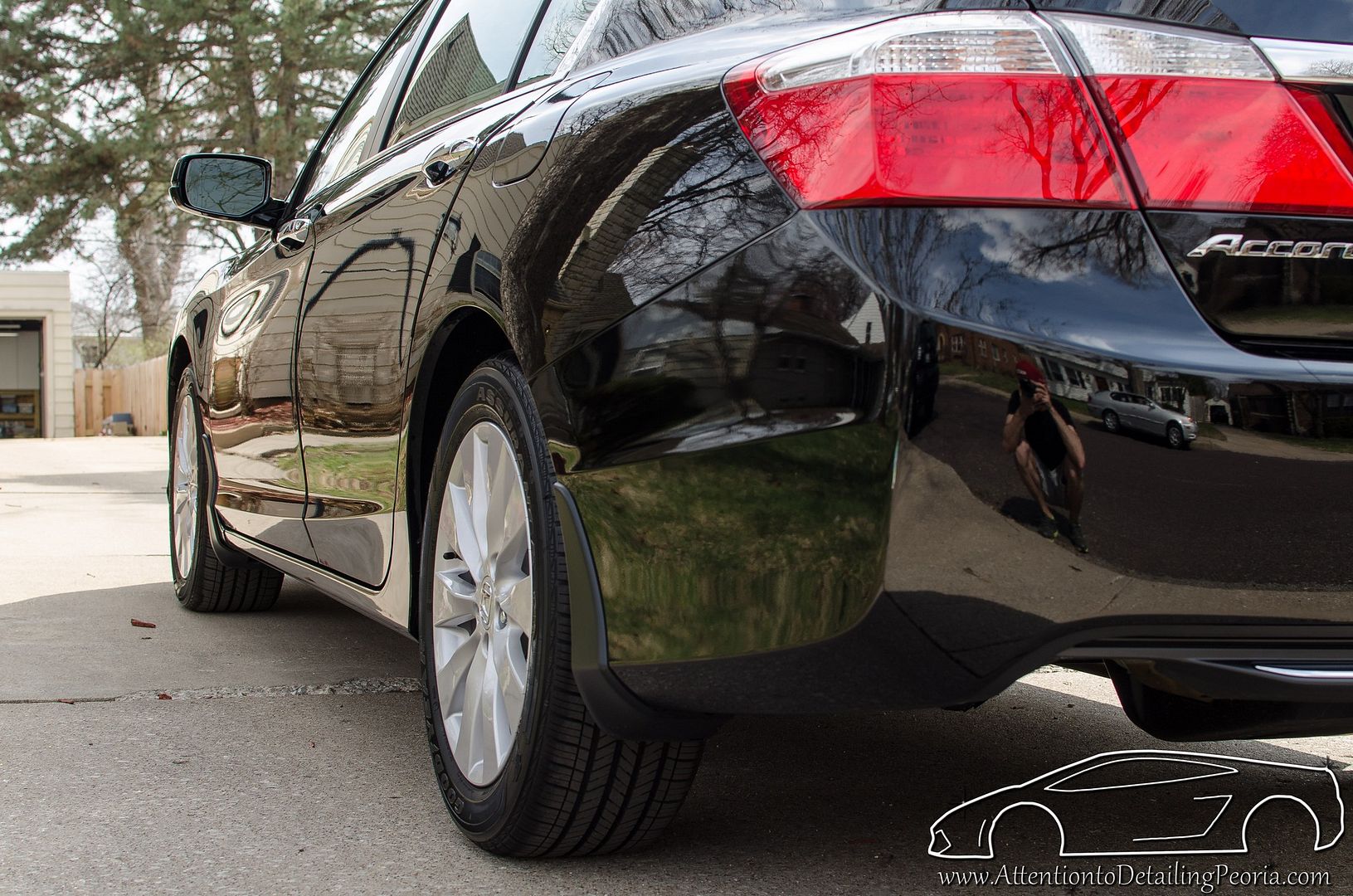

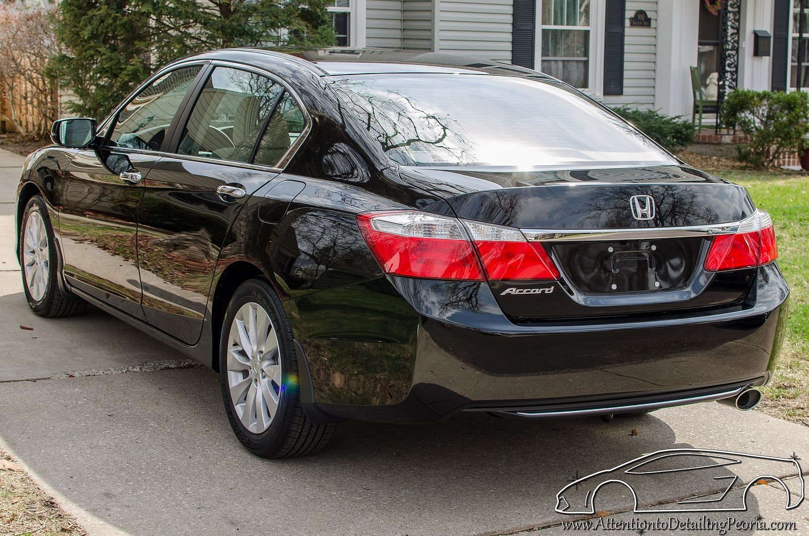

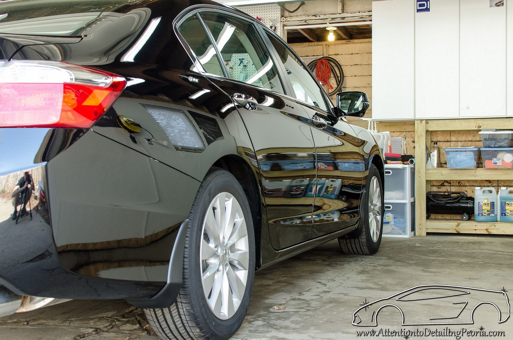

CQuartz UK was applied to provide years of durable protection, incredible shine, and a very deep, rich looking paint.

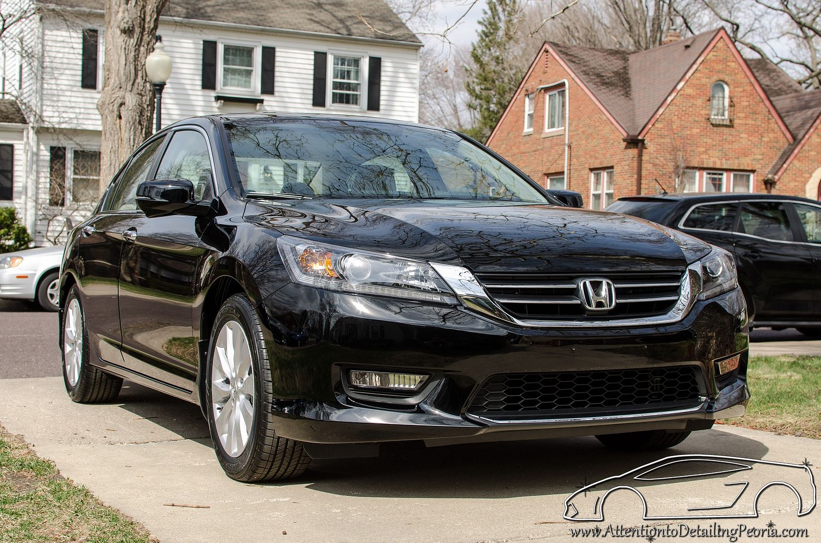

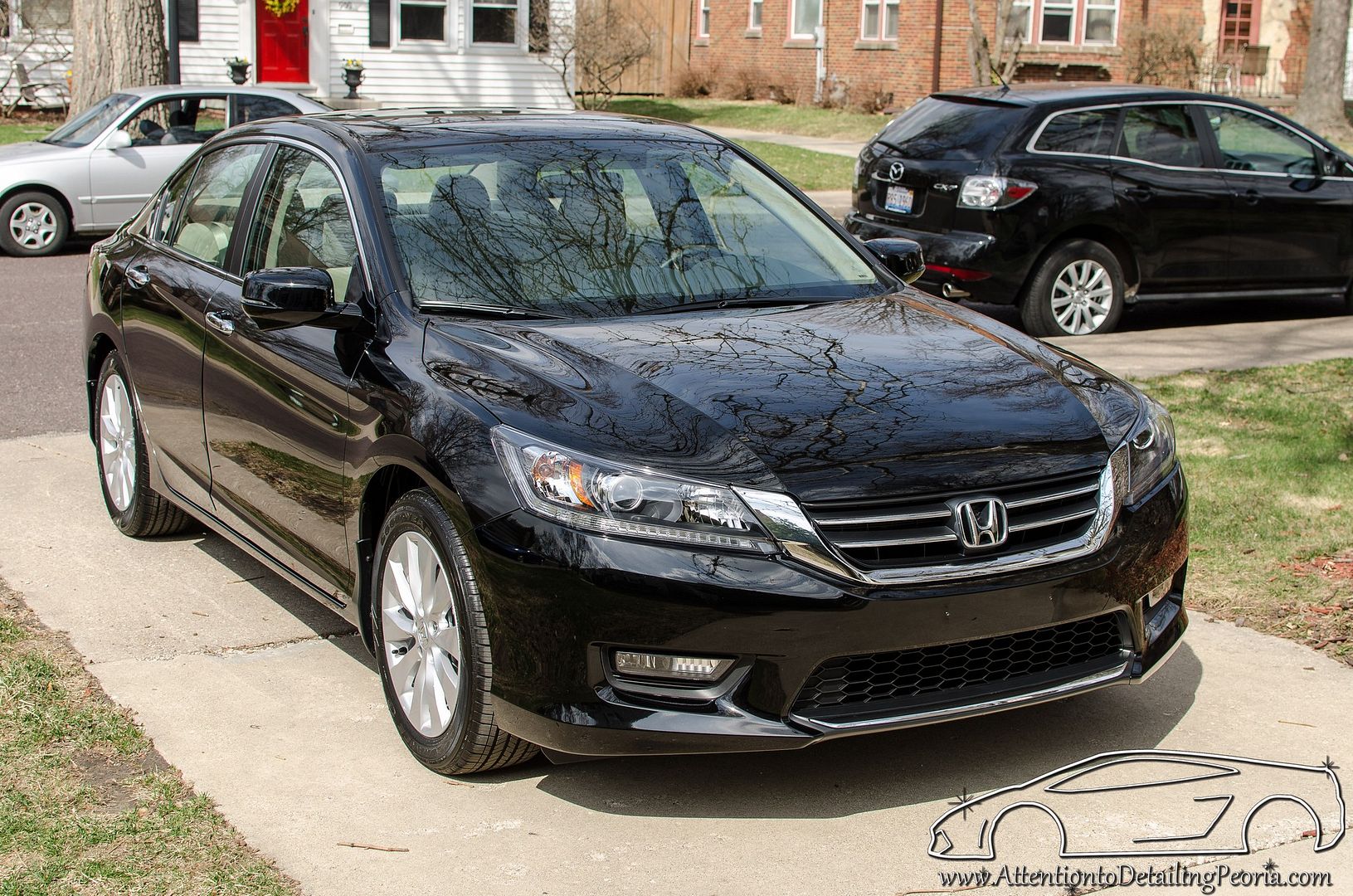

The owner's weren't sure their brand new car needed "all this work", but when they picked it up they were amazed at how good it looked and very pleased with their decision to have the vehicle properly detailed.
CQuartz UK has a noticeably "richening effect" on most paint colors. It makes dark colors even darker, and the gloss is stunning.
