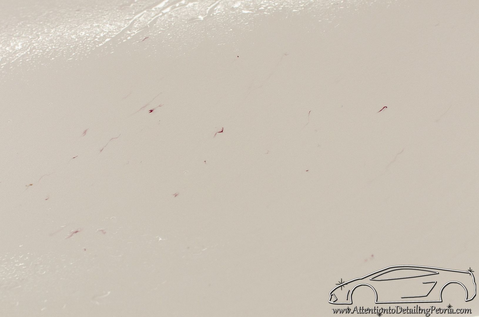

Even though the car was brand new, there was still contamination that had bonded to the surface. Iron X was used to remove the iron contaminates. You can see the iron x turns purple as it reacts with iron particles. This is then carefully washed away to remove it from the surface.

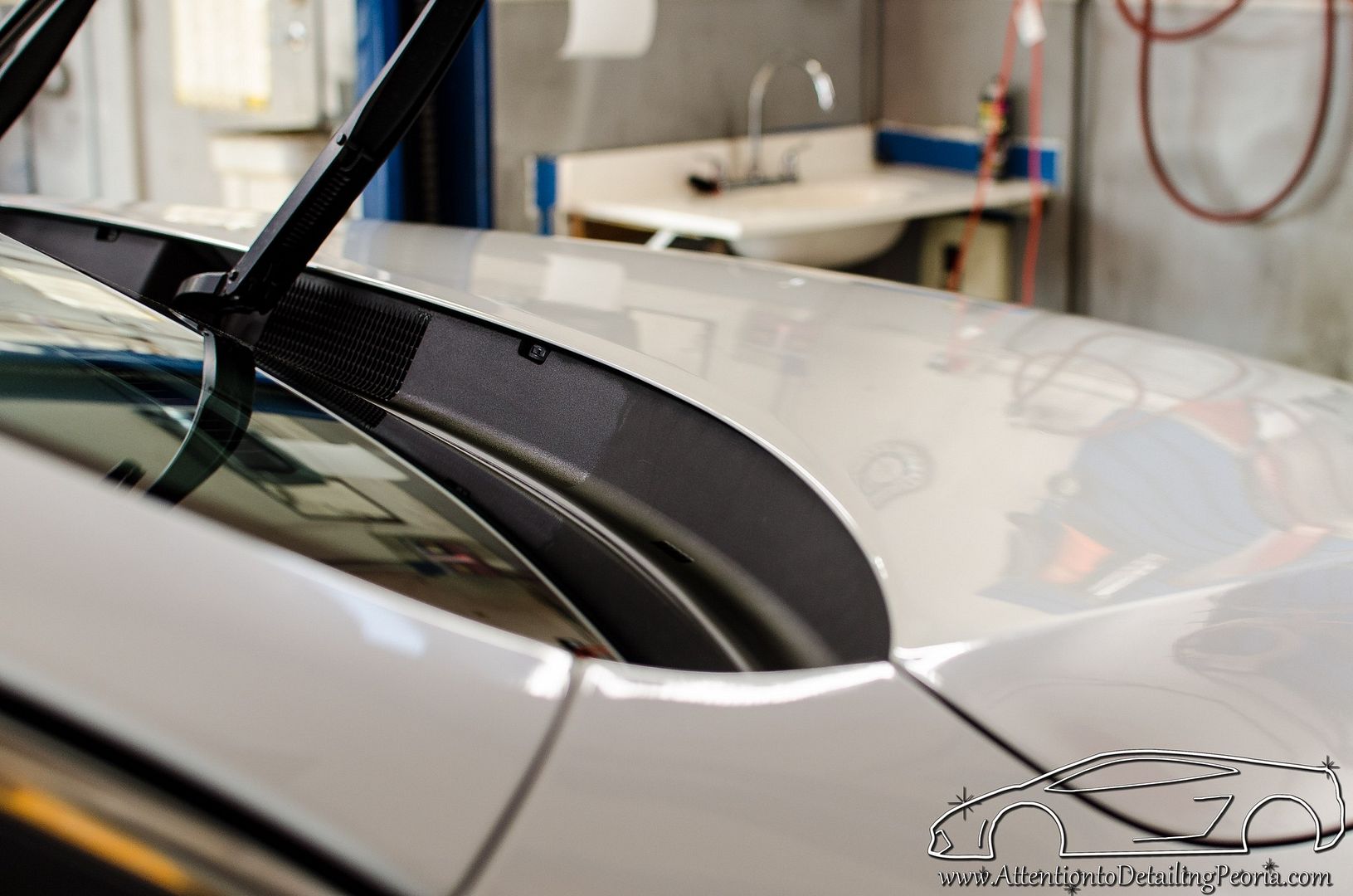

Even new cars can benefit from a trim coating. You can see the left hand side of the wiper cowl has been treated with CQuartz DLUX and has a slight sheen to it which looks great once it has fully dried.

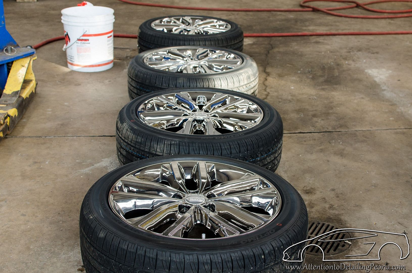

The wheels were removed for a proper cleaning. The barrels were cleaned and then coated for maximum protection and to make future cleaning much easier.
The faces of the wheels were then hand polished, wiped down with eraser, and then coated.

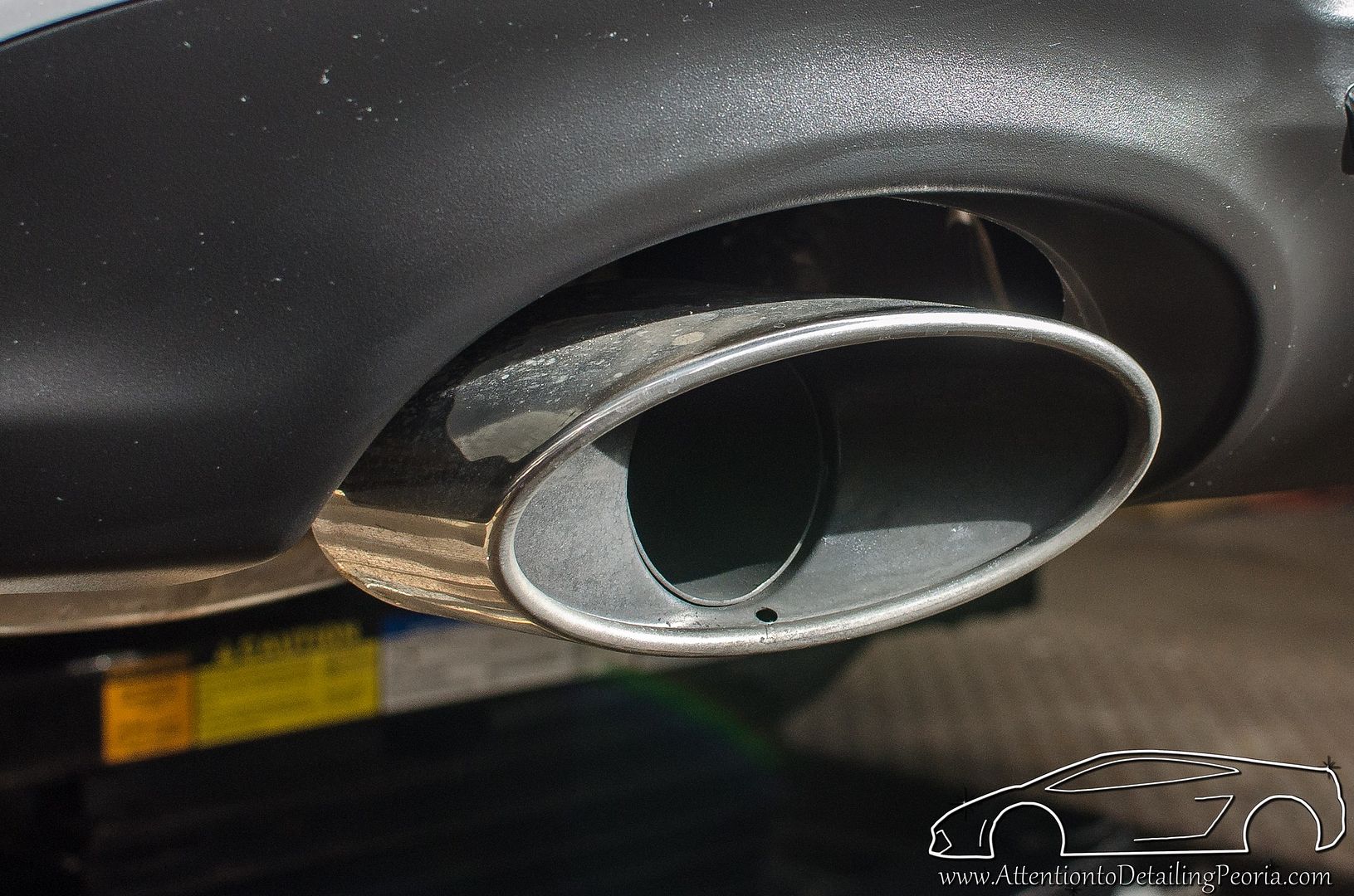

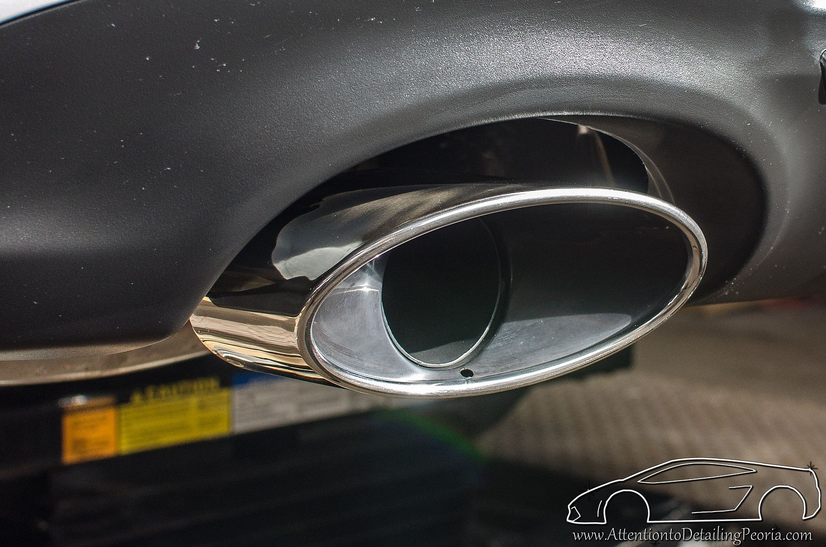

As always, the exhaust tips were polished. This is before polishing.
After polishing they looked great.

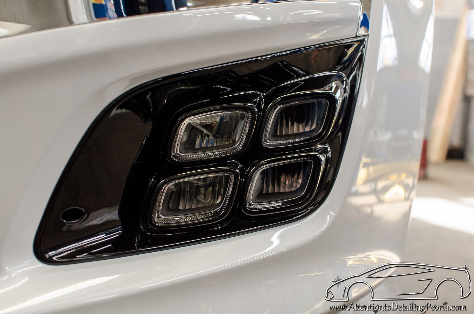

The fog lights are very unique on this car. They were hand polished and coated as well.

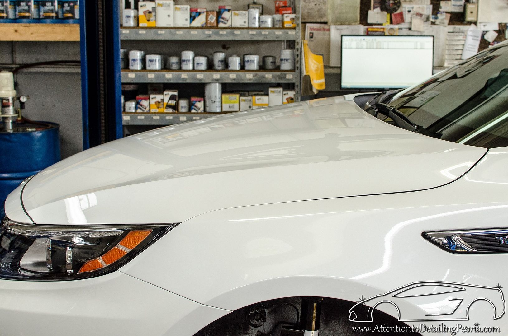

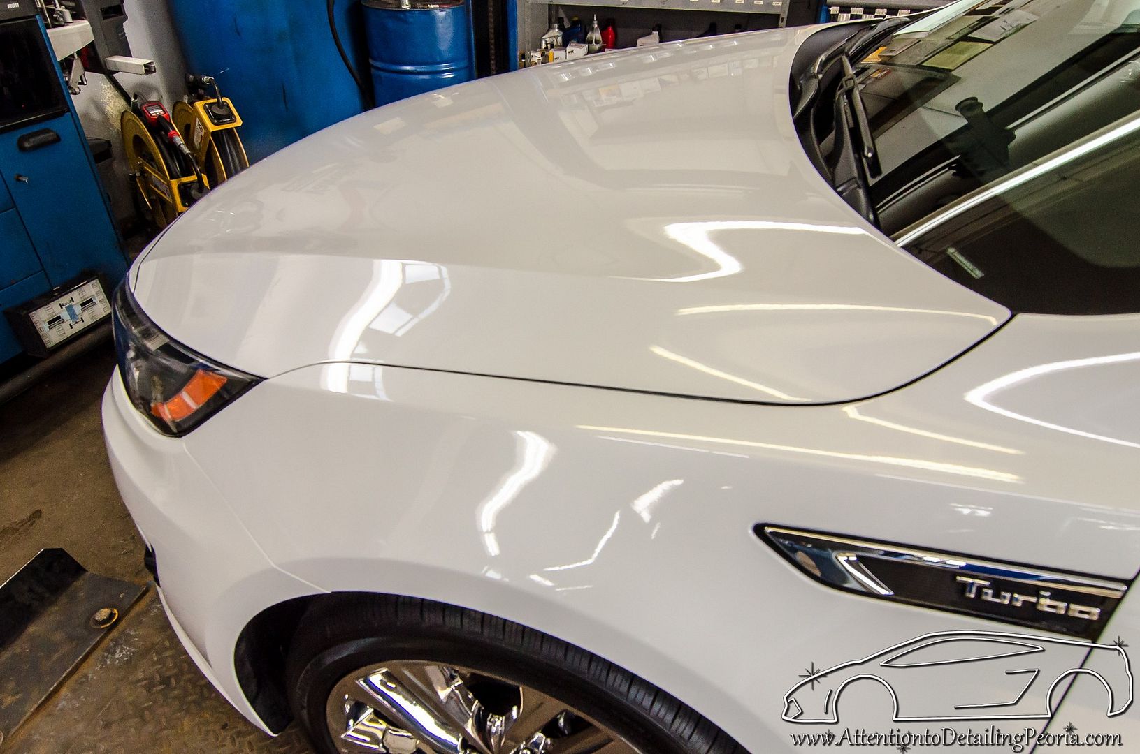

The white paint was nice and glossy. The paint looked phenomenal in the sun, too.
Even white paint can produce dramatic reflections.

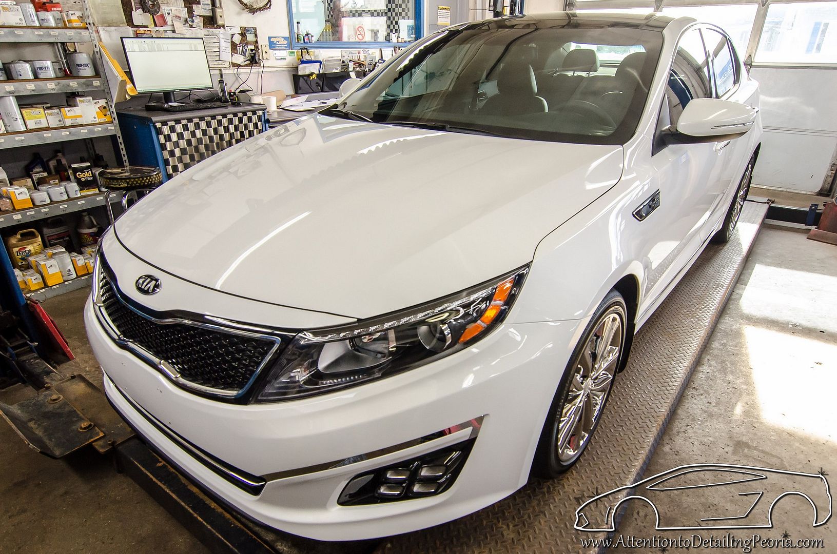

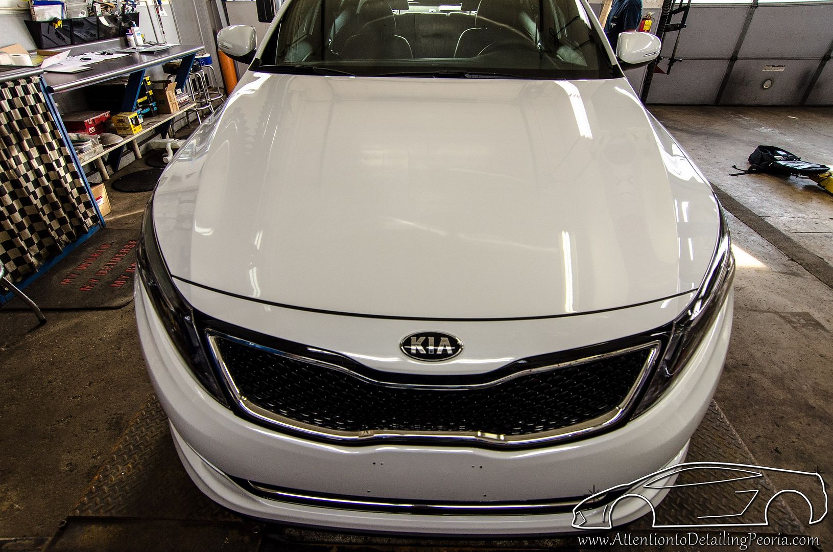

Car was bright and white. It looked great!

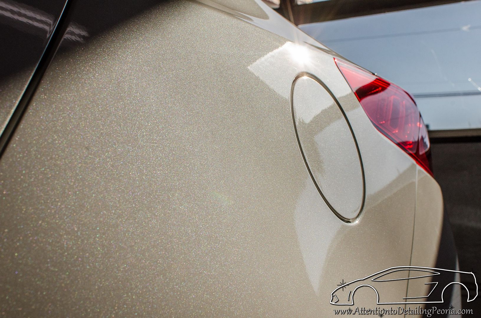

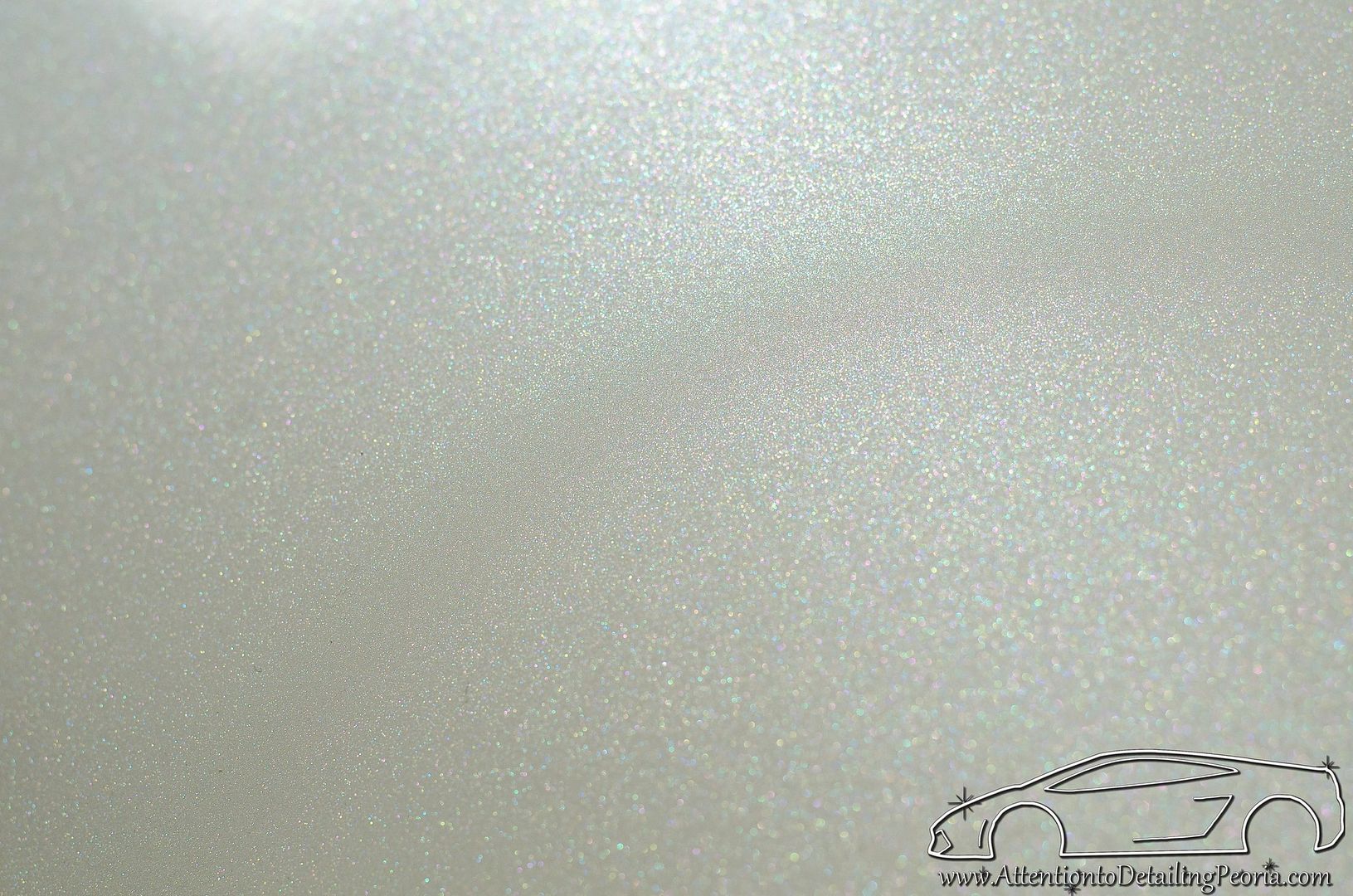

The metal flake in the paint was some of the best I have seen. There were hints of green, blue, & purple that really brought the white to life.
