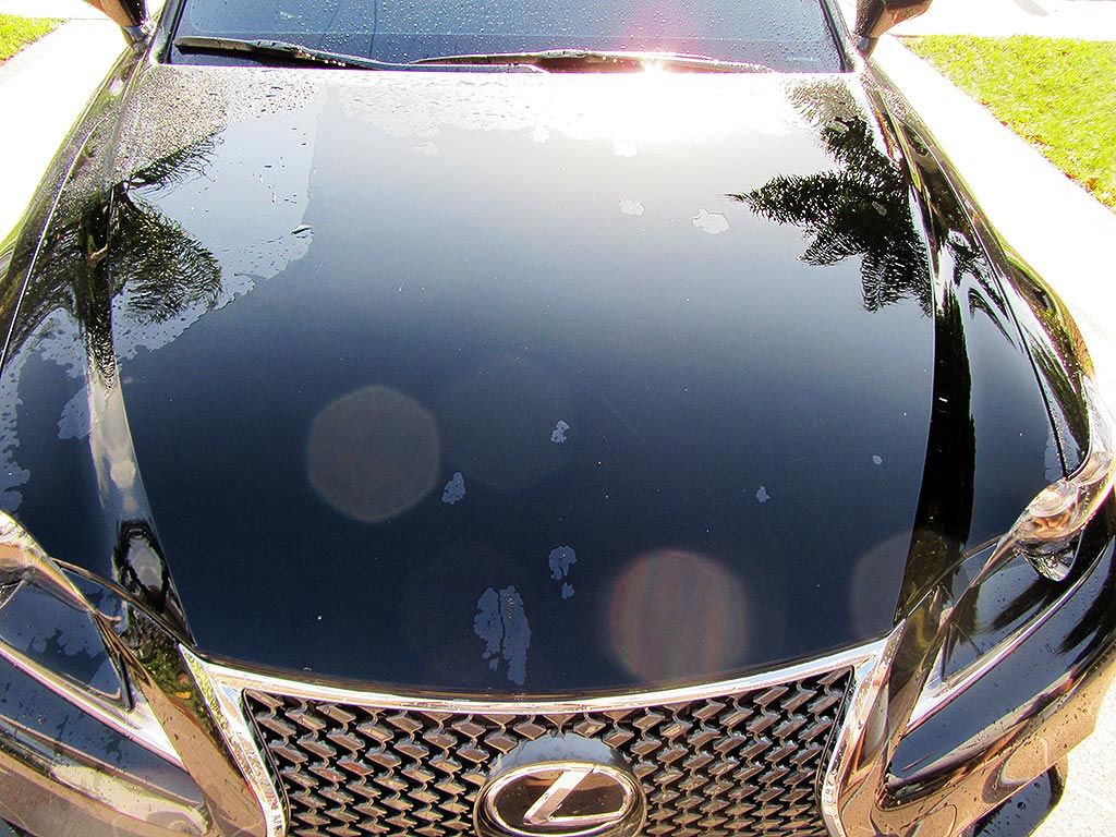

The paint was very flat when washed. Yes, the passenger corner was a "test spot"
It looked and behaved quite a bit different after it was polished.

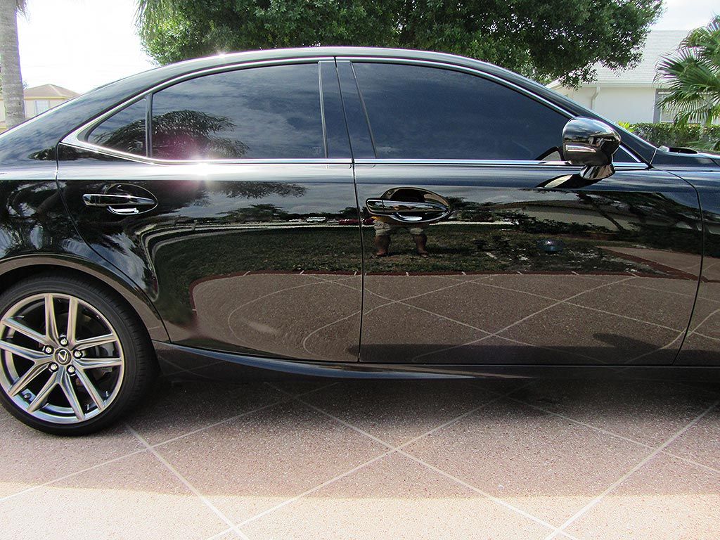

Side reflecto shot

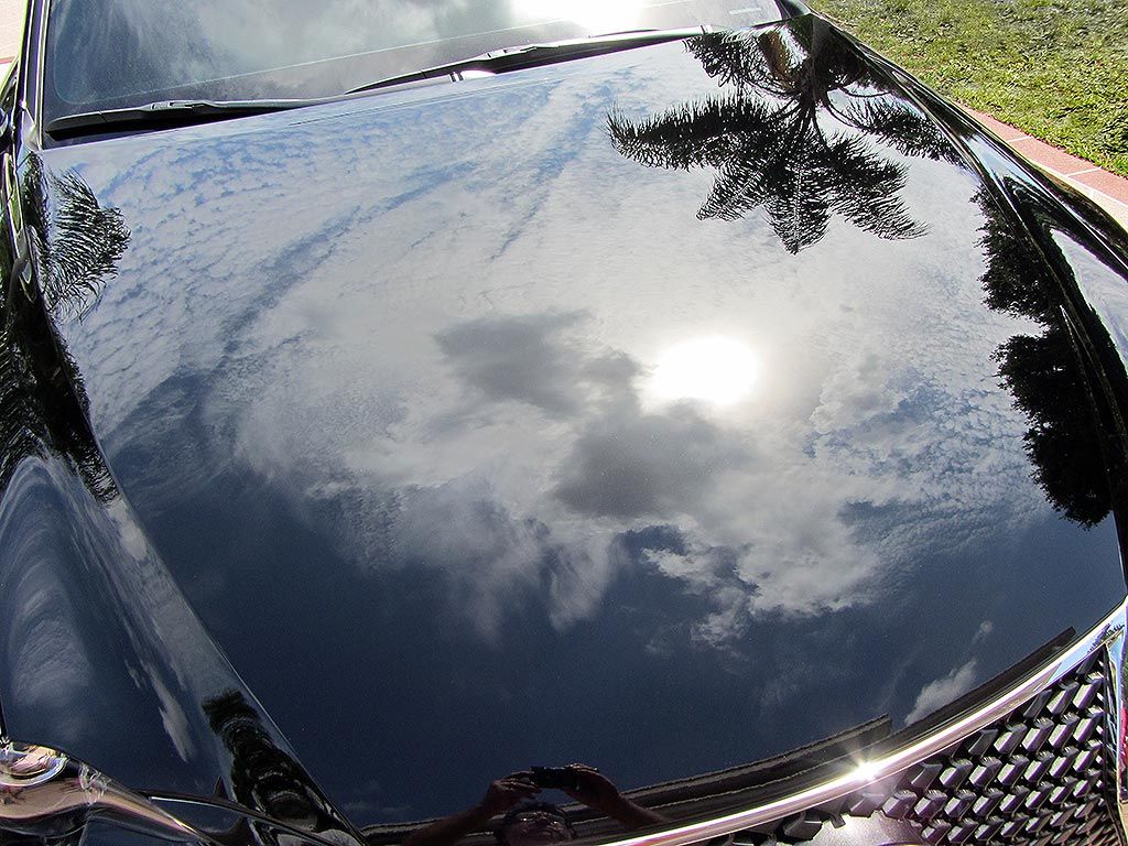

Hood Shot - Gotta love those clouds.

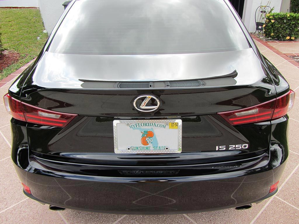

Trunk shot (After) It was loaded with swirls.
Side reflecto shot
