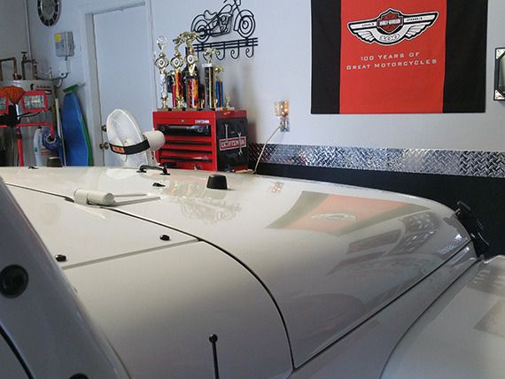

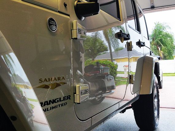

Plain simple white paint yet challenging to make sparkle and bright.
Wash: Two bucket method, Merino Wool Wash Mitt & Iron-X Snow soap.

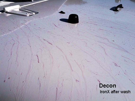

Decon: Nanoskin towel (Fine) with Optimum No Rinse (ONR) for clay lube.
Compound: Rupes 21 with 5" BP, 5" Carpro 5" Flash pad and Meguiars M101.
Polish: Rupes 21, 5" Backing Plate, 5" Carpro Gloss pad and Carpro Reflect.
Small Areas: Griots 6" polisher, Megs 3" Backing plate & 3" Carpro gloss pads.
LSP: CQuartz Dlux on all plastic & rubber trim. CQuartz FINEST on paint & wheels.
Additional Products Used:
Sonus Trim and Motor Kote
Iron X Paint & Wheels Decon
Shine Supply Trim Coat Black
CarPro Tire "Swipe" Applicator
Four Star Ultimate Tire Protectant Gel
Just a couple of pics. Short and sweet.
Thanks for looking...
