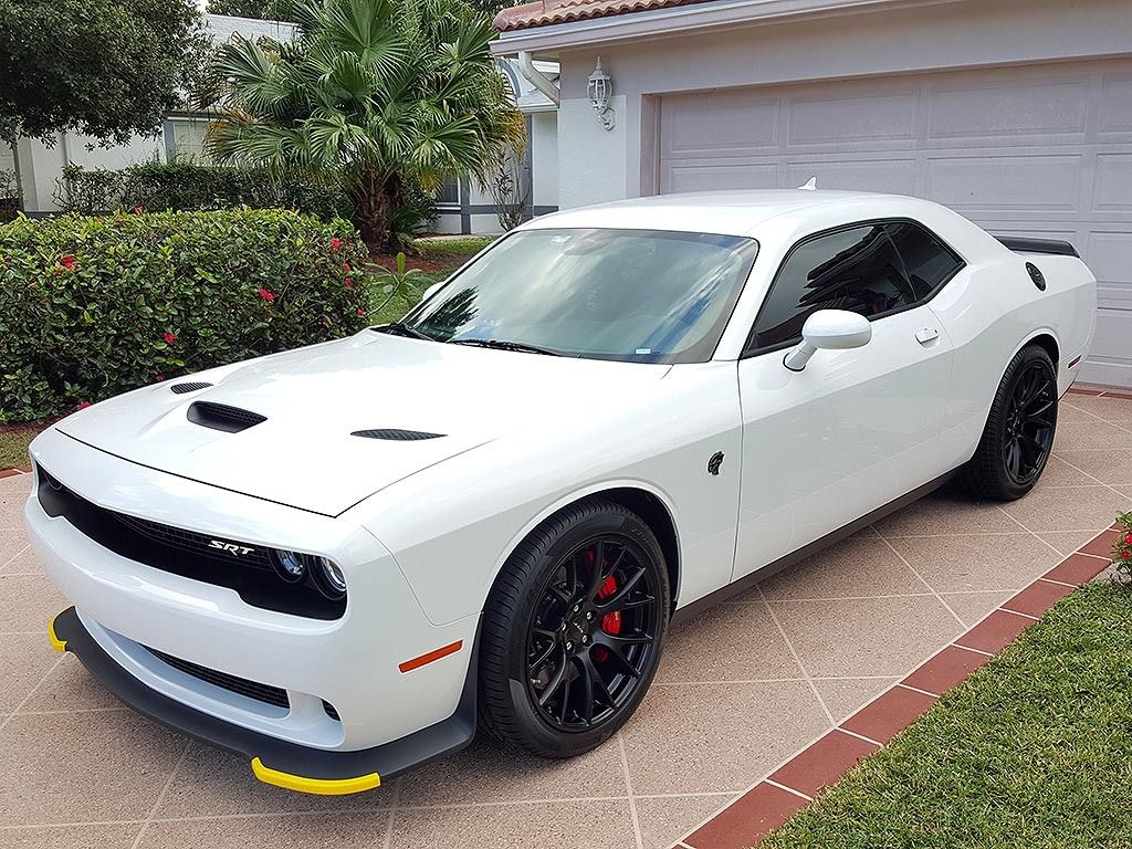

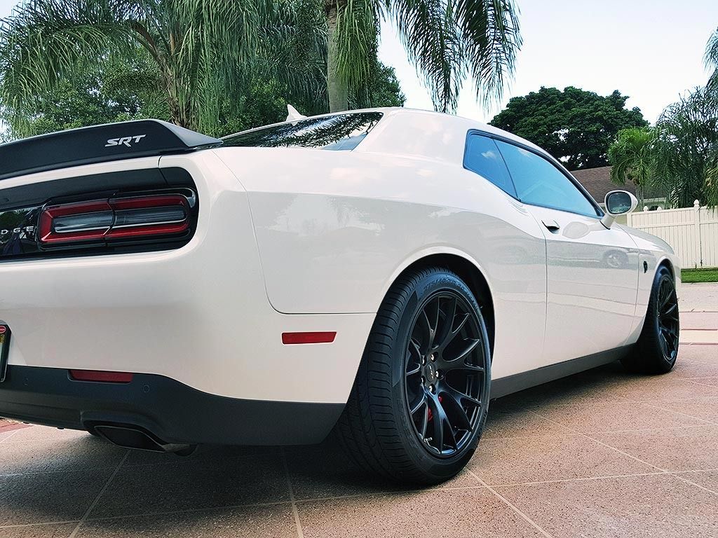

Brand new vehicle, minimal swirls, gloss enhancement...nice exhaust note!
Although a white vehicle, there were some minimal OEM or DISO swirl marks.
Lots of time spent "jeweling" the factory finish to kick the shine way up.

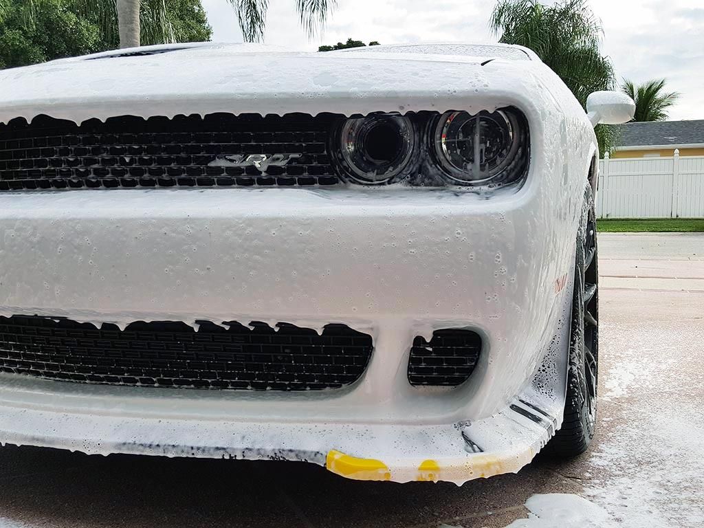

Foam Soak: IronX Snow Soap with Carpro Snow Foam Cannon. Presoak & rinse
Wash: TBM with IronX Snow Soap , MFM Incredimitt, Blow Dry & MFM Dry-Me-Crazy
Chemical Decon: CarPro Iron X and Tar X massaged with small sponge wax applicators
Mechanical Decon: Nanoskin Auto-Scrub Speedy Prep Towel (FINE) with ONR clay lube
Paint Correction: Megs M205 & DMF5 Microfiber Finishing Discs w/Rupes 21 & GG DA
Paint Polishing: Rupes 21 w5" BP, Griots 6" w/3" BP, CP Gloss Pads and Carpro Reflect
Prep Cleaning : Carpro Eraser and BOA towels. Wipe down twice on all paint & wheels
Trim Protection: CQuartz Dlux Plastic & Rubber Coating (except front bottom scoop)
Protection: Two thick coats of CQuartz FINEST on paint and wheel inside & surface
This inside right (headlight) is actually an air intake

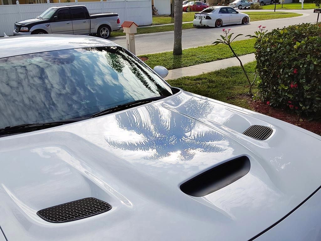

The obligatory "Merlin" palm tree hood shot.
IMHO the brightness, clarity and gloss was kicked way up.

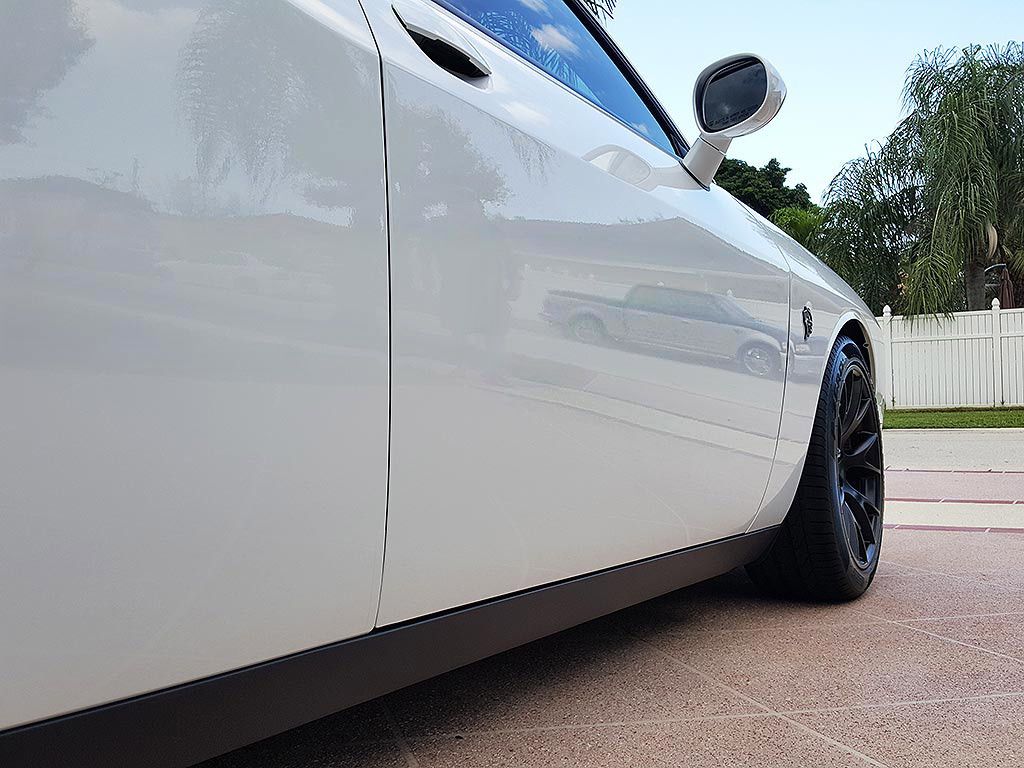

Can you say White? In the bright sunlight I started going snowblind.
Gotta love the CP Reflect
