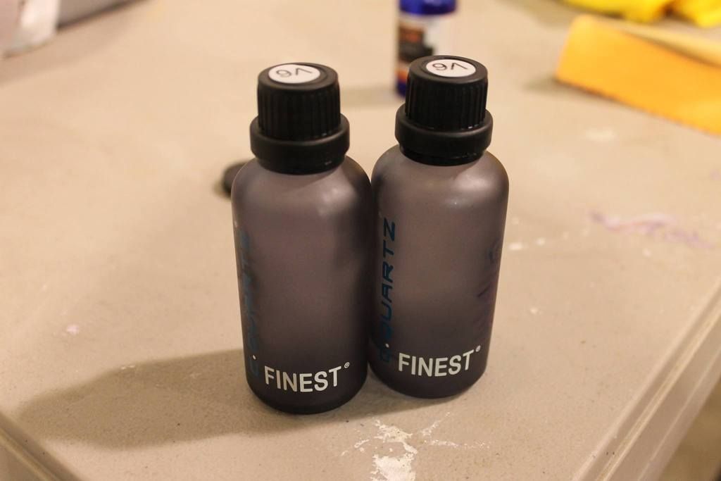

100ML of FINEST used!!

Two bottles Doc!! We were basically going for as many coats as I could pull. The owner stayed thru the process to determine per coat usage. We were at about 17.5 ML per coat and he was impressed with the consistency of each application.
I told Corey that after two coats your getting a noticeable change. After three it goes up and then after four, it's stupid.
I think I may get this one shot professionally next week and really use the pictures.
The application was great, using Wes' technique thru to the end, except on the fourth coat I applied with circular hand motions and then leveled with long back and forth strokes.
