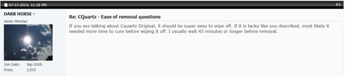

I just read a post from DARK HORSE back in 2014 on Autogeek forum that said to wait 45 minutes for removal. Then I read a post here that said No 45 minutes will make removal difficult. You only need to wait 2-5 minutes depending on Temp and Humidity.
So which is it?
I understand the formula changed but man its confusing.
