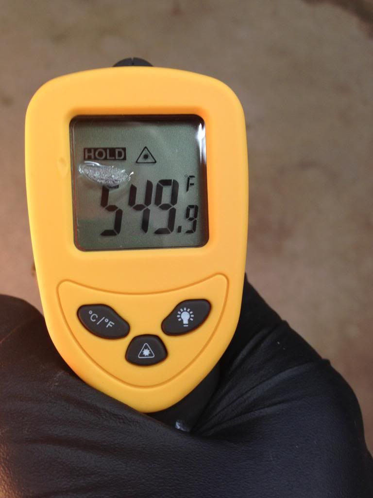

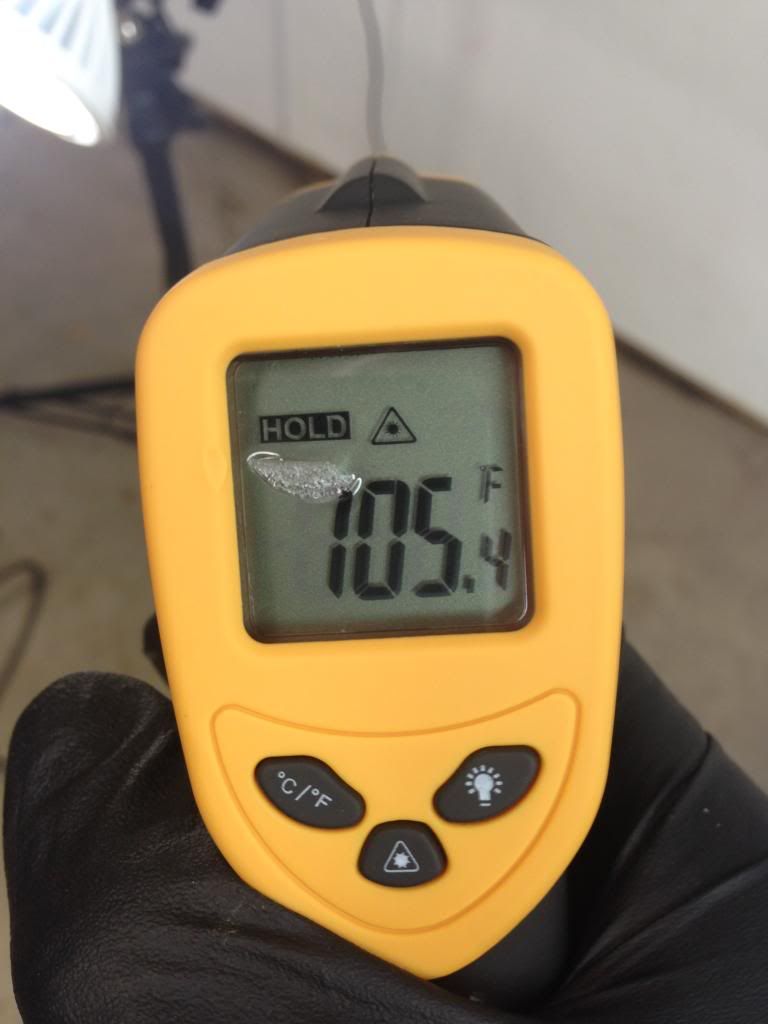

3) These bulbs definitely do put off some heat, but it is WAY less than the Halogens... I mean WAY less. Here are some temp. readings.
Halogen Case/Heat Sink:
LED Case/Heat Sink:
Halogen Face (stupid hot!):
LED Face (the face of the bulb was cooler than the rear casing.. this was noticeable by touching each area as well):
