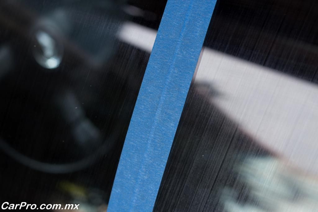

This is what it looks like from afar. Damage is pretty evident:
Closer inspection:

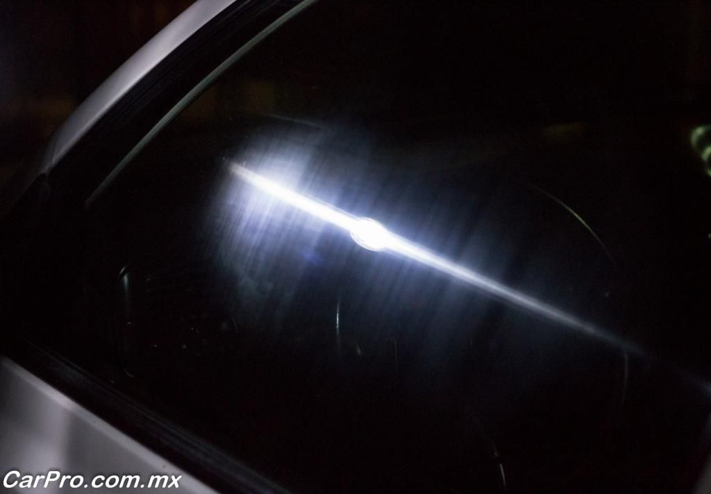

Under LED lights:

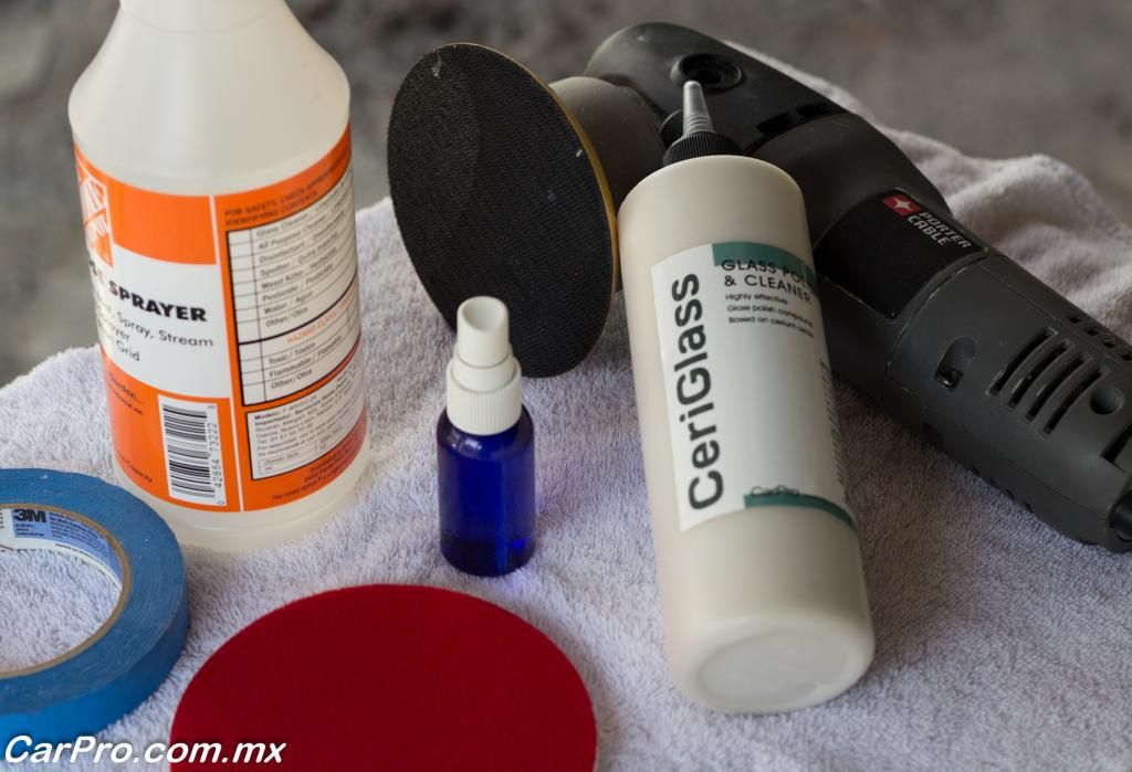

Tools used:
* PC 7424XP
* CarPro Ceriglass 500ml
* CarPro Glass rayon pads (3 and 5 inches)
* CarPro Clay kit (not pictured)
* OTC sprayers and water
* 3M painter tape
* LED and halogen lights

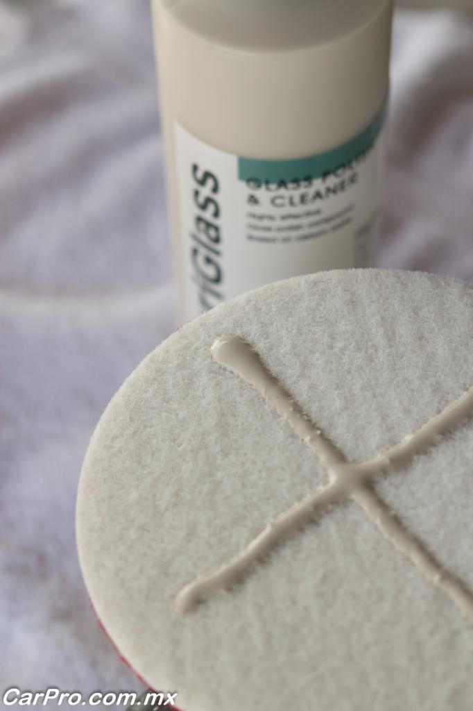

Once the glass was ready, i started priming the CarPro glass pad, applying an X in the center, using my finger to distribute the product evenly:
