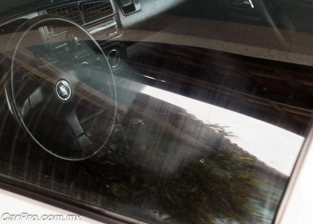

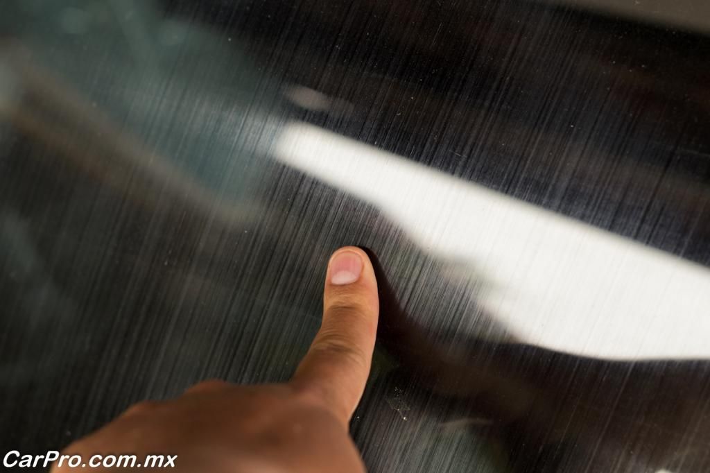

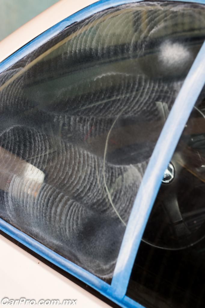

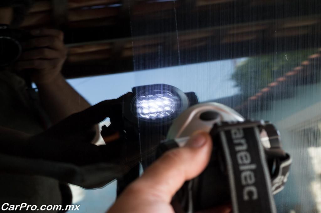

Give your DA a chance ... you might be surprised!
Finished down to near perfection, with Porter Cable's 7424XP DA :cool:
What speed you going at?
Speed was 5 and 6, with little to mid pressure on the PC.
