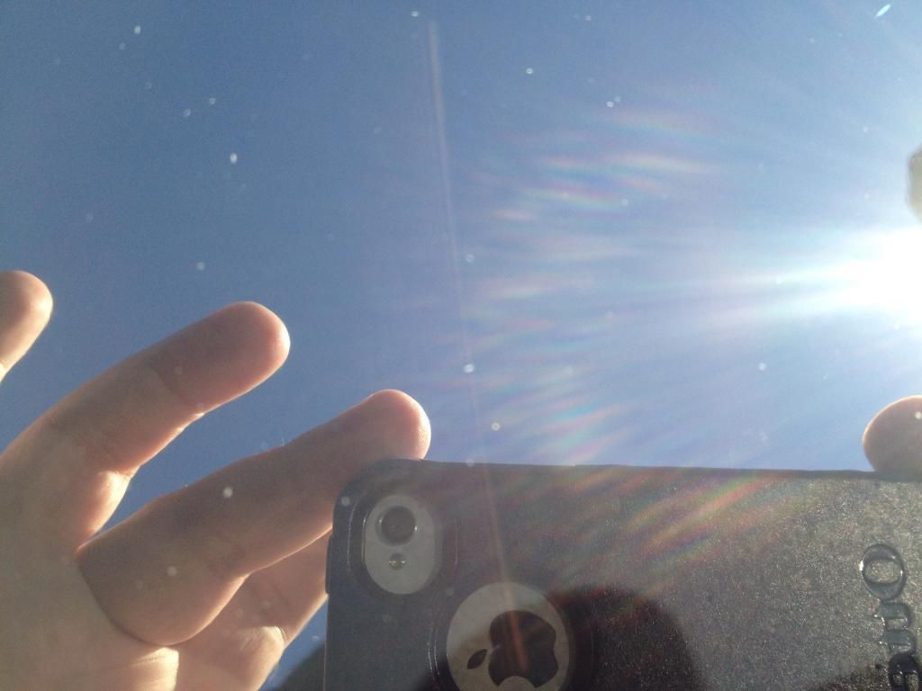

Friend and i polished truck with DA. Looks good was getting late polished hood walked away couldn't get any sealer or wax on it let it go for a few days.
Now it has these white dots in it looks terrible. cant polish or compound it out . looks like little tiny pieces of confetti
I took the truck to the body shop that painted my bumper. He said it was water spots and the hood needs repainted. Theres gotta be a way to get those out. I'm not a body guy but i don't see having to repaint the hood !

Ya that's better, as in we can see it now....But wow thats a tuff one. I'm not sure what to think. But like I said above; if it's truly water spots that are only a few days old they shoud be easily polished out or removed with Spotless. Has the Spotless arrived and been tried yet? In addition to Steve's thought of chemical contamination, another thought comes to mind and that is; I wonder if it could be some kind of solvent pop or other CC defect that was only revealed after polishing?
Its very possible they were always there then the polish brought them out. Yes they appeared after the fine pad black DA polish.

You can see where the washer fluid rolled down the hood and i guess burned into the clear coat. Its a perfect line right from the washer fluid nozzle
Now this is interesting...Thoughts?
