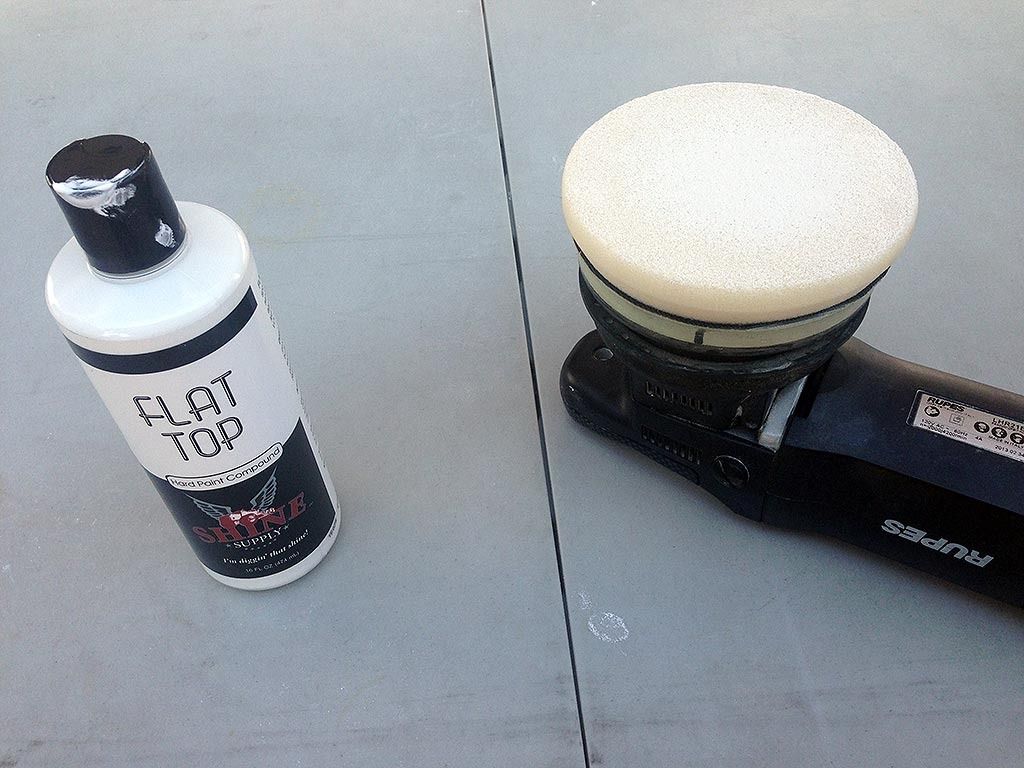

I am very impressed with Shine Supply Flat Top!
It's nice to work with, cuts great & finishes down nice.

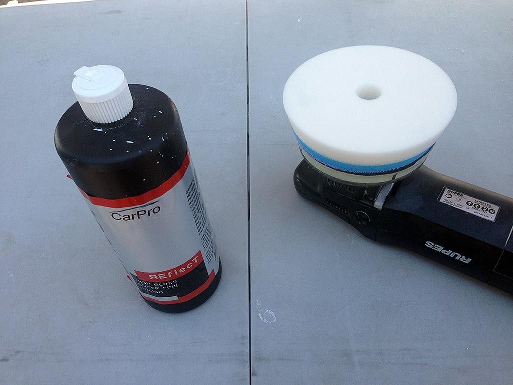

Mostly this is a 1st use review of Carpro Gloss Pad.
A+ I really enjoyed using these super soft foam pads.
They make the Rupes 21 even more of a joy to use.

Correction:
Carpro Flash Pad and Shine Supply Flat Top
I'm very impressed with this product/pad combo. A quick job of correction
Finishing:
Carpro Gloss Pads with Reflect
The Gloss pads are surprisingly soft and are an excellent combo choice for Reflect
Interesting enough the test vehicle is a 2008 Benz S36 AMG
This paint did NOT react well to any machine but the Rupes.
It laughed at the PE-14 Rotary and it hated the Flex 3401.
When I used the Rupes 21 the paint sang and it was happy.

During finishing I used the same Rupes machine to save time.
The Rupes, CP Gloss pads & Reflect polish did a great job!
