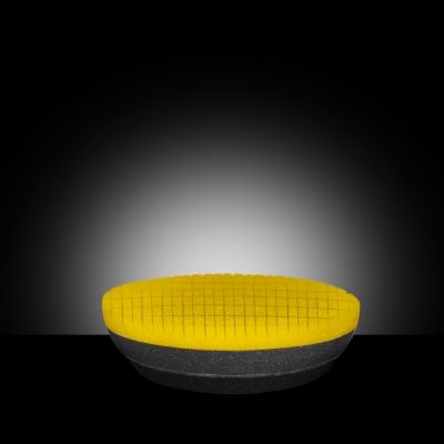

Well... ok we have been offering this incredible finishing pad for some time in 5 1/2" now but now available in 6 1/2" also ;) If your not familiar with the Scholl Concepts Honey Neo Spider pad ask someone to help you push that rock away and crawl out of there! There are some truly great products out there that don't have the marketing hoopla and nonsense from the market machines behind them for a variety of reasons, often having to do with either margins or politics or pricing, etc - sad but true! So, I thought as we add the 6 1/2" size to our store it should be my duty to share a little louder with each of you my favorite finishing pad on the market!
Scholl Concepts Honey Neo Spider Pad 5 1/2"
Scholl Concepts Honey Neo Spider Pad 6 1/2"
At $22 each, what are the unique properties if the pads?
Simply put, it provides the best finish I've seen consistently on any paint I've used it while still providing more cut than the traditional finishing pad. The spider cuts offer control of the abraded clear coat which doesn't allow it to jump around marring the paint. Due to the cost I haven't been more vocal about this pad in the past unless someone asks me what my favorite pad is and I'm realistic it's a high price to pay and not for everyone but for those looking for the best finishing pad on the market my belief is this is the one. More details on the product page.
Here's a question about them though are they designed specifically with two things in mind because looking at them to me they are. First one being SMAT polishes because of the grooves you probably wouldn't want a DAT polish to get large abrasives stuck in there and then come out towards the end of your cycle. Second being large throw machines, it seems like the Rupes pads or the LC HD pads in the lower profile beveled edge design (I may be way off on this one as I have no hands on with it).

Thats an interesting theory actually! My experience is no issue or factor on the type of abrasives though. Scholl Concepts developed these pads specifically with their line. They built there own pad factory a few years ago which is probably the most advanced in the world, developing and creating pads that others (in my opinion) are constantly looking at to try to follow. They spend a LOT of time on their pad developments and innovations. L2D has a great interview with Scholl Concepts posted which I think touches on this. http://www.live2detail.com/content.php?126-L2D-Interview-Scholl-Concepts
I mention all that because their abrasives are ipt (much more similar to dat than to smat) Also touched on in the interview as I recall.

I just got the pads I ordered today :D question where did the image you posted of them come from? My pads look absolutely nothing like the one in the pic. I'm not complaining, just curious. When I opened I boxed I thought maybe I'd been shipped the wrong ones at 1st lol.
Could you please post a picture of the pads you received? And I will help you to verify them.
Hey bud! I'm VERY sorry for that - an image update oversight on my part. It should have been corrected months ago and we blew it. You have the newer updated pads if the foam is Honey color all the way to the base and there is a hole in the middle to relieve heat.
