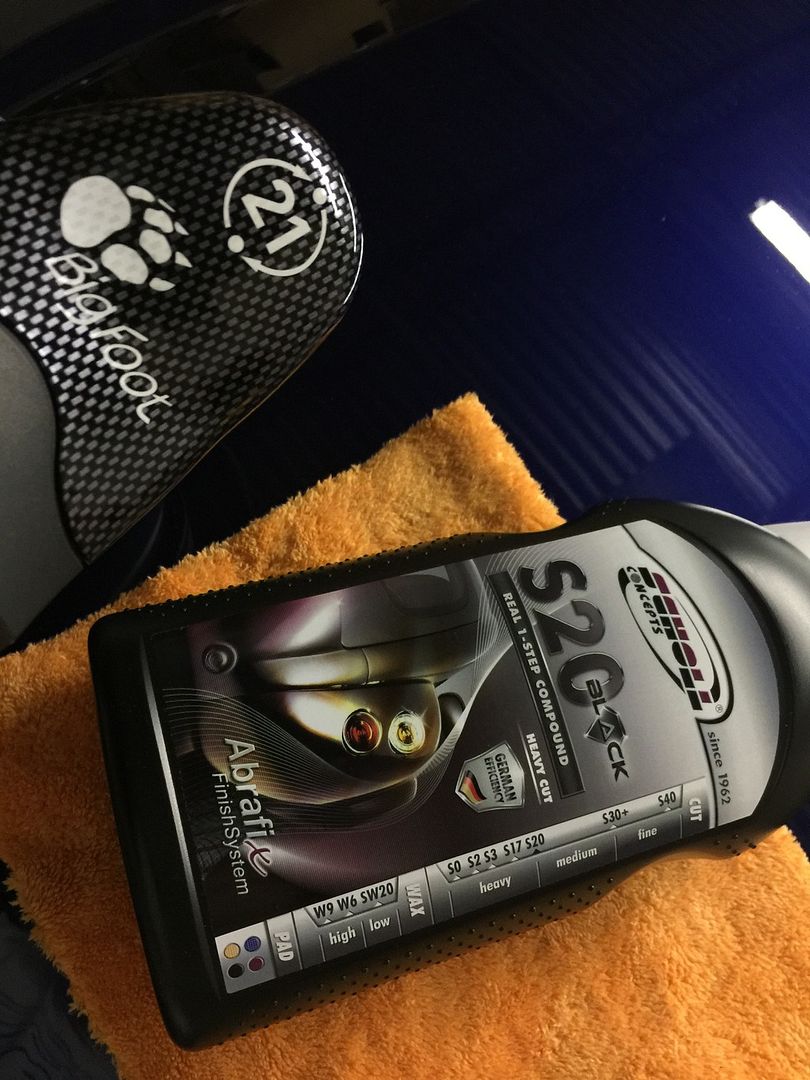

Scholl Concepts S20 BLACK

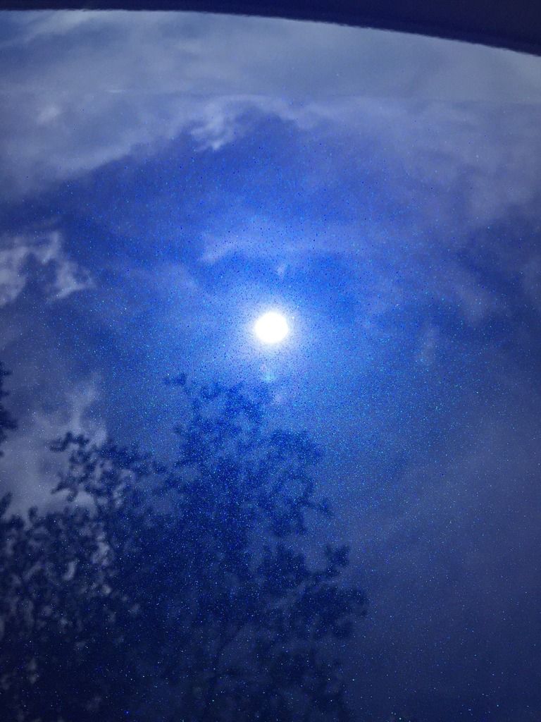

After thorough testing of the new Scholl Concepts S20 Black I am confident in recommending this incredible compound to anyone reading this! First lets back up a bit to how S20 Black came to be. For over 2 years the worldwide leader in quality compounds has been hard at work on what would become "S20 Black". When it first started in the lab the goal was to create a one step compound that cut well and still finished down beautifully on soft paints.
As the project continued Scholl Concepts turned over a few new tricks with their latest developments in iPT diminishing abrasive technology. By the time the dust had settled (no pun intended) last month they indeed completed what I believe to be one of the best compounds I've used.
This revolutionary compound truly delivers on the promise Scholl Concepts has been verbalizing since we first heard rumors of S20 Black. Very good cut, very high gloss, zero dust in my tests using a variety of Scholl Concepts spider pads, and no haze on soft paints!
Read more here - Scholl Concepts S20 BLACK
Is this designed for the spider pads and a rupes?
Yes [emoji3] BUT should work pretty well on a variety of pads. I tried with CarPro flash pads yesterday and results were ridiculous as well. With the spider pads it's zero dust every time I've used it and great results as well.
how - where does this fit in with s3 gold xxl ?
S3 Gold xxl is a heavier cut. S20 Black is less dust and higher gloss especially on soft paint.
I would liken the S20 Black to a bit more cut than S17 and a better finish as well.
For hard or more damaged paint S3Xxl or Shine Supply Flat Top would be my definite go to while on less damage or softer paint Flat Top or the S20 Black will be the ticket.
The scholls works great with the rupes blue microfiber pads and the new car pro microfiber pads. I've used it with the rupes 21 mark II and the Duetto, both gave me great work time and great results. Even tho it says to not use in direct sunlight, i like to break the rules and tested it. I got just as good results but obviously had shorter work time. Overall, you will not regret buying this compound
