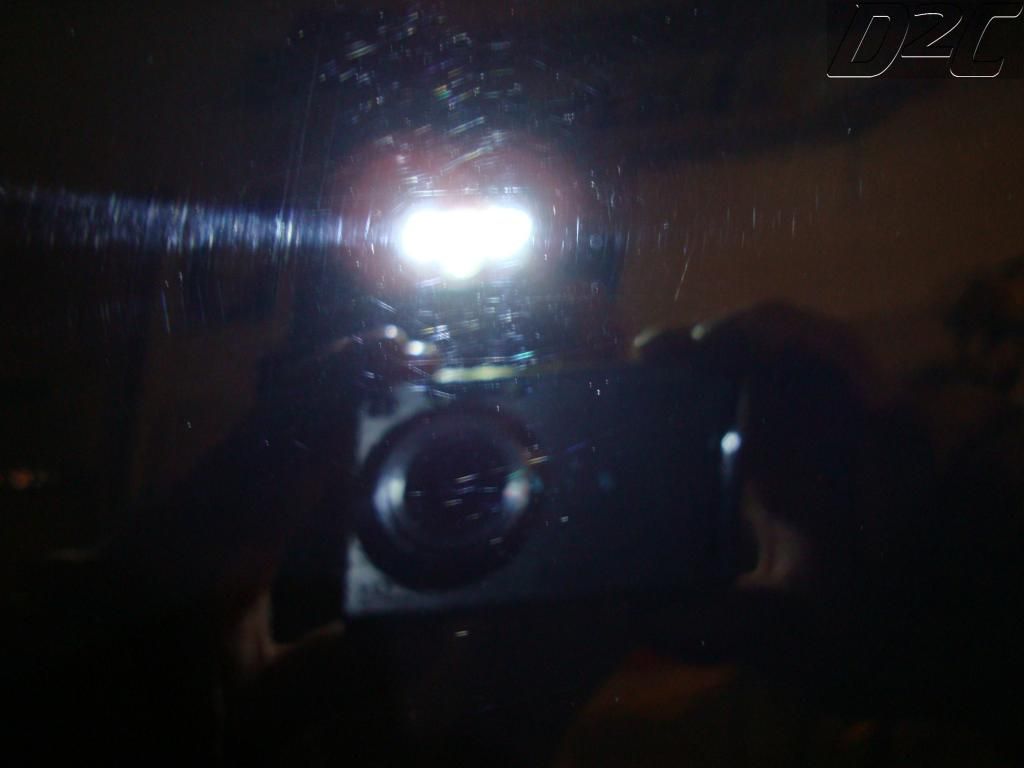

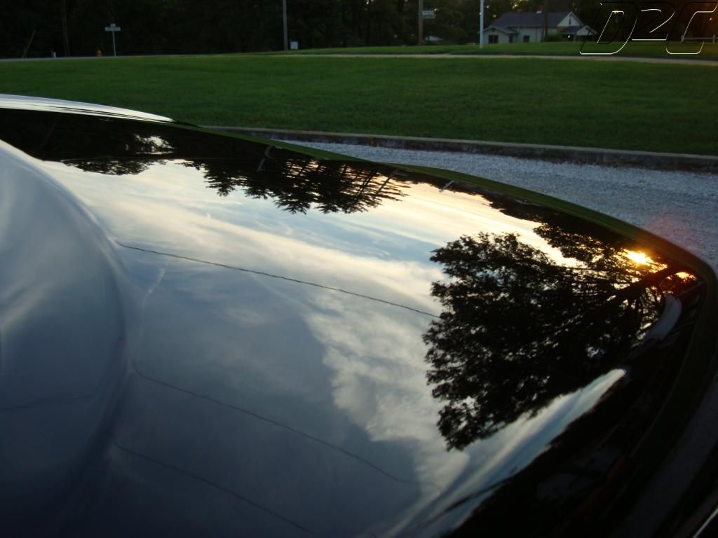

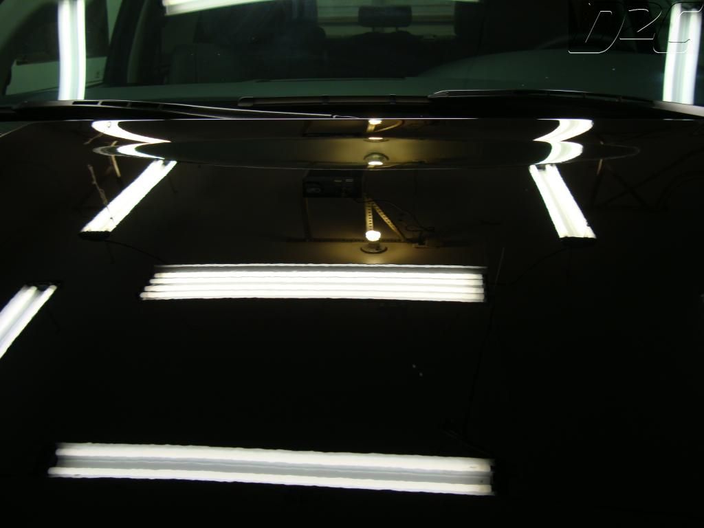

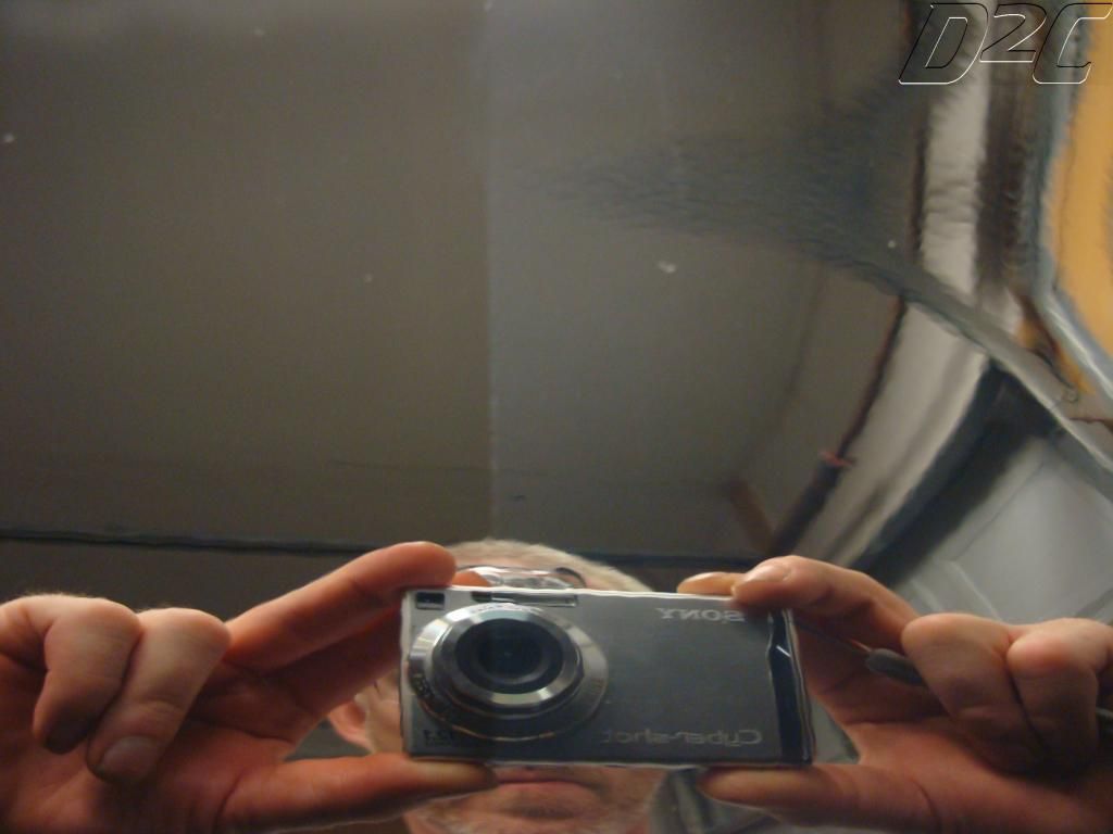

I will say using it on the Rupes 21 compared to the PC is a huge difference. The extra stroke of the Rupes enables Reflect to do things a super fine finishing polish shouldn't be able to do. When using it on the PC I still get the same amount of gloss as I do w/ the Rupes 21 but I don't get the defect removal.
The lighting isn't the best but you can still see the defects
After one step w/ Reflect

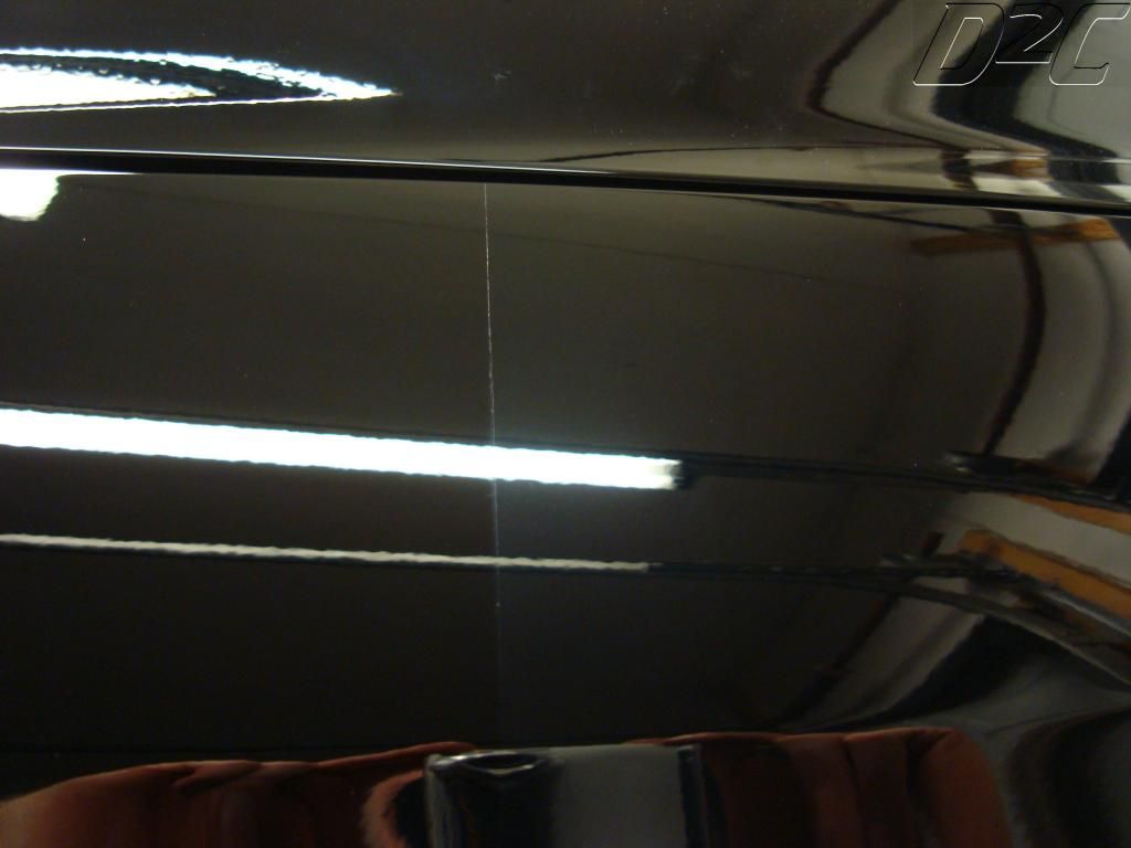

Here's a 50/50 pic. The right side is marring left behind from M105/D300 50/50 mix on a Meg's MF cutting pad on the PC. The right is after using Reflect on a Buff & Shine black pad on the Rupes 21.
Same shot, different lighting

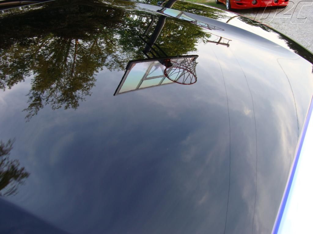

Inside shots under flourscent lighting
Outside

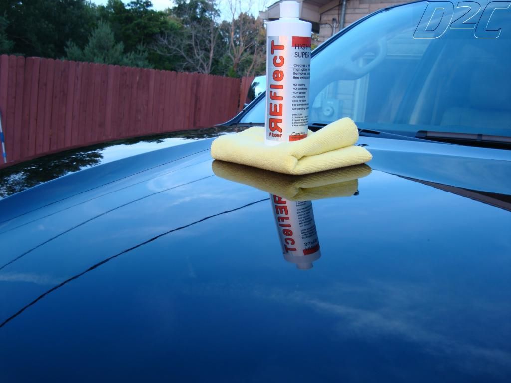

IMO and I know Corey shares the same opinion on this, Reflect is one of the most under rated polishes out there. I'm doing my part to change that. :)

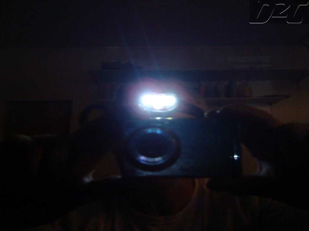

I'm still trying to get the technique down for Reflect myself. After getting some more tips from Corey and a few others here, I hope to have the same results. Those reflection shots are bad ass! Thanks for sharing...
JH... Awesome review and pics bro!! I LOVE the ones you did that show the difference with out any lighting needed. Just a deep dark wet (by 10 shades) difference. Awesome bro!! Thank you for posting a fun read and great job on the review!

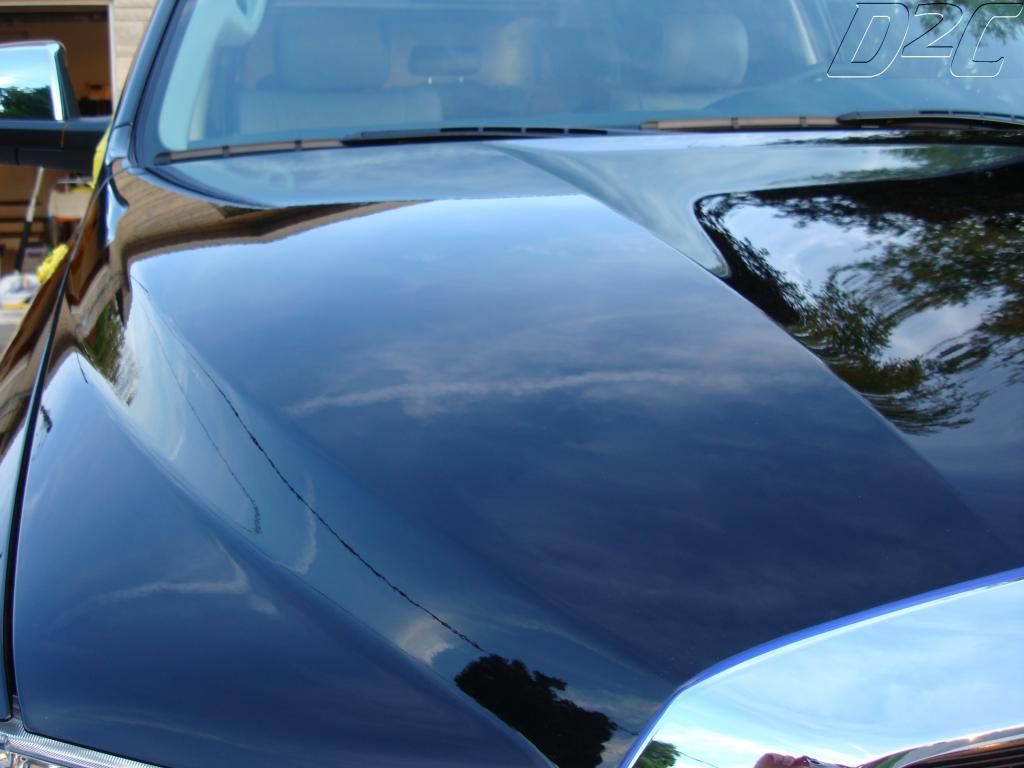

Reflect polish is absolutely amazing. I have had some amazing results with it and yet to have a customer complain about the work.
Here are a couple shots.
