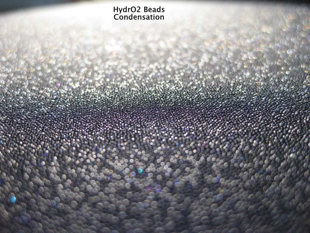

The next morning I got my first look at the natural condensation beads, which I find always tells differences in protective products… More on that later.

The following morning I was very excited to see the difference condensation would yield between HydrO2 and Permanon Platinum.
And a couple beading shots of the SL
