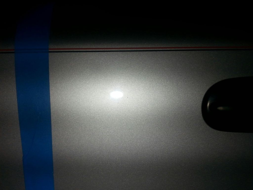

S20 Black was then applied onto paint using a speed of "3" then speed was increased to "5" using moderate pressure and a slightly higher arm speed above slow. 4 passes were made then my arm pressure was lessened and arm speed slightly increased. I worked the product in to the point of needing to remove it with a "Yellow Fellow" M.F. towel. Finished results below...
[/URL][/IMG]
This area had hairline scratches but I apologize since the initial photos did not capture them.

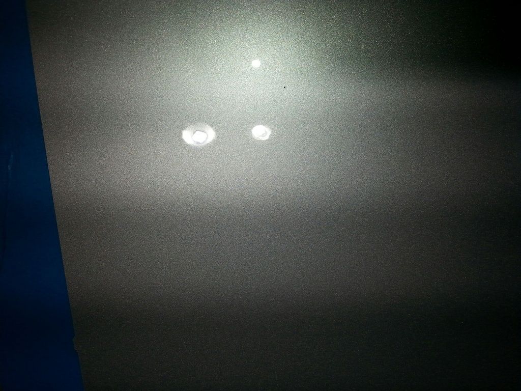

Here are some more photos...
Left side before...
[/URL][/IMG]
Left side during correction with L.C. HD Blue Cut pad...
[/URL][/IMG]
After removal of product with Yellow Fellow M.F...
[/URL][/IMG]
Right side correction completed with L.C. HD Orange Polish pad.
Before...
[/URL][/IMG]
During process...
[/URL][/IMG]
After process...
[/URL][/IMG]
So, in conclusion, the Scholl Concepts S20 Black is a Winner! I did not have any Dusting, in my case with the CR-V, it did finish in "One-Step", and was very easy to work with. I'm just a hobbyist so I bet the Pro's will have even better results!
