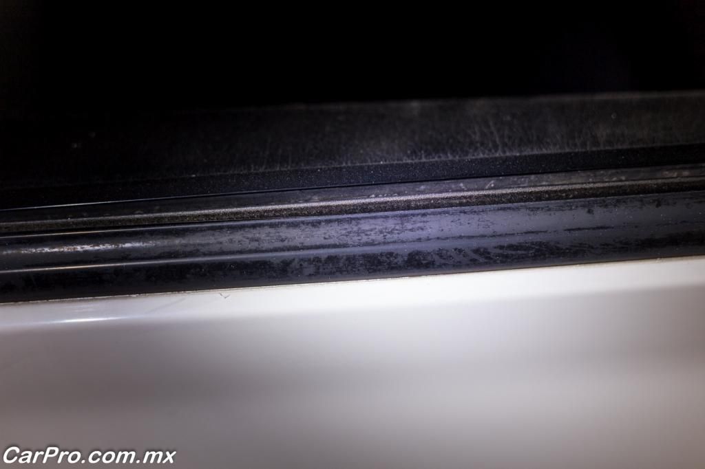

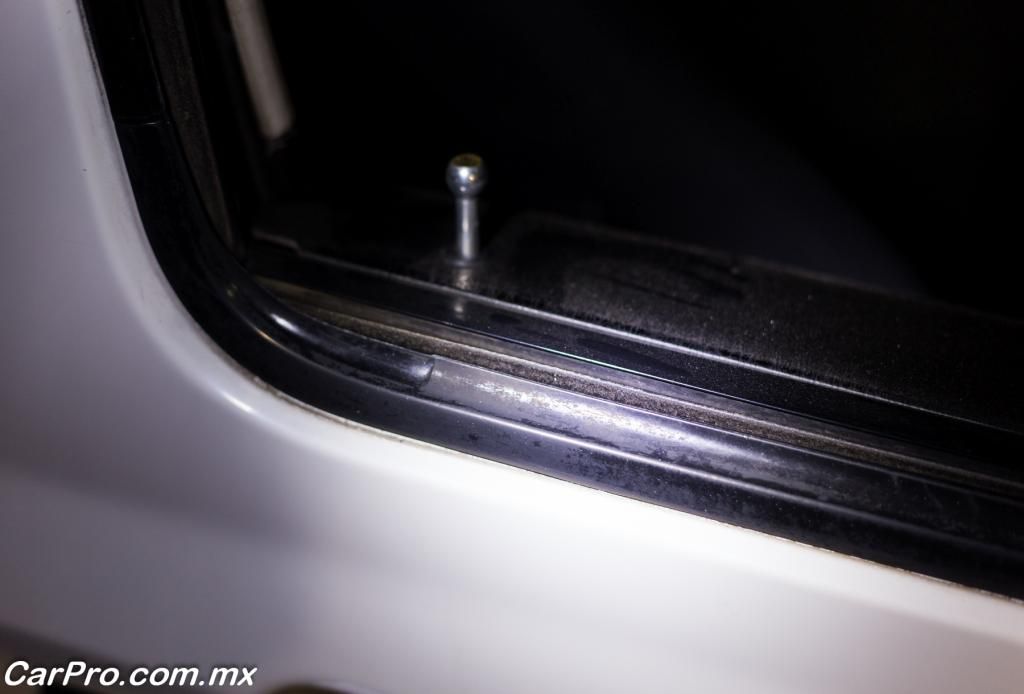

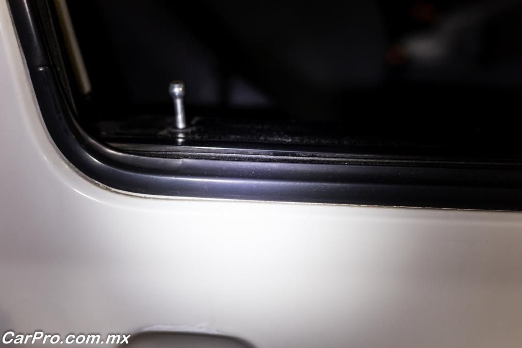

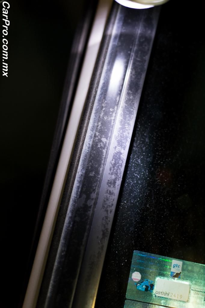

Before (door seals/gasket):
After:

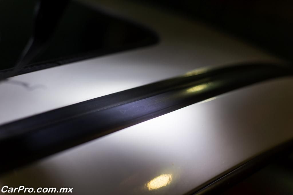

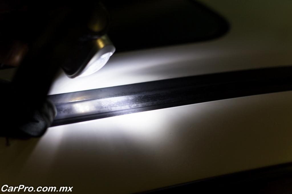

Before: (rain gutters)
After:
Sorry for lack of proper light on the pictures. Light was scarse as i was finishing working.
