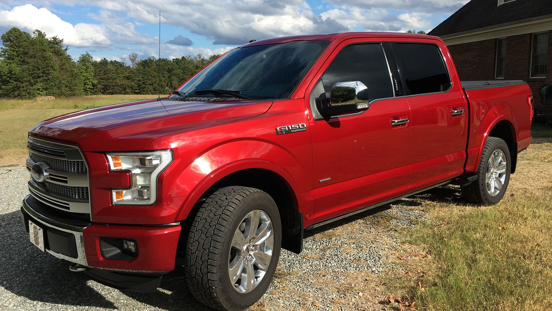

Finally got a weekend to get this done..... wife was away on a "girl's weekend" so I spent a good chuck of Saturday and Sunday going through the motions.
I had previously washed, IronX'ed & clayed the truck - with very little color coming out and little dirt on the clay- the truck was surprisingly clean and in good shape compared to other vehicle's I've taken delivery of. Much of the delay getting this done was related to getting the PPF installed - and then installed due to some issues with the material - and it looks like its' going back to have at least the hood redone again :mad: - but it was time to get this done.
Saturday I started around 9 or so I think - washed, dried, clayed - found that the roof of the cab was pretty dirty - guess that had not gotten attention at the dealership or elsewhere :), used my PC7424XP and Meguires Micro-fiber pads & the polish for the pads - the paint was pretty much swirl free so I didn't anything too aggressive here. When that was done I removed any polish remains with CarPro Eraser and called it a Saturday - off to dinner with the kids.

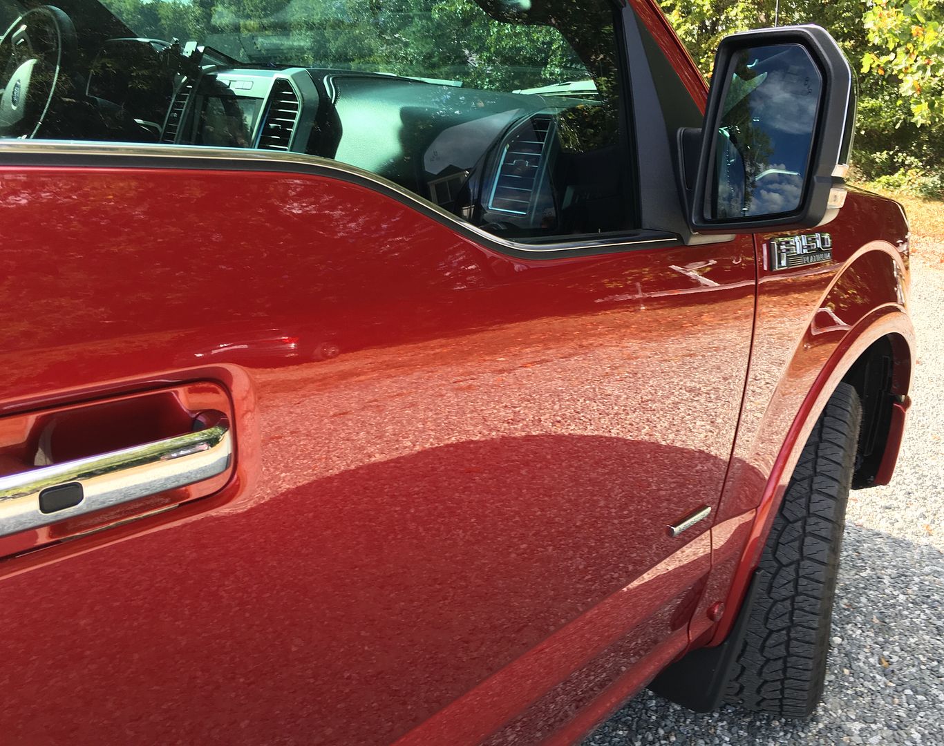

I was up early on Sunday ready to get started until I saw the fog - was doing most of this in the garage but was worried about the humidity in the air from it so I did not get started until 10:30 or later. Two coats of CQuartz ceramic paint protection coating and then a coating of Reload. I used a FULL 50 ml bottom on the truck - I had ordered a 2nd bottle "just in case" but did not open it - just wrung the last bit out of the applicator as I got to the last panel ;) I'l save the other bottle for my wife's Surburban or my daughter's Civic. Hi the plastic & chrome with DLux.
Ran out of steam to pull the wheels in order to clean and polish those - so they will have to wait for another weekend. But I did get her out into the sun for a quick photo-shoot....

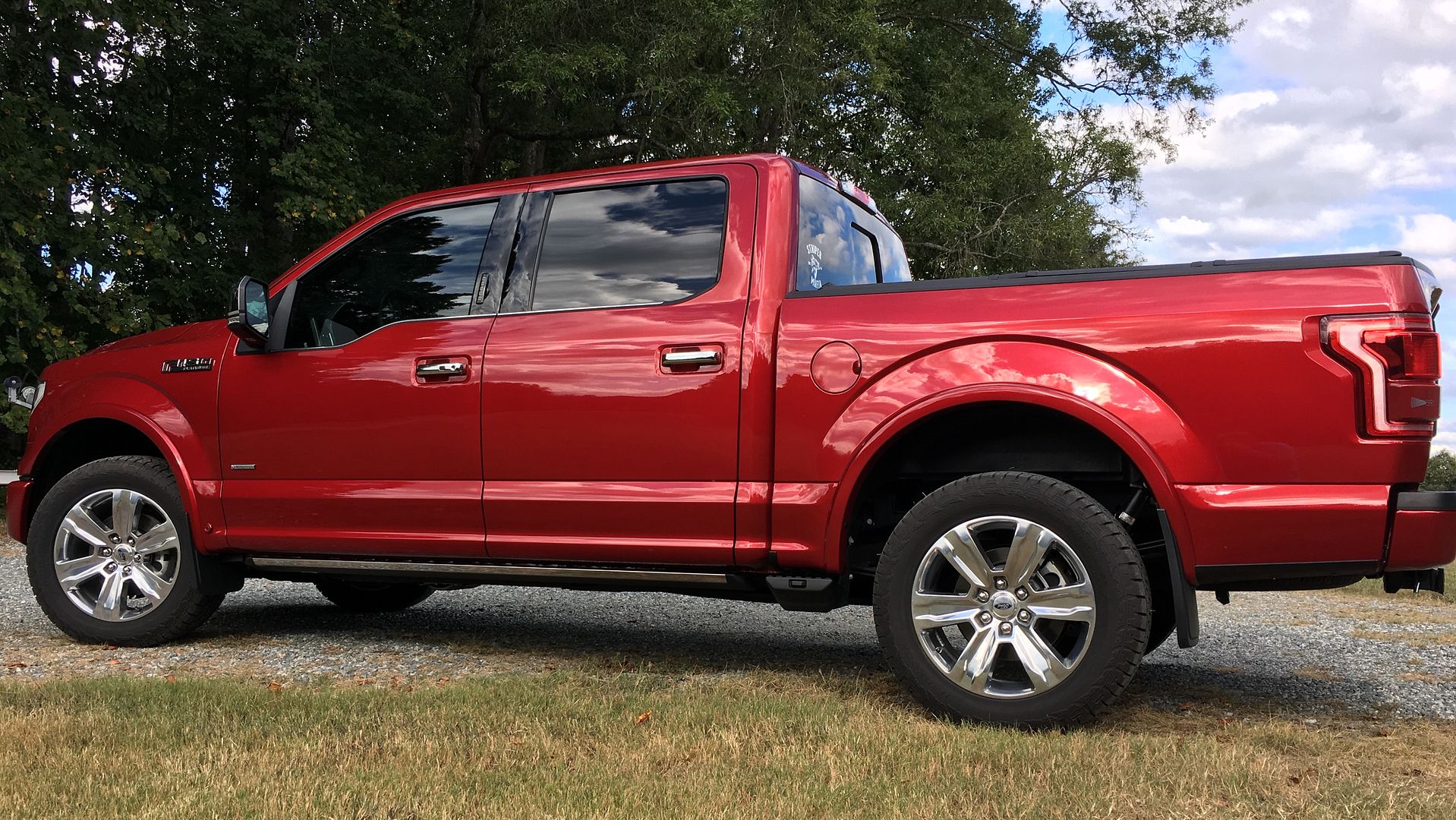

and then on the gravel driveway....

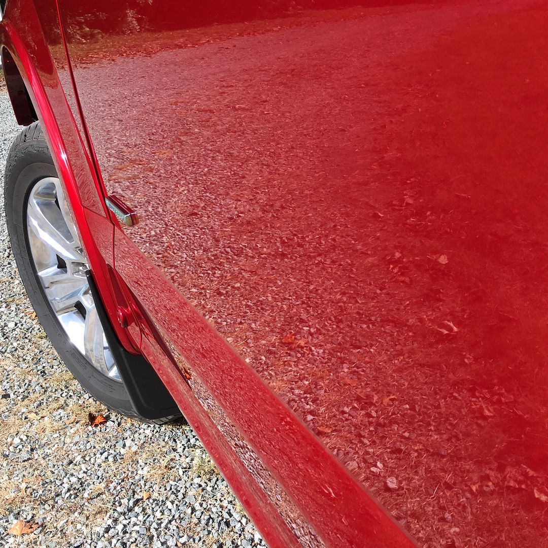

Glamor Shots! :D
Finally - the gravel driveway in the upper left is my nemesis with respect to keeping our vehicles clean - especially their tails....
